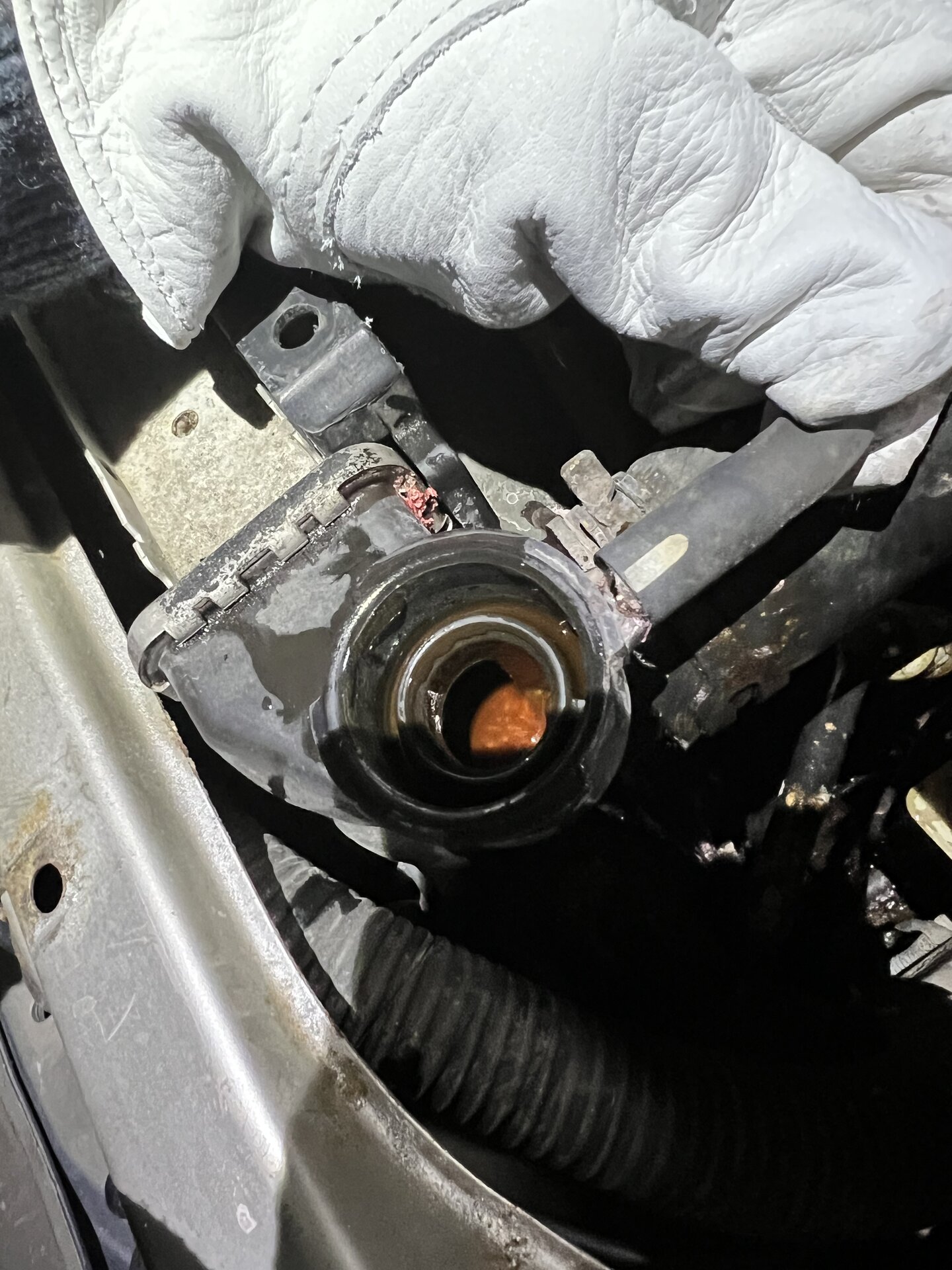

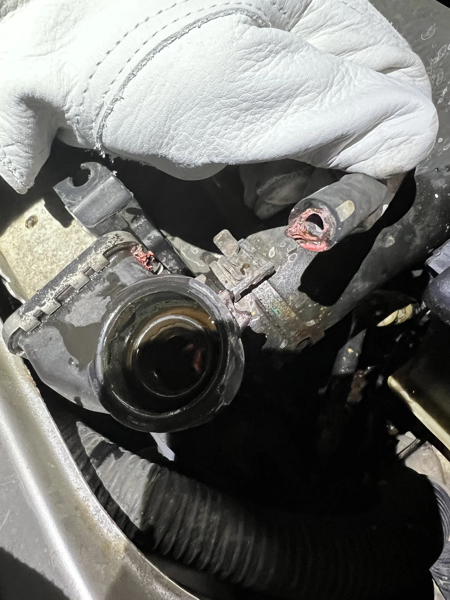

You are a life saver! I checked the overflow and it looked ok. I bought some coolant and to my surprise the radiator took more than 3/4 of the container. I then looked under the car and realized that there was some leaking near the radiator cap. I looked around and it looks like I have a nipple problem…lol the radiator overflow hose nipple broke and the coolant was leaking. I will need to go buy the parts to fix this as I don’t plan on changing the radiator until the summer.
