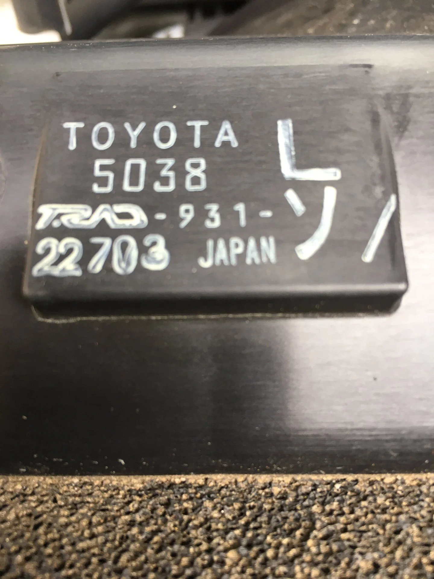

That is very similar to the way mine looks. I'll have the dealer go ahead and replace. They owe me one anyway because they damaged the inner fins when they were doing a different repair. :rolleyes:

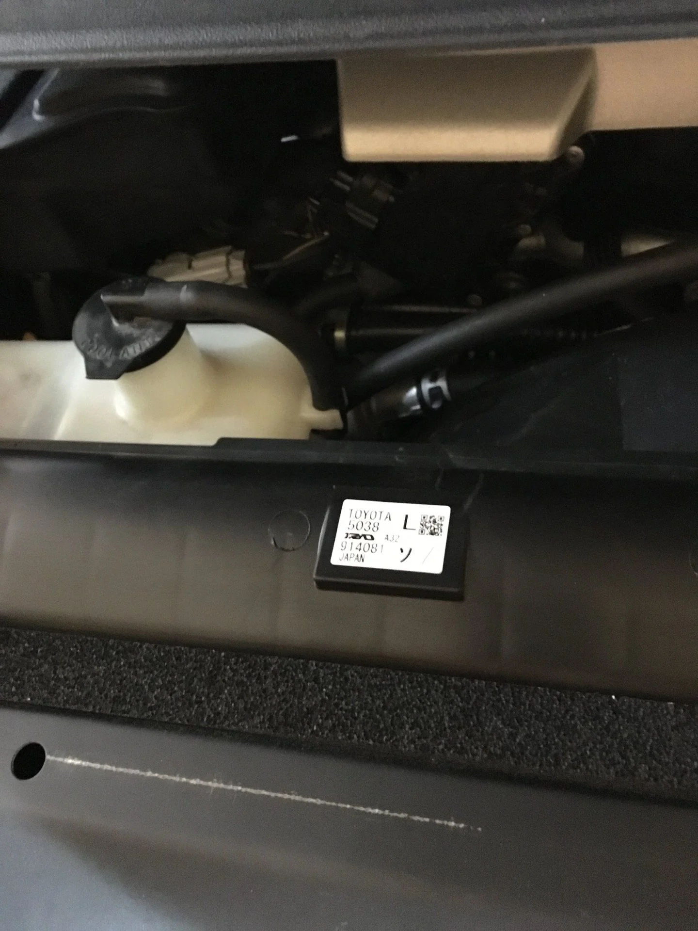

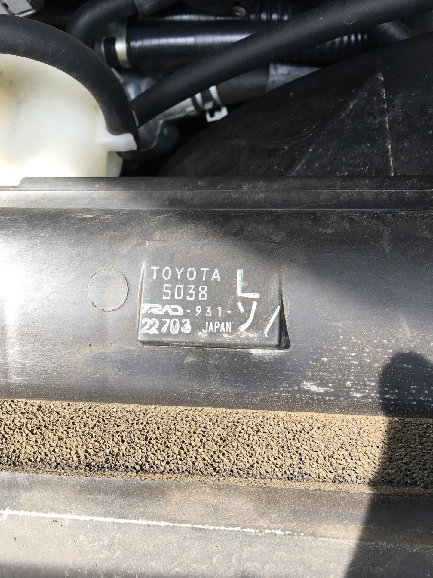

Here's mine. One thing I now notice is that it doesn't have the vendor markings. I know that it hasn't been changed...🤔

Someone else can chime in, but pretty sure yours has been replaced at some point in time. Seems like every OEM radiator is stamped on that raised portion, aftermarket examples are not. But guessing you've owned since new?
It has 43k miles on it. We purchased at 23k miles. When I purchased, I verified the service history with the dealership that it was originally purchased from and had all of its service done at. It has no prior accident history and did not have any sign of any repairs made when I bought it 2 years ago (except for the radiator apparently, ha!). Strange.

My new Denso radiator does not have a stamp here but it was identical to the OEM radiator that it replaced.
My replaced radiator has the stamps. Mine was replaced this past summer. I would guess yours is denso

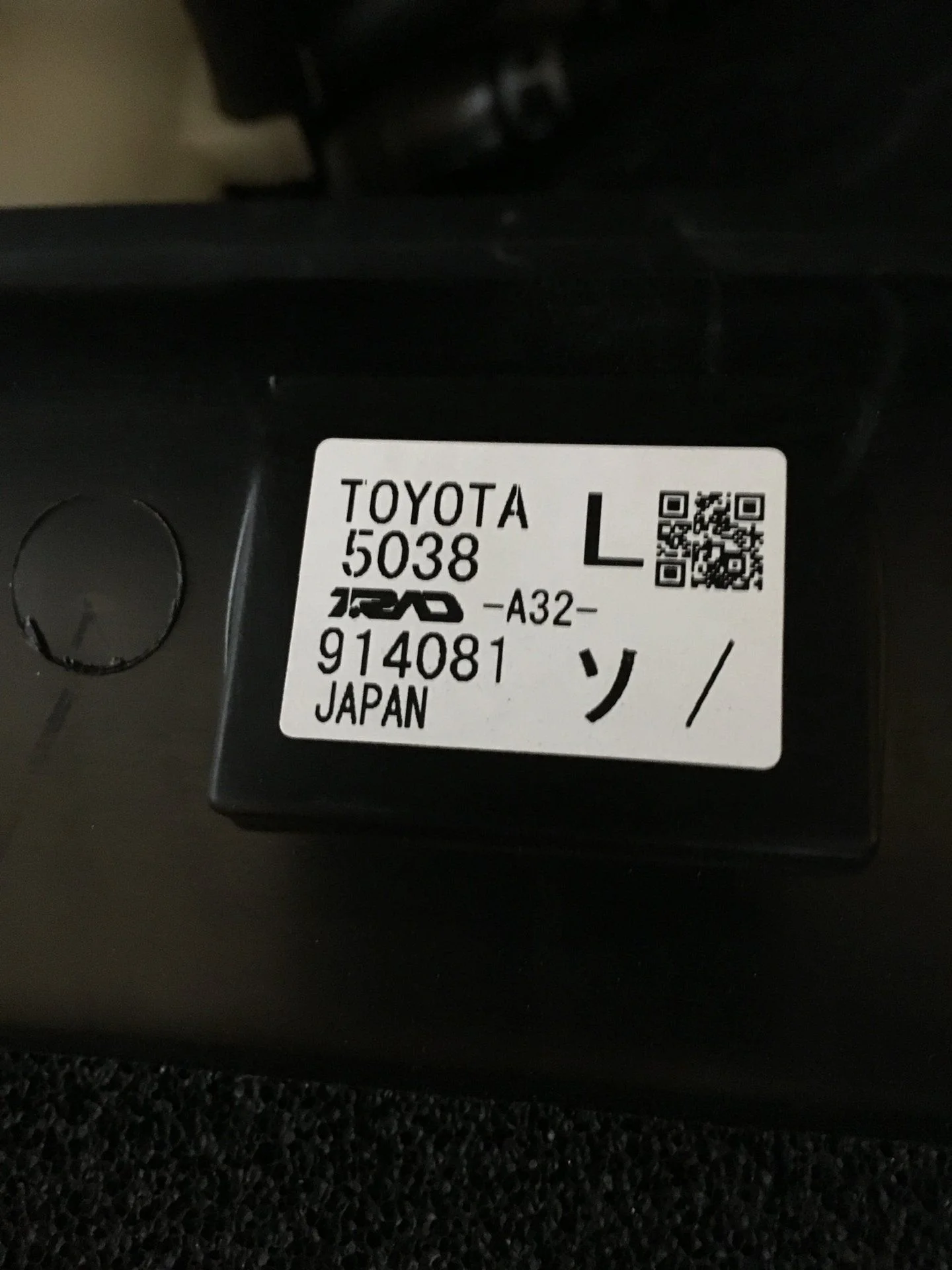

Mine is the same because I chose not to use the Toyota part. I went with a koyorad part (which is what Toyota uses for their radiators).
Toyota uses “TRAD” on these. The logo is clearly visible on the sticker or stamp.

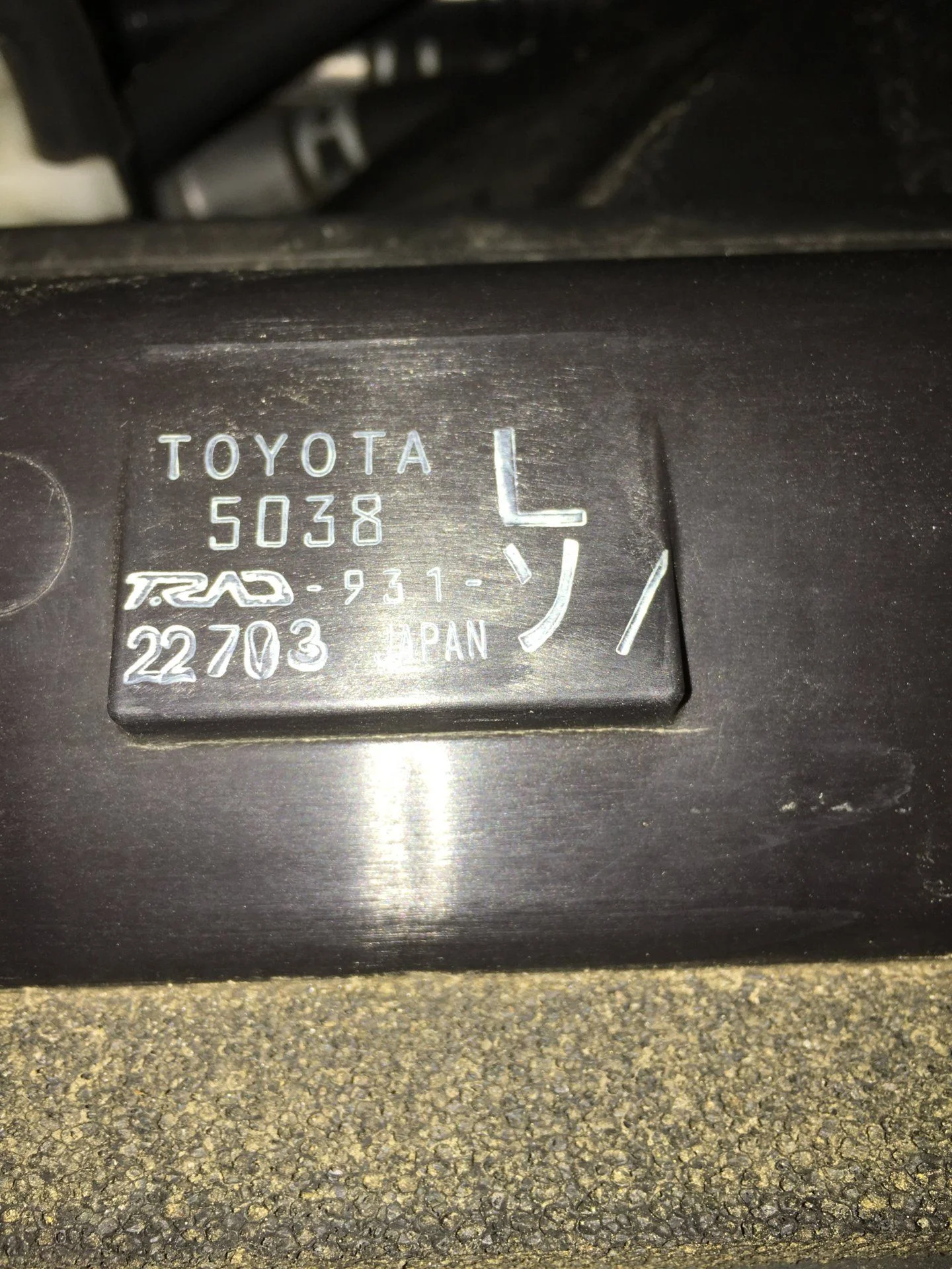

Ours looks exactly like this. We are 2nd owners, (bought at 75k) I need to look through the service records again. Let me look really quickly to see if it says anything about the radiator. Nothing about the radiator, but water pump, thermostat + gasket 11/28/2015...
