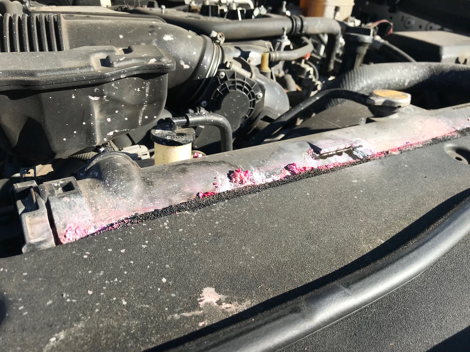

2008 with 145k. My wife took it in town and I noticed pink fluid on garage floor. Will be trying to get the new version of the radiator installed along with water pump and belt/tensioner/pulley. Thankful this happened close to home . Been watching this thread for the last few years - thanks everyone for posting.
2008 with 145k. My wife took it in town and I noticed pink fluid on garage floor. Will be trying to get the new version of the radiator installed along with water pump and belt/tensioner/pulley. Thankful this happened close to home . Been watching this thread for the last few years - thanks everyone for posting. View attachment 1835007
Did the radiator crack or is it just the cap?
The splash pattern looks like its coming from the cap but the cap is on tight and I see a horizontal crack along the bottom of the raised part# area (not as obvious as others I've seen though). When I push on the area around the crack, the crack definitely moves some. If the cap was on tight, anything else I should check? Fwiw, fluid reservoir was empty.
