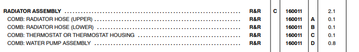

$700 in labor seems high. The book rate on my 2013 is 2.1 hours for the radiator, 0.1 hours for each of the hoses, and 0.8 hours for the water pump. Radiator + labor @ $700 wouldn't be unreasonable.
IMO the radiator and labor should about $600. Another $250-300 to also do the water pump. I don't know the mileage on your 2009 but if they are in there I'd do both since the water pump is known to fail in the 100-150k range, along with the hoses (which are cheap).

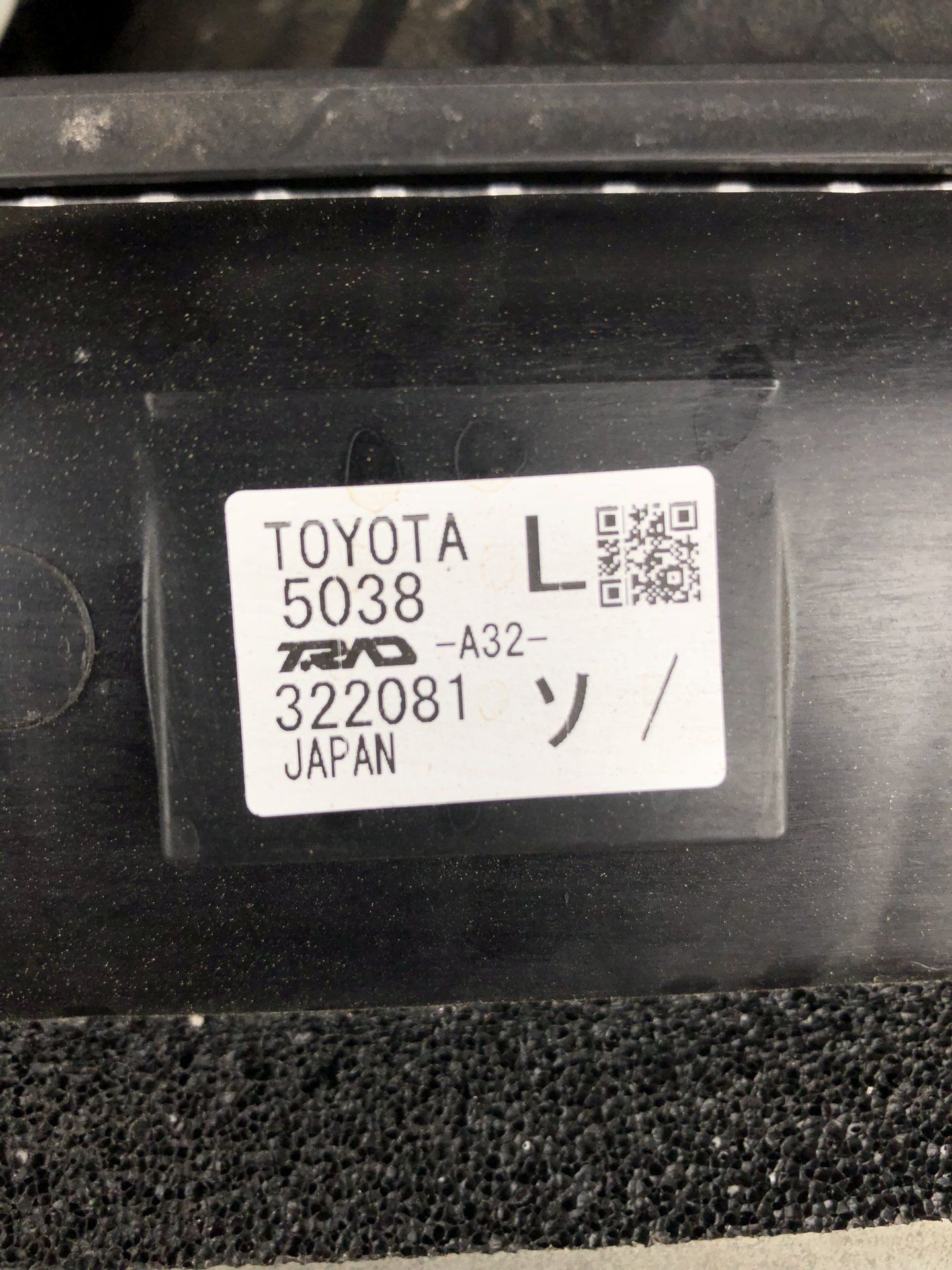

If those revisions mean that this particular failure mechanism has been mitigated via corrective action, then the Toyota dealer/system should recommend you replace your radiator with the superseded 16400-50384 PN.
So I just called the local Toyota Parts dept and asked what radiator they recommend for my MY2008 URJ200, after using my VIN, they said "$710, oh no, wait a second, there is a superseding PN, 16400-50384, $497".
Without actually taking this new revision radiator apart one can't tell what the design change is (but that's not quite right because the engineered change could be something that is overlooked/oblivious to the human eye like pressure compensation, etc), but it LOOKS like that Toyota is directing older MY URJ200s be replaced by the newer PN radiators. And another way of proving that the mitigation was a fail, is if someone reports that the 16400-50384 has failed in the same manner, with the same failure mechanism.

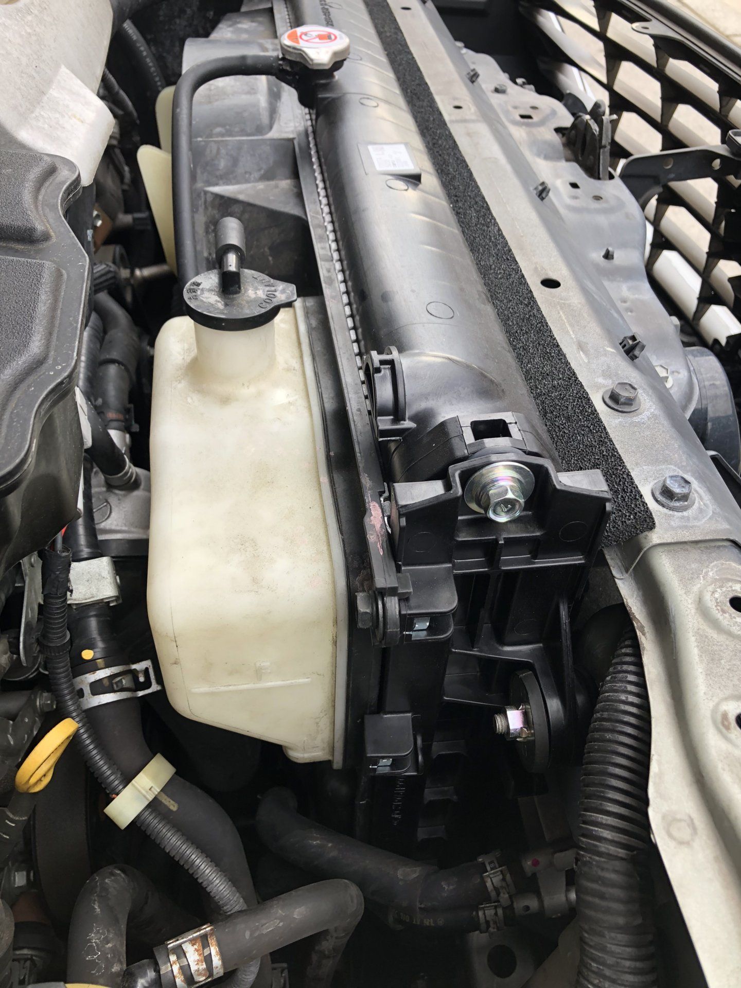

Got any photos of the Denso post install?
It was a bit low, topped it off right after the picture. Probably a little air was in system after the replacement.
When it’s cool take off the radiator cap and make sure the radiator is completely full, If not top it off set the radiator overflow at the right level and then I check mine every time I get gas and check the oil. I wants had a Lexus dealer forget the put Oil in my wife’s ES300 at 90k mile service I pretty fubr the engine so you really got to follow up on these guys there is no pride in workmanship anymore

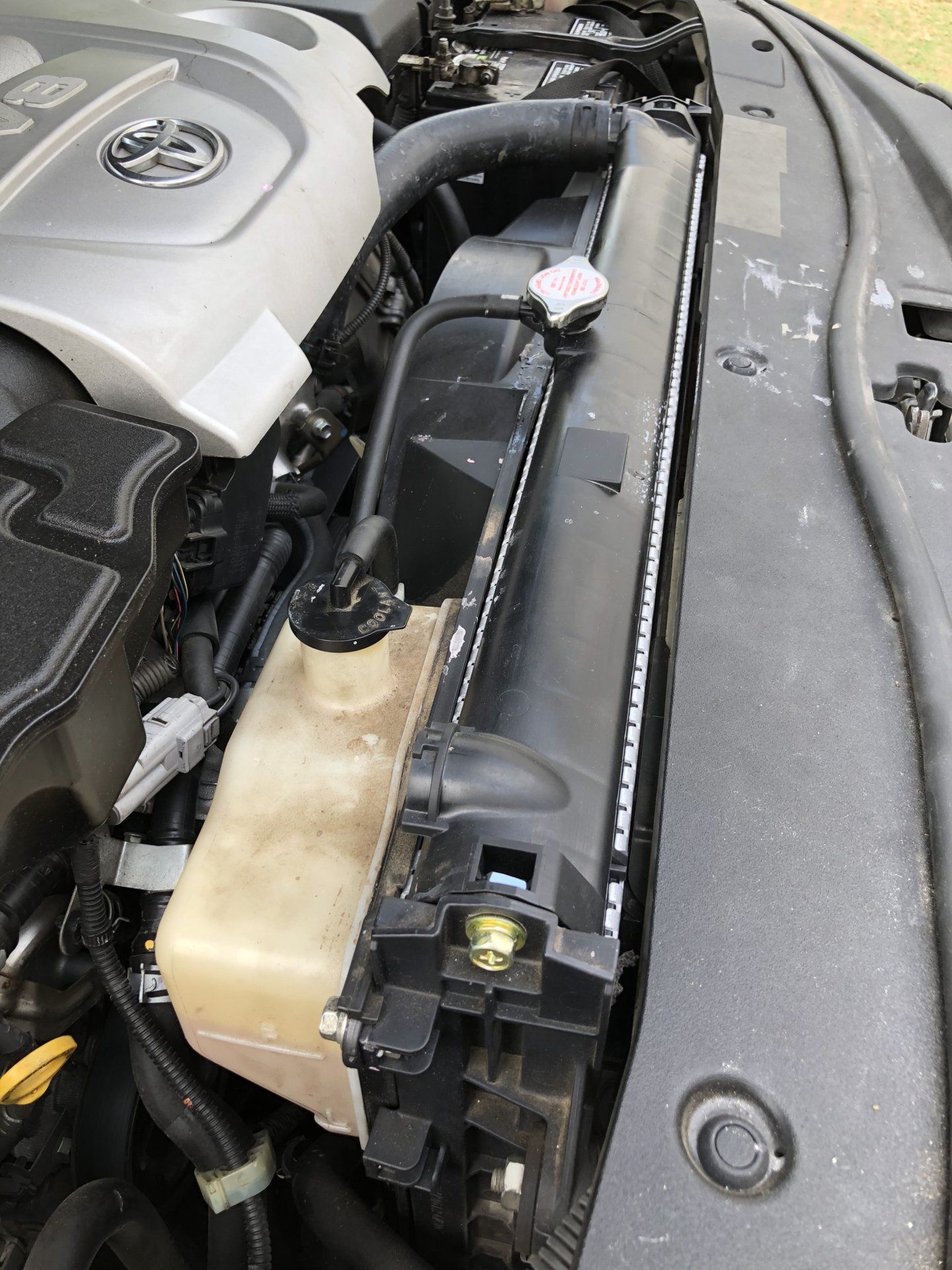

My 200's radiator has looked like the previous picture with the forming crack, for about 18 months with no change. Lasted fine throughout multiple Moab trips and Baja. Not even sure it's actually a crack we're seeing. Either way, I have some of the radiator sealant the guy posted previously. I plan on slathering on that junk before Moab just a precaution. I'll order up a radiator since I want to swap out my tensioner (as preventive maint) anyways.
Thought I'd weigh in with what I've got. I'm new to this forum even though we've had our 200 since we bought it new in March of 2012. 2011 LX with 113k miles. Checked the radiator this morning and saw the telltale hairline crack. I'm going to do the epoxy/fiberglass patch that I saw earlier on here, and if the thing cracks (and if we decide to keep the car as its fate is an open question) I'll see about ponying up for a custom all-aluminum radiator. I used to have a 60 series and even though it had nothing but problems, the radiator was never an issue.
