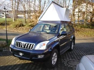

  • Trail Tailor- CAMP TOPPER (yes we are cutting the roof out of this)

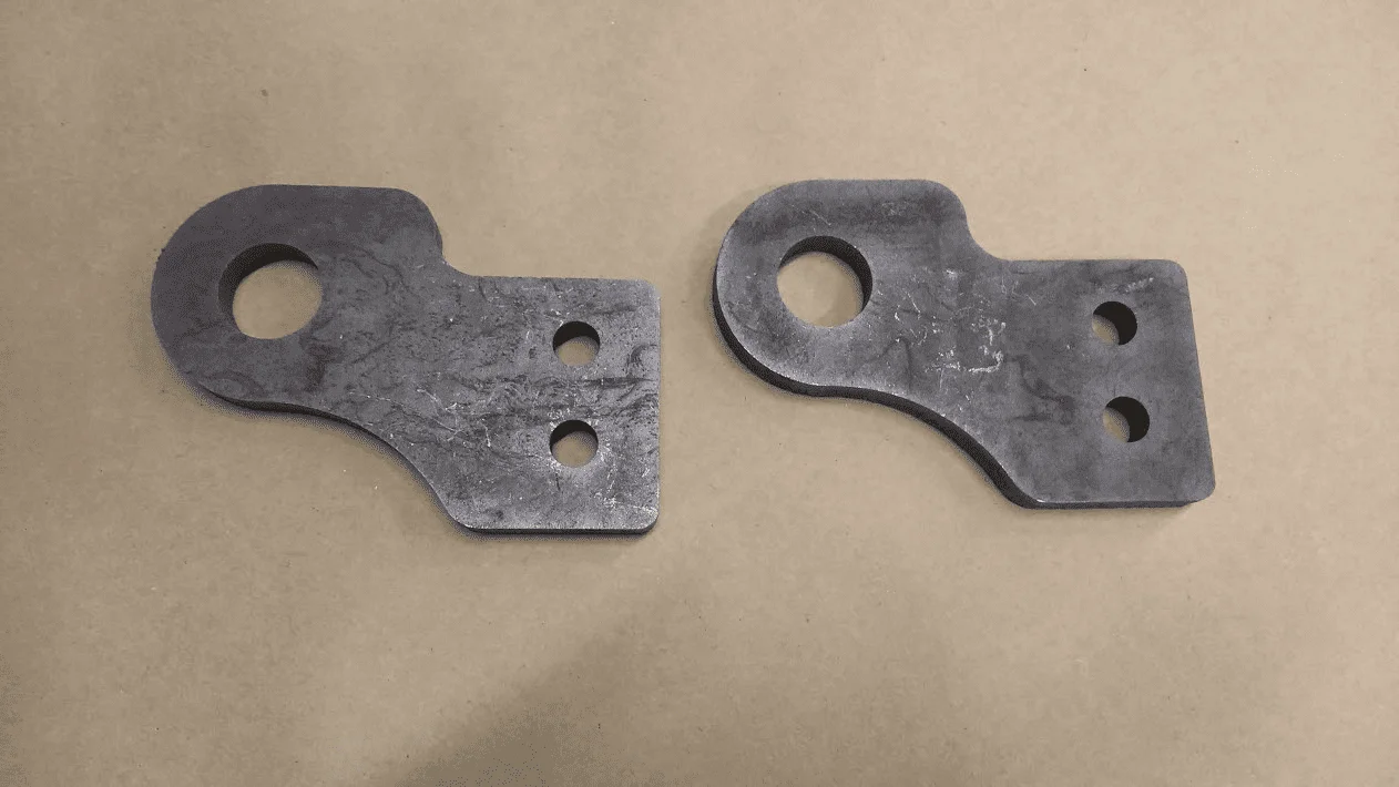

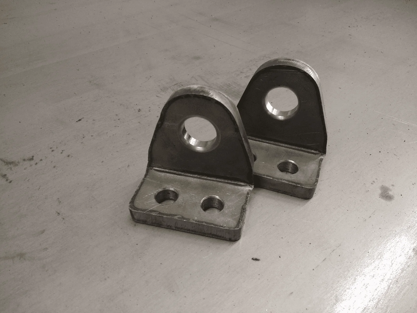

Are those rear tow points mounting on the bottom of the rear frame rails, or on the rear crossbar/crossmember?
Any pictures of them mounted?

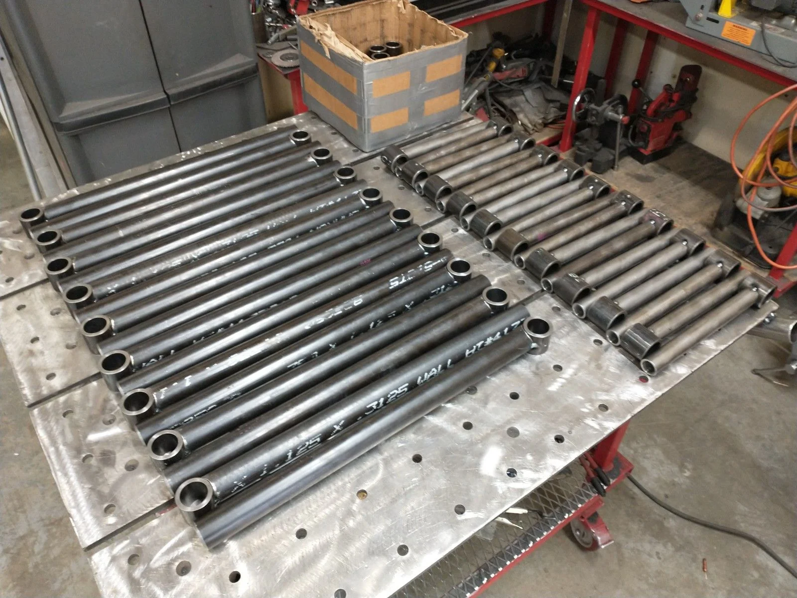

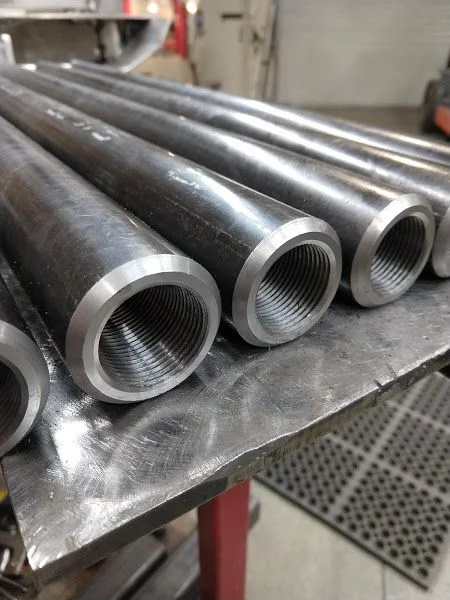

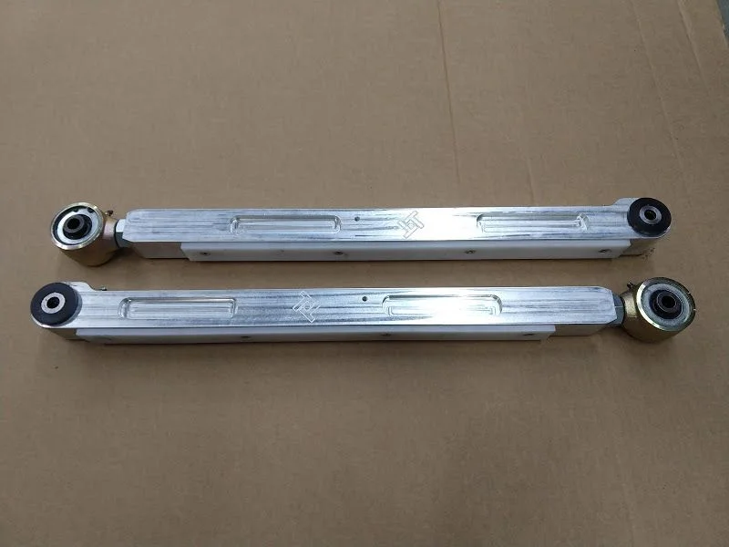

A couple of new products coming to market soon. 7075 Billet aluminum rear lower arms, adjustable .313" wall DOM rear lower, adjustable rear upper arms and a tire carrier for the back door with adjustable depth as a standard option to cover all wheel and tire combos. All CNC lathe and milled.
