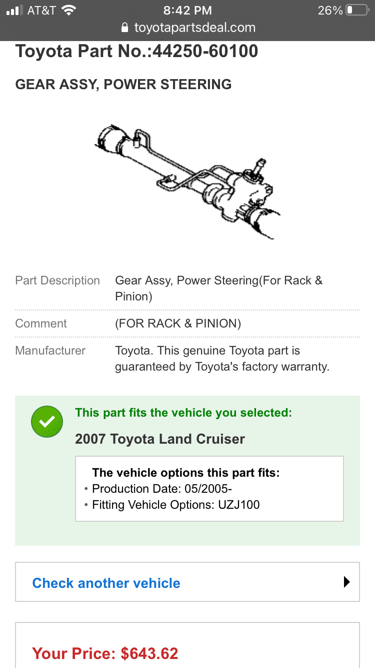

44250-60100 is the correct part (Toyota, not Lexus, the latter of which you should avoid when buying parts). Both part numbers you provided are discontinued...

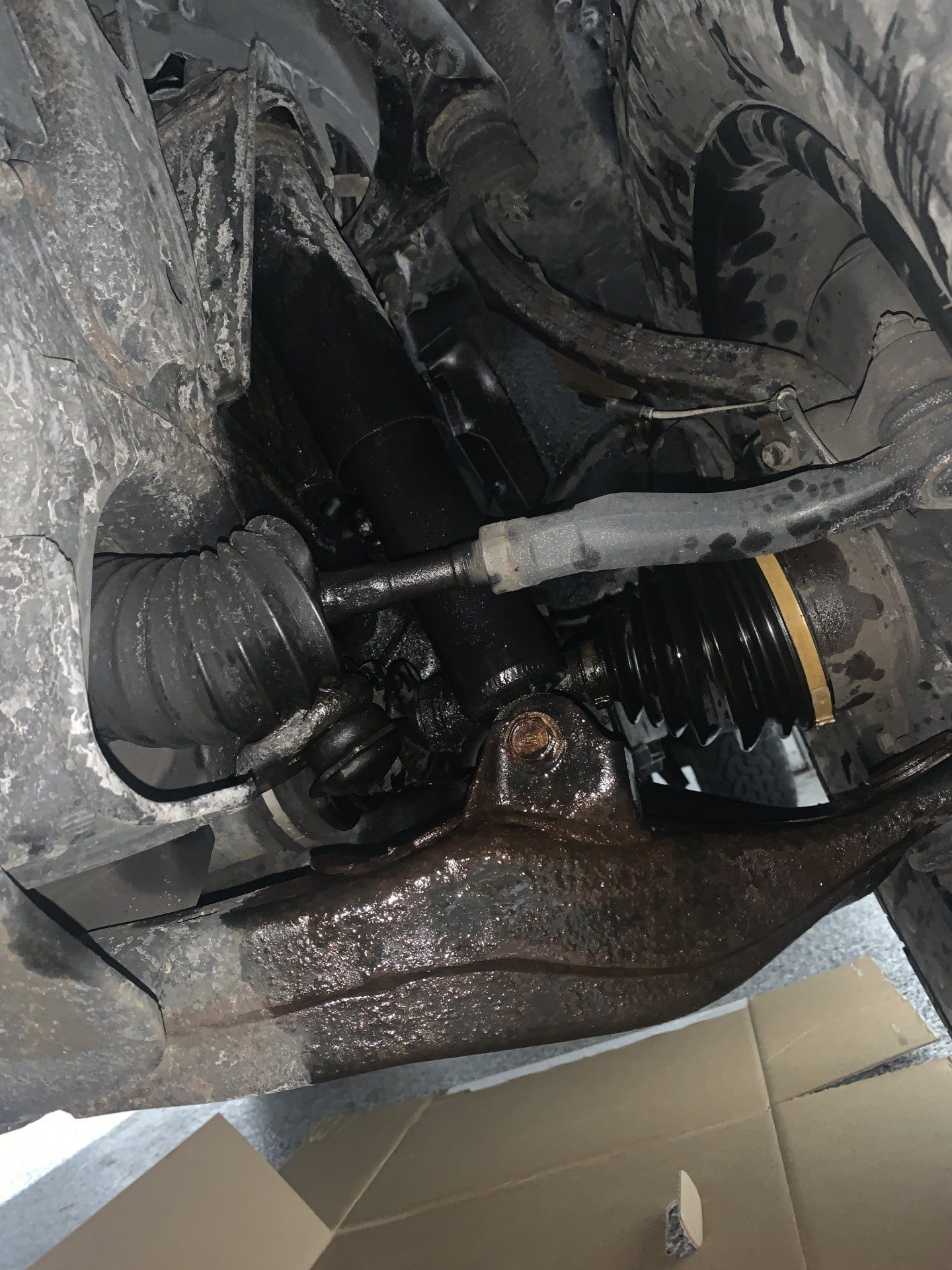

Noticed a leak yesterday from my drivers side boot, and by leak I mean it's spraying all over the place. Just ordered the Lexus rack from here: Genuine Lexus Parts | Bell Lexus North Scottsdale - https://parts.belllexusnorthscottsdale.com/. Great price and free shipping. Will just need to limp along with filling up my reservoir until the part comes in. My indy gave the green light to put it in for me, ballpark $450 including misc. shop supplies, labor, and alignment, which sounds like a better option for where I'm at in life (namely 4 kids, 7 and under).
Bell Lexus was kind enough to confirm the 44250-60120 part number was correct for my VIN over the phone prior to me placing the order. They also have free shipping over $75. The only down side is I'm on the east coast and they are located in Phoenix so I might not get it this week.
Appreciate all of the great information that's been shared on this topic.
edit: added a pic of the leaking side. Seems a bit worse than I thought.
