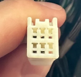

The smallest one connects to the old nav screen and I believe it is called the M7. (3 wires)

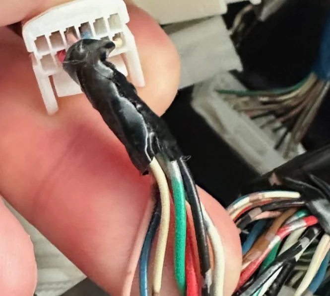

The second smallest one connects to the tape deck unsure what the connector is called. (7 Wires)

m7 6 position is nav drive.
r37 12 position. pink, blue, white all next to each other are data to rear seat audio. The bigger gauge wires in r37 are CD changer.
