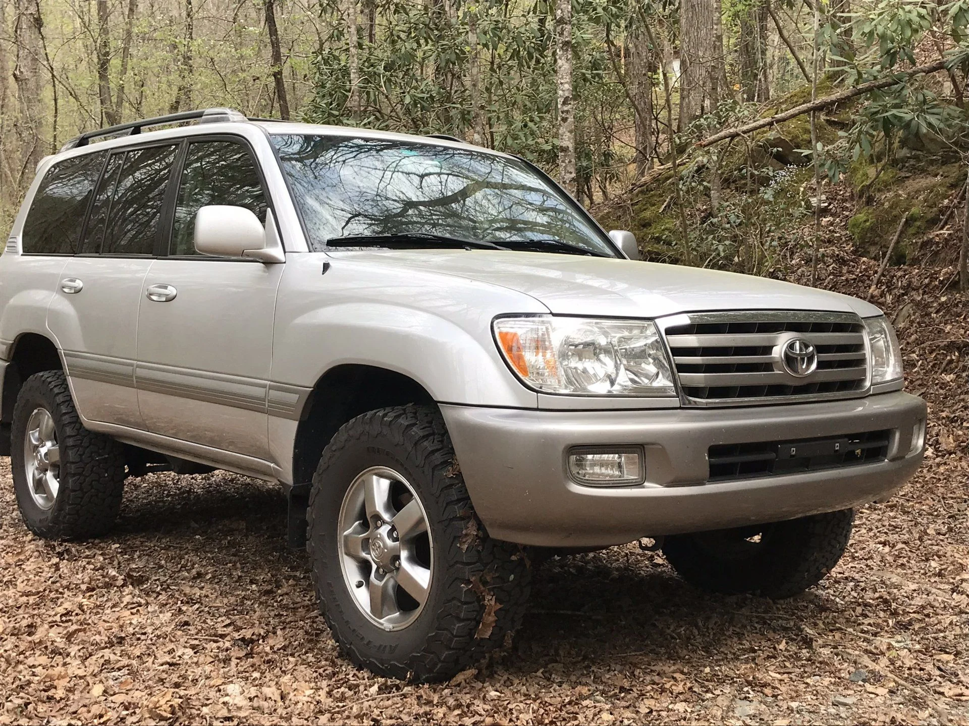

There is really not much to it. I lifted my 06 with AHC 2” in about 1 hour. That includes the time needed to pull the rear springs and add 30mm spacers. I did not use the front “shock” spacers.
If all you want is a level look with a little lift all you need are a 10mm and 12mm wrench(I’m pretty sure about size, I could be off though, just going by memory) to shorten the joint on the front sensor and slide it’s position to fine tune the front height. On the rear all you need to do is loosen the sensor and slide it a far as you can to get the most hieght. You will only be able to get so much lift on the back without adding some type of bracket to extend the “slide” of the rear sensor.
Going this route you can probably get around 2” lift up front and 1” in rear.

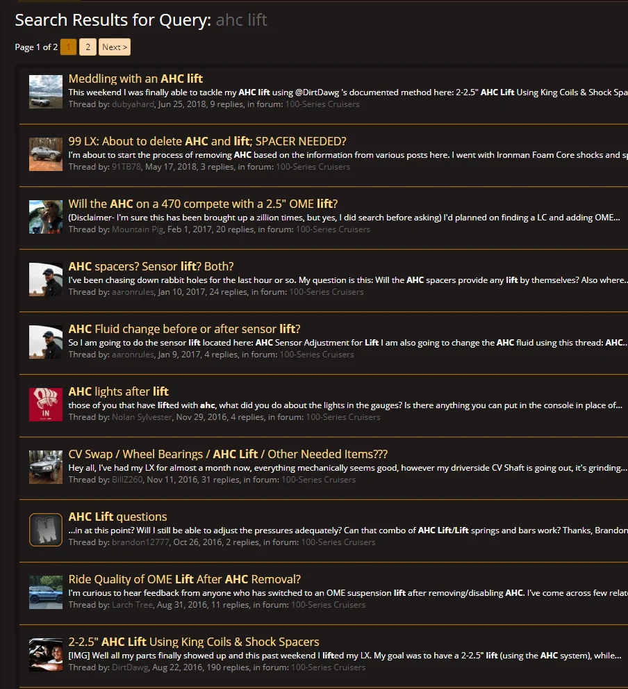

After doing this both your alignment and AHC pressure will not be ideal. I use techstream to set my neutral pressures but it can be ballparked without. You can search and probably find about how many turns it would take on the torsion bars to get pressures close to spec for a given hieght. And adding a 30mm spacer will help in the rear. Not ideal, but without a techstream that’s about all you can do.
