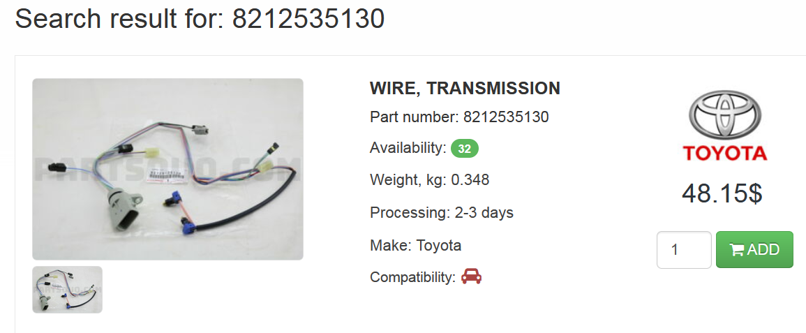

Well I drained and took off the pan. I had a feeling the internal wiring harness might have been bad. I ordered a new one ( 82125-35130 ) and installed it today. Not a terrible job but gets a little messy. Code P2716 is gone, but still getting P0984 and P0974.

External transmission wiring harness had to be replaced due to corrosion. Transmission was fine. Many lessons to be learned here.

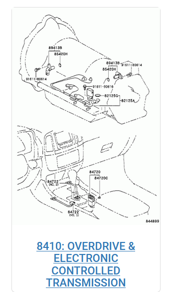

Bringing this back from the dead. Any chance you know the part number for this harness? We're having the exact same symptoms on my dad's 100.
Thanks in advance!
You need to check this with your VIN. It's on page 8410, of the Electrical parts in the EPC.
I will do this right now. I also just talked to the tech and let him know the harness has been found to be an issue so far. He's going to see what they can do to test it. Would make sense that it's an issue with something that DID NOT change over with the new trans.
Confirming the part number for my vin is what's in @Malleus post above: 82125-35130.
It's cheap, I'm just going to order one right now.
