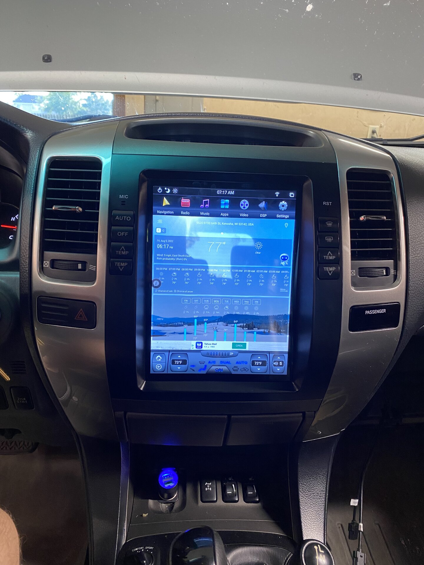

I have a good ML amp I would’ve sold you for $200 if we had compatible year trucks. Also, yes, you could’ve done a Phoenix audio Tesla style screen. I have one in my ML equipped truck.
Hey @BlackCat. would you share which model Phoenix Audio you used? all the AC buttons on the bezel work i assume? Do the on screen buttons for the climate control work??
i bought one of the original Android 6 units from phoenix audio, AC buttons on the bezel worked but the onscreen did not.
the old version android seemed to stop access to the app store and a lot of apps stopped working. so i recently replaced the old android unit with a Kiri-navi android 11 unit. i love everything about it except the onscreen buttons still dont work! I talked with their service, they said i had to use the original factory screen, plug it in, and stash it in the dash behind the new screen. the onscreen buttons then started working but, the audio sources will cycle constantly every 15 seconds. i unplugged the factory screen, the audio sources stopped cycling but the on screen AC buttons wouldnt work again! ive had the dash open for far too long and want to put this to bed once and for all.

I’d have to do some digging, it’s been a few years and it’s currently in winter storage. Yes, as far as I remember all the functions work except the clock and the outside temp I believe. I haven’t driven it since October so I’m not too sure.
