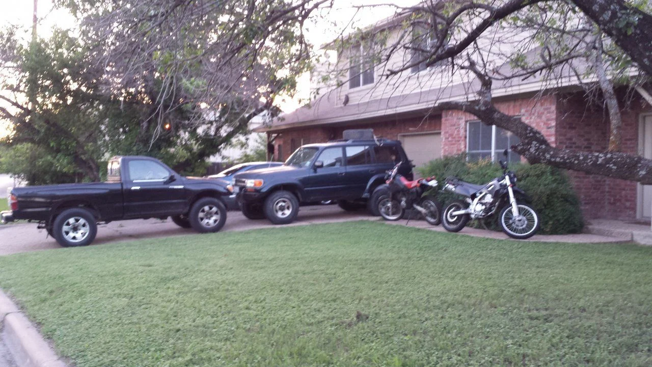

I have the 5100s in my 99 Std cab 4x4 2.7. I set them to the bottom and now the middle position for a level stance with FJ cruiser 17" wheels and 265/65R17s. Picture was with bald tires. I drive aggressively and felt it bottom out numerous times before. I like a little for compression.
