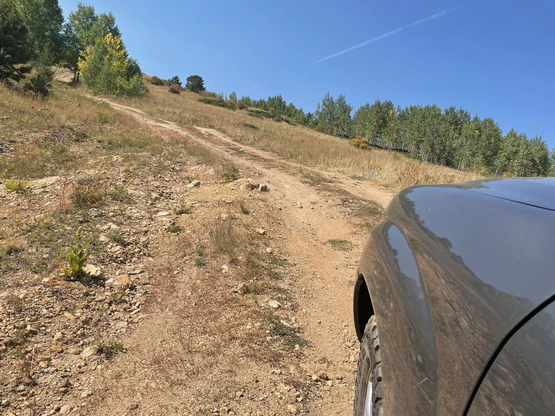

Going to be hitting some trails near Denver today. We're looking at the Yankee Hill trail network near Idaho Springs. Looking forward to getting out and stretching the LX's legs for a bit
Trip Report!

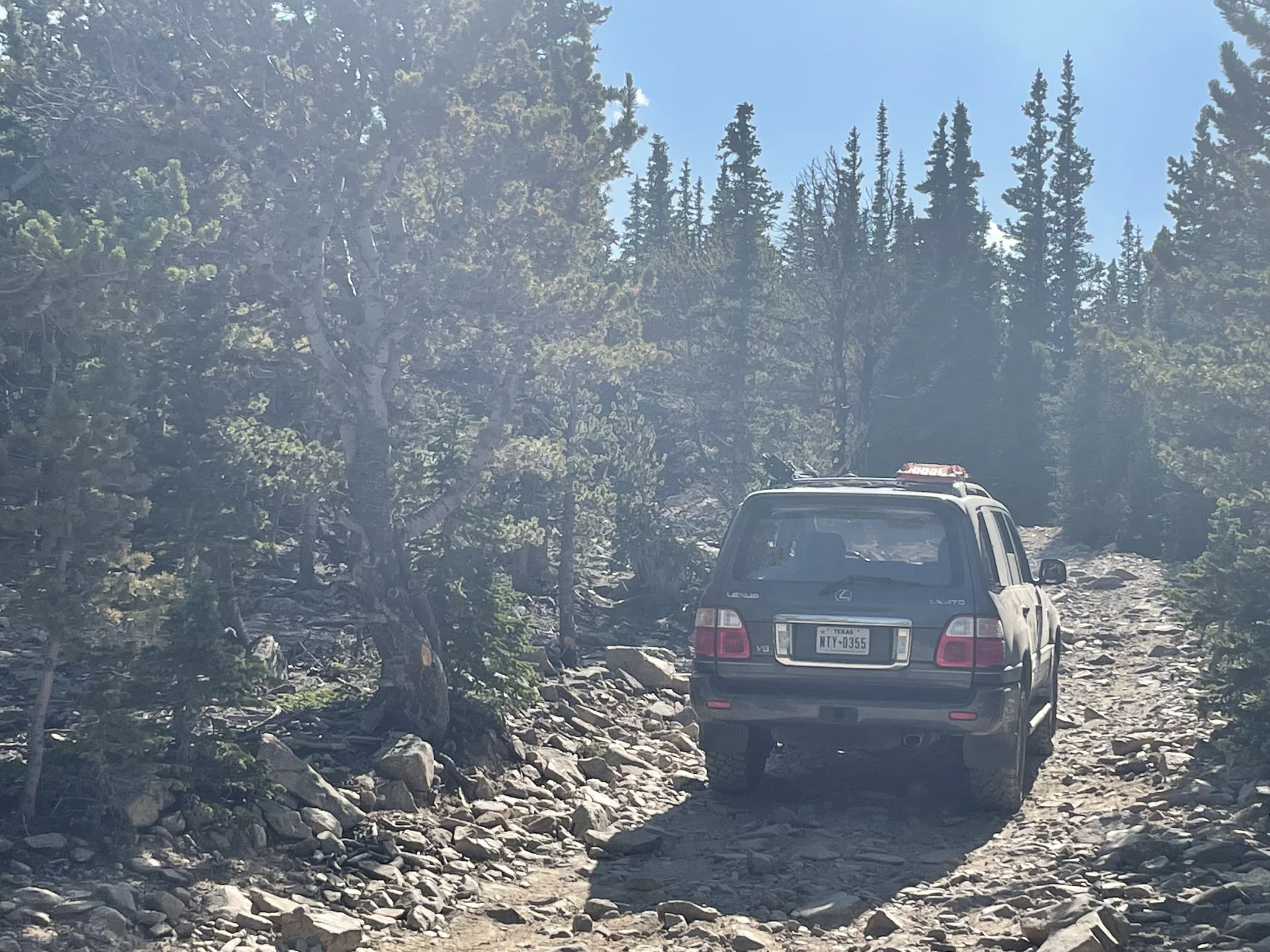

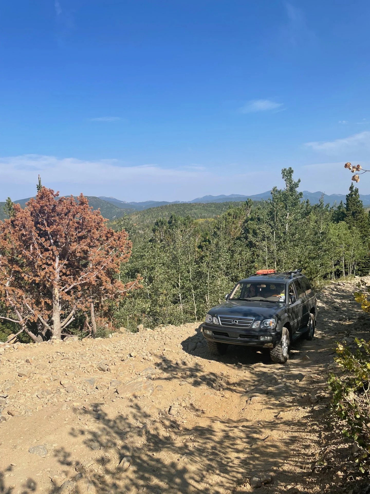

Went out to Yankee Hill and Bald Mountain and had a blast. Got a little nervous because I learned on the spot about the boiling gas/venting fumes issue with the 100 series when getting up there in elevation. The truck ended up making it home just fine, there was just a heavy gas smell for around 2 hours until we descended the mountains. We started in Idaho springs and took a nice scenic dirt road (Virginia Canyon Rd) that climbed through the mountains until we got to Central City. Once we got there, we took Bald Mountain Road to the Yankee Hill trails and followed those trails until we dumped out a few miles west of Idaho Falls.
We took about 4.5 hours to make the route, and everything worked out nicely.
Side note: the trails we took are lauded as easy going scenic trails. While they are scenic, they are not necessarily easy in terms of the amount of large sharp rocks on the entire trail. I felt a little sketch being the only vehicle out there, but we made it out. Would not recommend following that path solo.

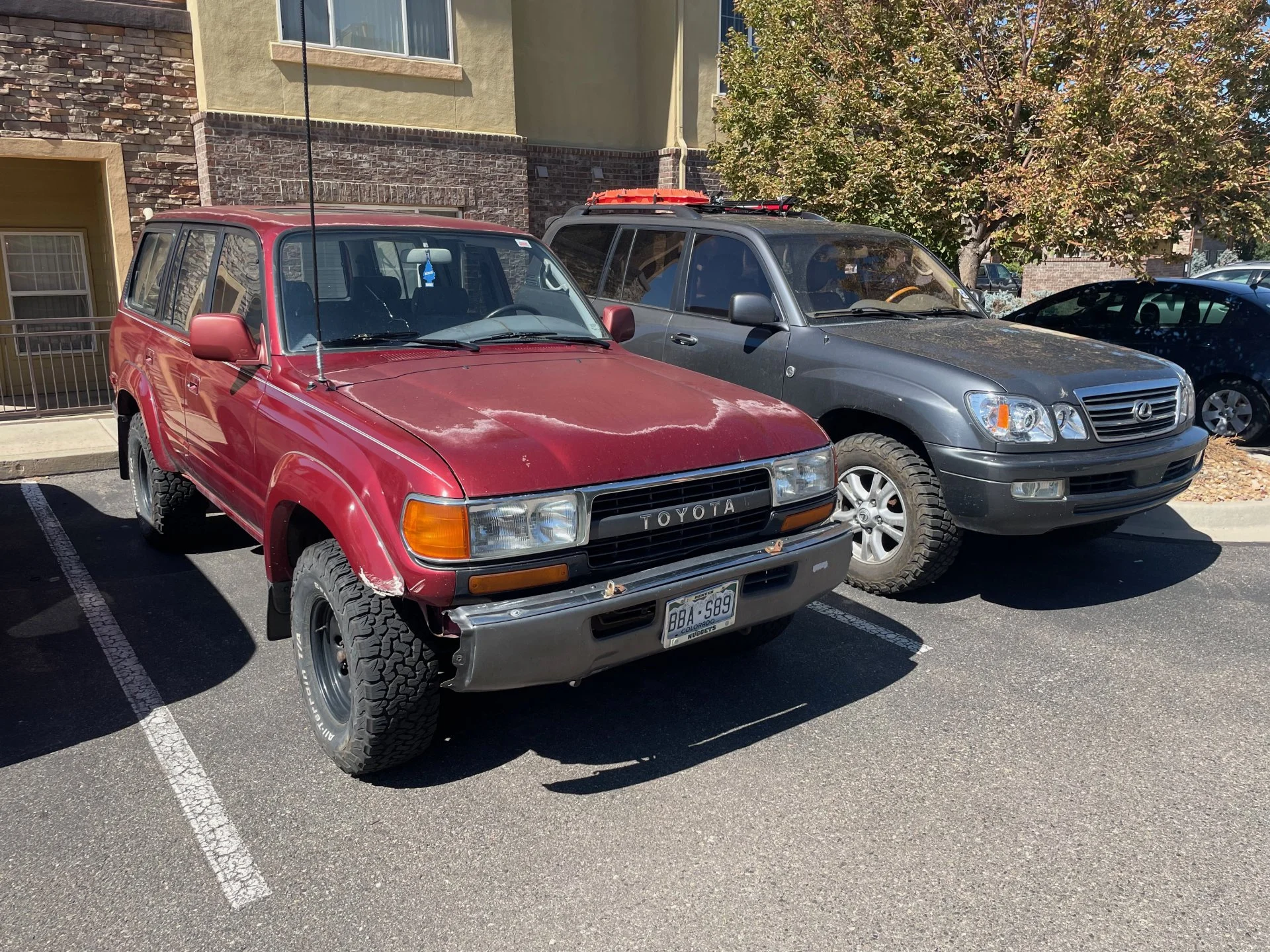

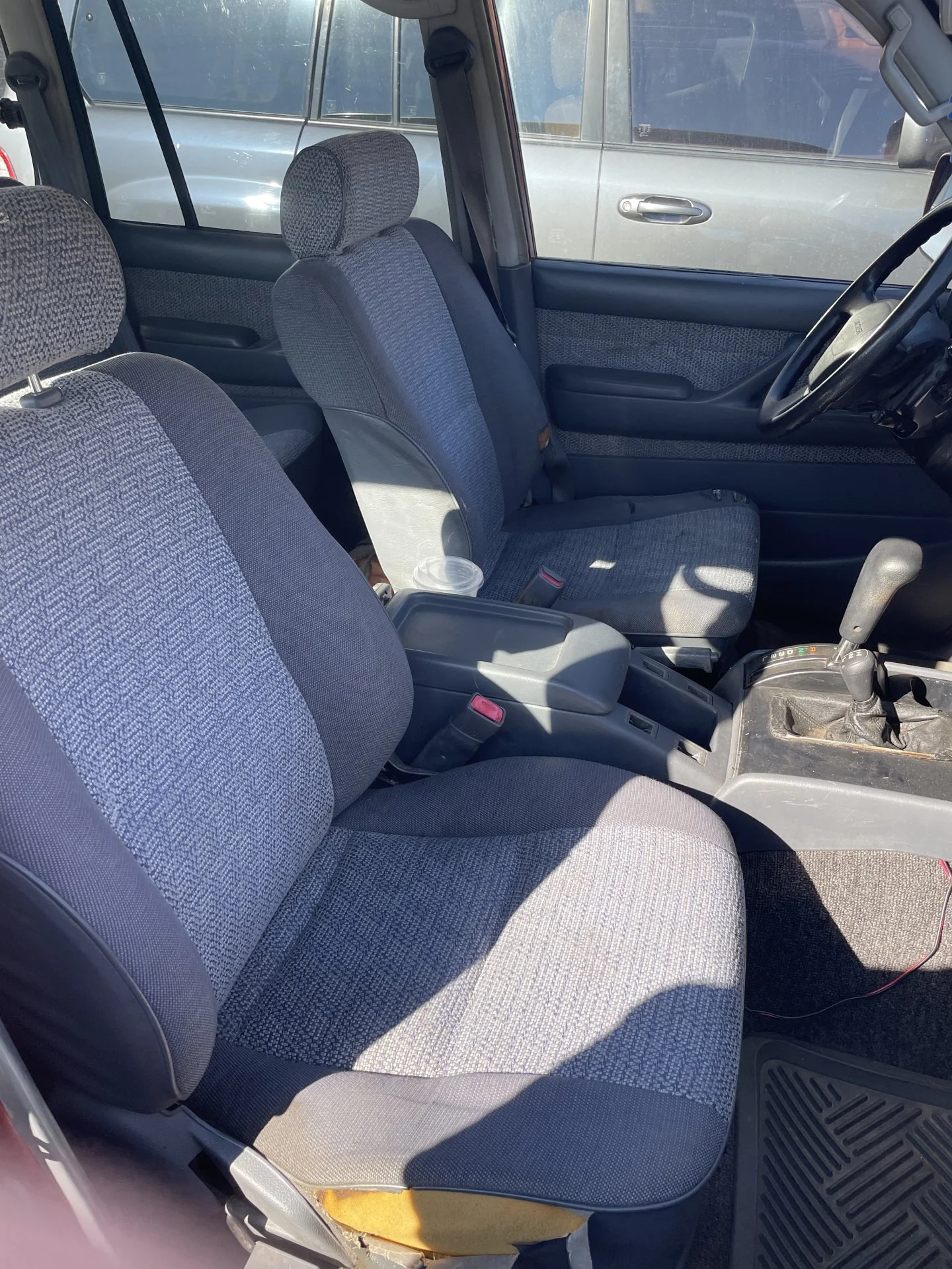

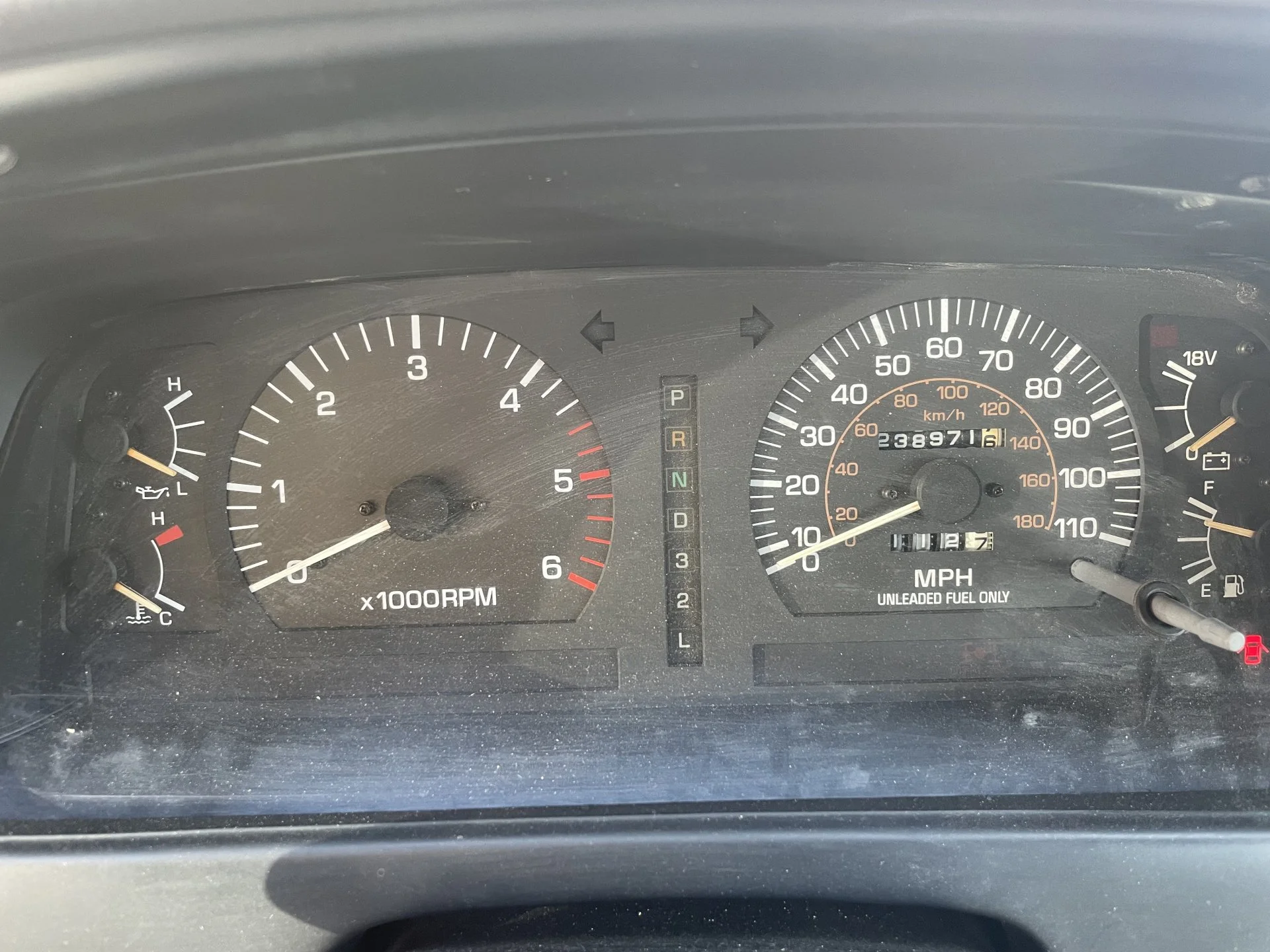

I decided to pick up a second vehicle for winter duties while my wife drives the LX this winter. We sold her car after it being downright terrifying to drive in the snow (RWD 350hp). And now, we welcome to the family, this 1991 Toyota Land Cruiser 80 series.
This has a center locker (did they all have one?) and pretty clean seats for 239k miles. The 3FE is significantly slower than the 2UZ-FE, but that was to be expected lol. It drives straight and has really no issues other than some air in the brake system I need to bleed out. Stoked to drive this during the winter!
I ended up buying this Cruiser for $3750, talked down from $4500. I think I got a pretty good deal, but I'm sure I'll hear something from someone :hillbilly:

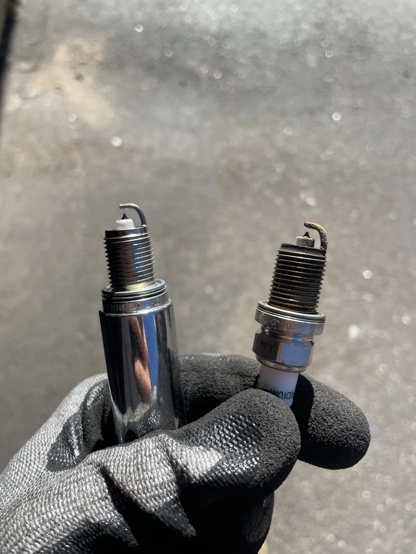

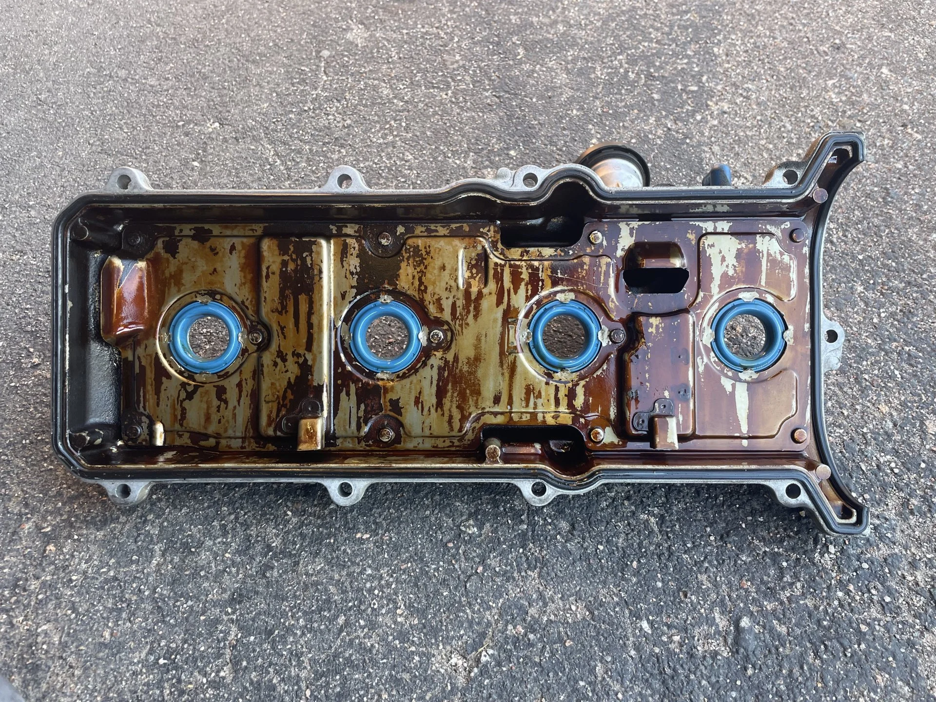

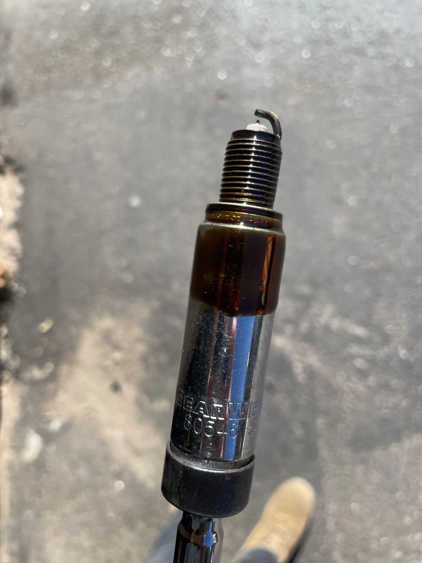

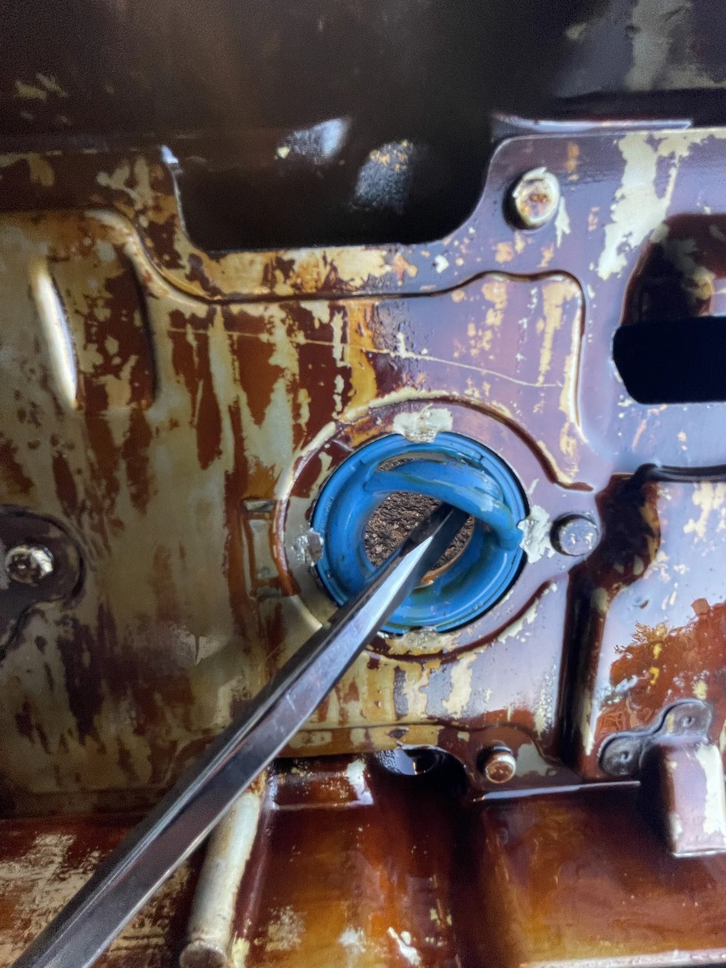

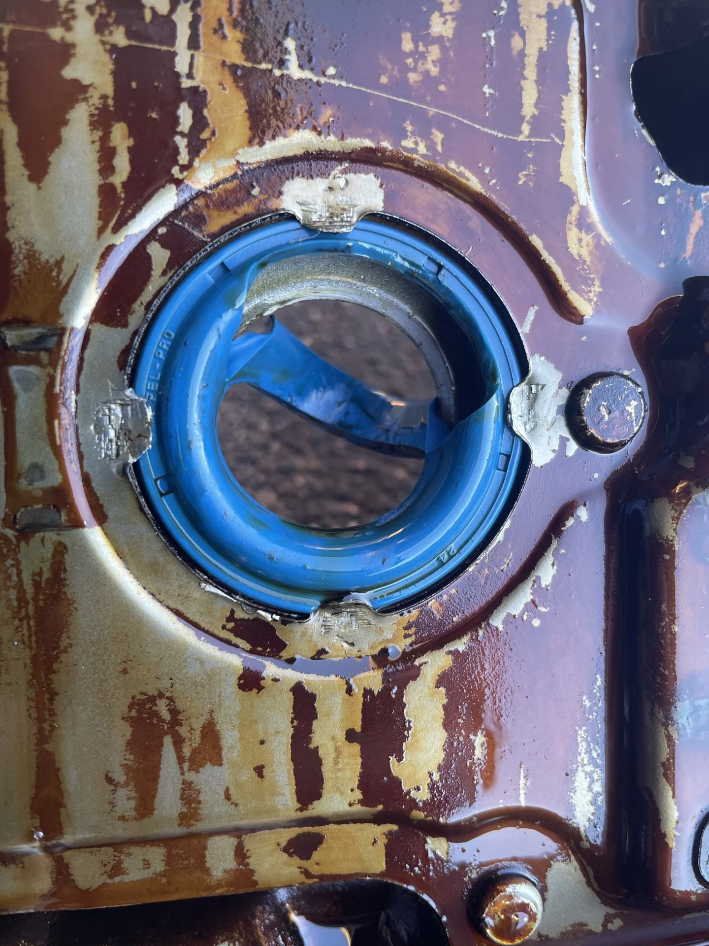

I changed the spark plugs yesterday in both the 80 and the 100, and found oil in one of the 100's spark plug tubes on the drivers' side (the side I replaced the valve cover gasket and spark plug tube grommets around a year ago..). I'm going to replace again this weekend, but before I do, has anyone has issues with the FelPro kit? Is OEM a better option? I ask because I used FelPro and was diligent during install, but certainly expected a longer life than ~1 year
I ordered the valve cover gaskets and spark plug tube grommets today from Toyota, they should be here in a day or two, with the work being done sometime this weekend. I decided OE has to be better than FelPro so we'll see. Here's hoping I don't have to replace again in a year
Here's a look at the culprit spark plug tube grommet. This was ~1 year after proper installation of daily driving and two long distance trips over 3-4 days each trip. It definitely shouldn't have had this big of a tear in the seal, so I personally would not recommend Fel Pro in this instance. I replace with OEM, and the job was done in ~1 hour. I let the truck sit overnight to let the FIPG set, and it has been driving no problem since then, 100% leak free.
