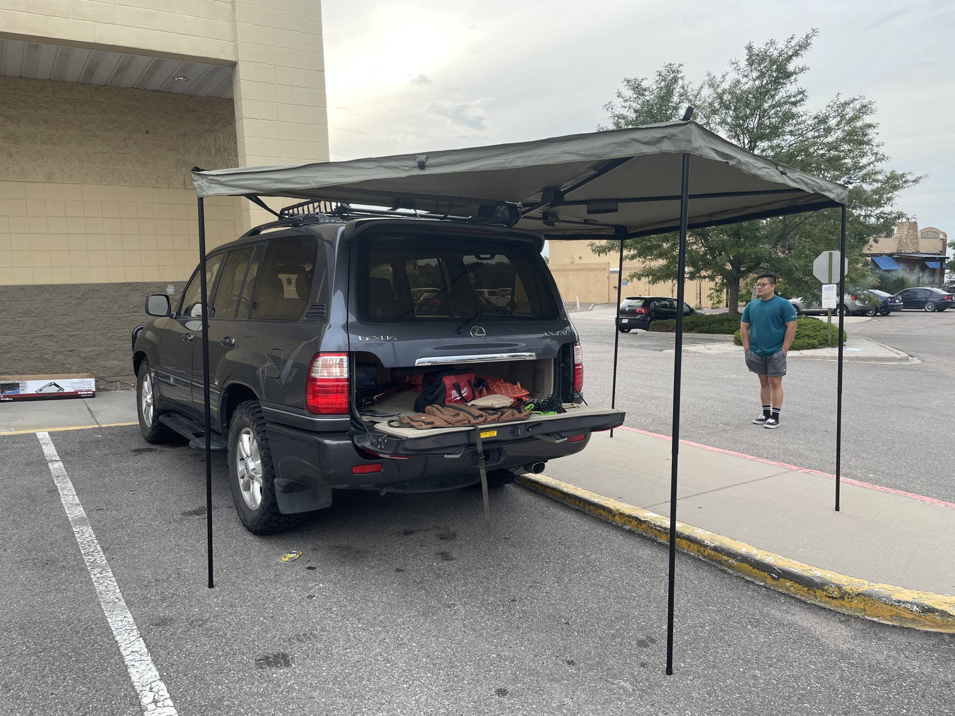

Due to the weather that the San Juan Mountains have been getting (daily rain) and where my cooking surface is located, I called an audible and ordered the Ironman DeltaWing 270 degree awning. I didn’t really want to get this before the trip, but I think it’ll be for the best in the long run when it’s raining and I need to make dinner.
The awning brackets didn’t fit with the OEM roof rack, so I also had to get a roof basket from Harbor Freight. Definitely not what I wanted, but oh well.

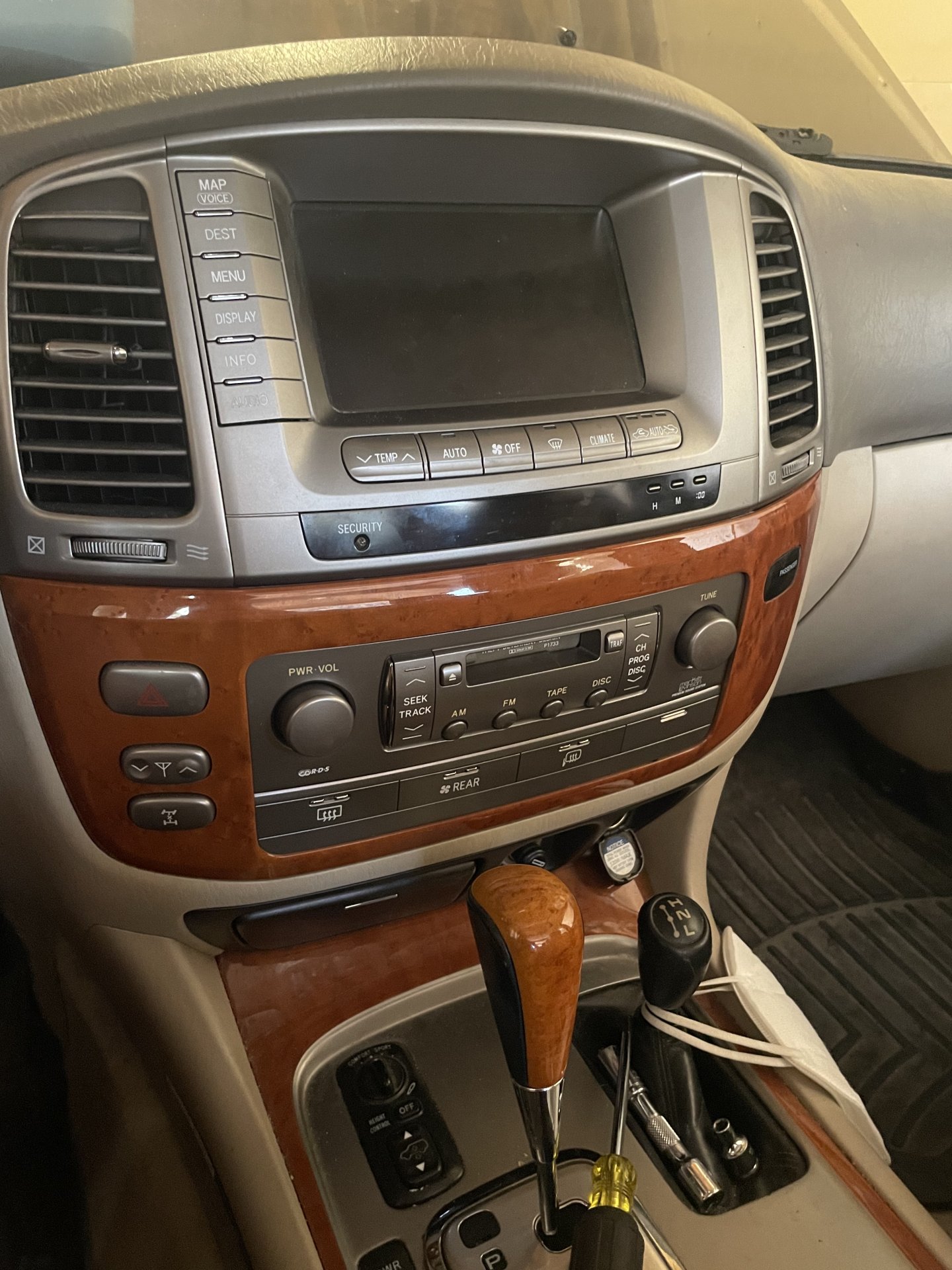

My radio has been non-functional for around 3 months now. No sound but nav still worked. The ML system is stupid proprietary, so converting it to something else is quite a tall order. As a result, I decided to maintain the OG system, so I purchased a ML amp to solve what I thought was an amp that overheated. I replaced it and it did not fix my issue.
I searched and searched and asked on every LC/LX forum I could to try and find a solution. Nobody had a real straight answer but thanks to some great advice on the functionality that the ML used to deliver sound (provided by a user here on Mud), I decided to swing for the fences and try to replace the stereo receiver. I ordered it on eBay and installed the new unit today.
The sound is now back, and I forgot how amazing it is to have a car stereo!! So glad it’s fixed, but I sure wish I hadn’t bought an amp first considering the cost of them. I’m going to check my old amp and if it’s still functional, I’ll probably try to recoup some of my loss by reselling one of them.
