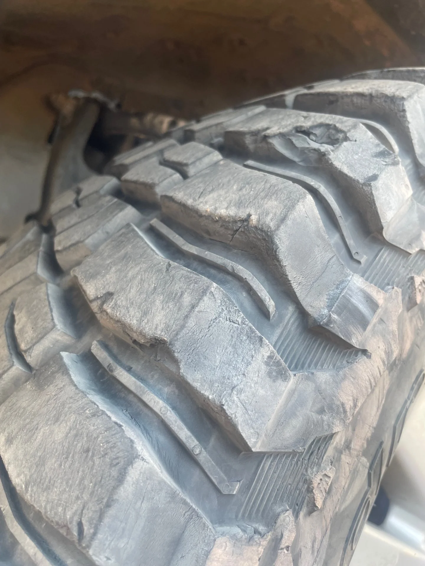

Looks like an incredible trip. Thanks for sharing! Bummer on the Toyo tires. Howd the LR4 handle the trails compared to the LX?
The LR4 was impressive! I think because of my larger tires and slightly more clearance, I was able to tackle slightly gnarlier stuff (not to mention I was willing to go a little harder in my LX), but my dad definitely has the better driver mod equipped. I wish he hadn’t caught the sidewalls because it really cut his time short, but when he comes back with KM3s, I’ll get a better idea of how his truck is compared to mine

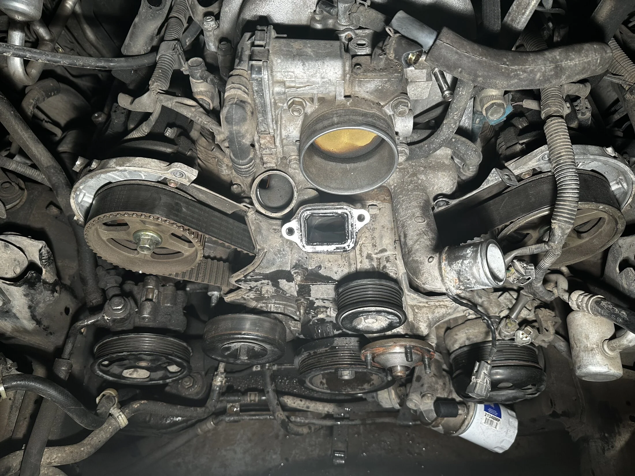

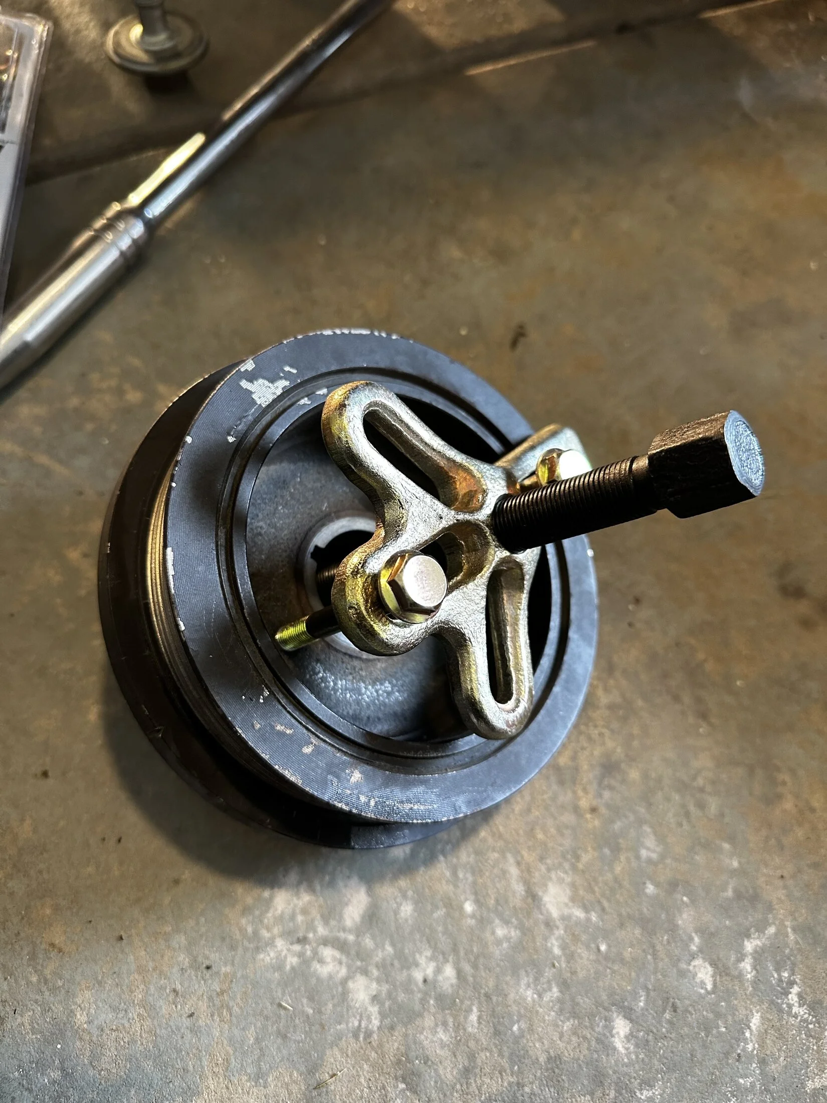

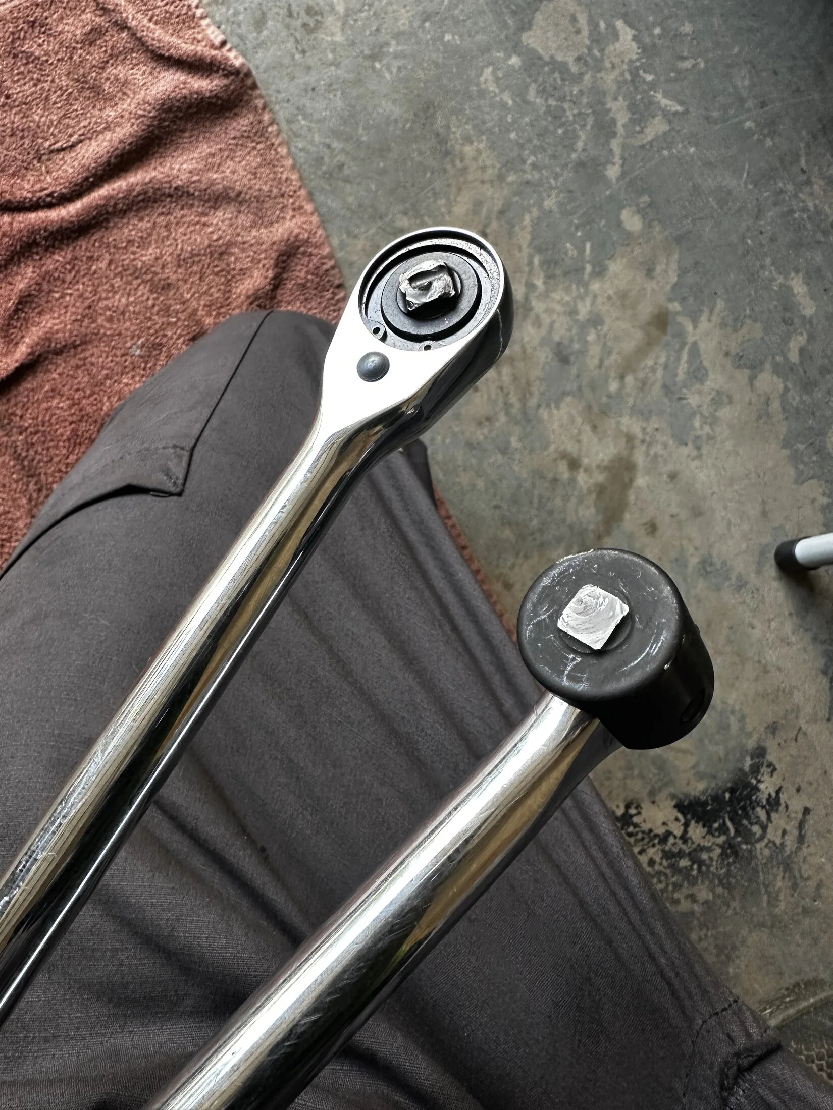

About a month ago, I took on the job of replacing the timing belt, accessory belt, and water pump. I broke three breaker bars in the process of getting the crank pulley bolt free (no idea why it was torqued down so hard). Using a crank pulley puller was a lifesaver getting it off, and the reinstallation of everything was surprisingly easy. After driving it I can say that everything went perfectly, and I have other's in this forum to thank for their detailed threads on the job. I'll upload some photos of the job once I am able to for the sake of my cataloguing of everything
Next on the list is to inspect my front rotors for warping, I've been getting varying braking intensity on the front end recently.

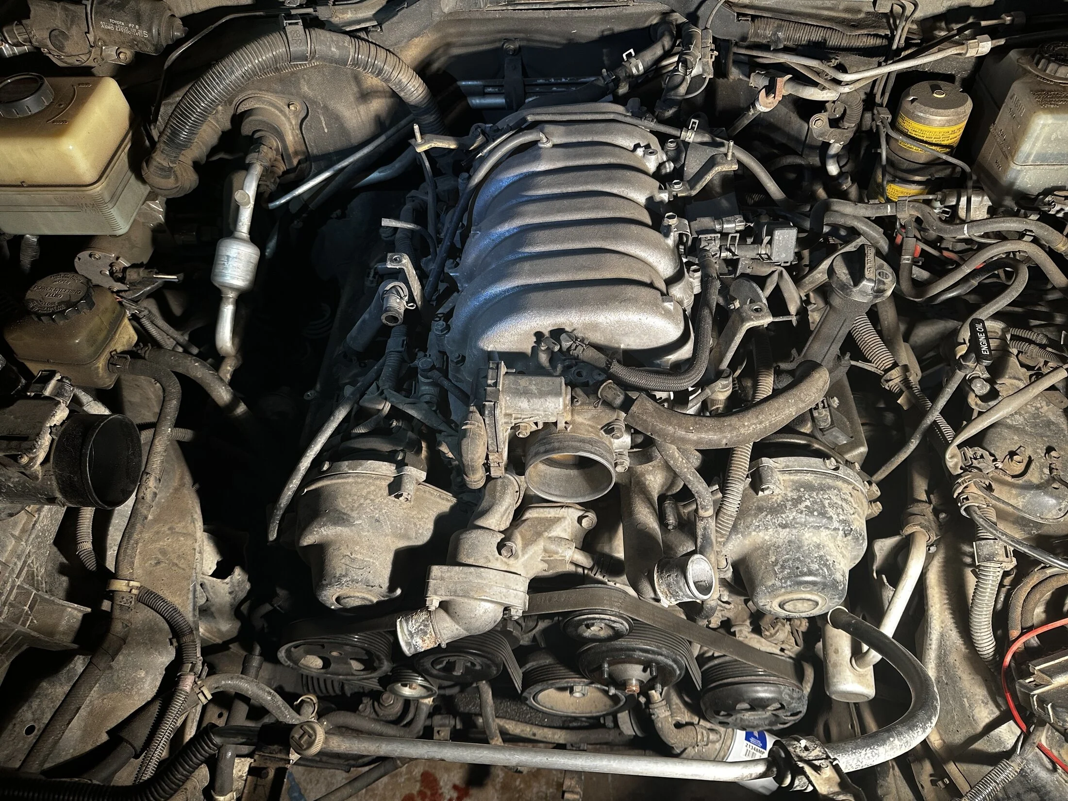

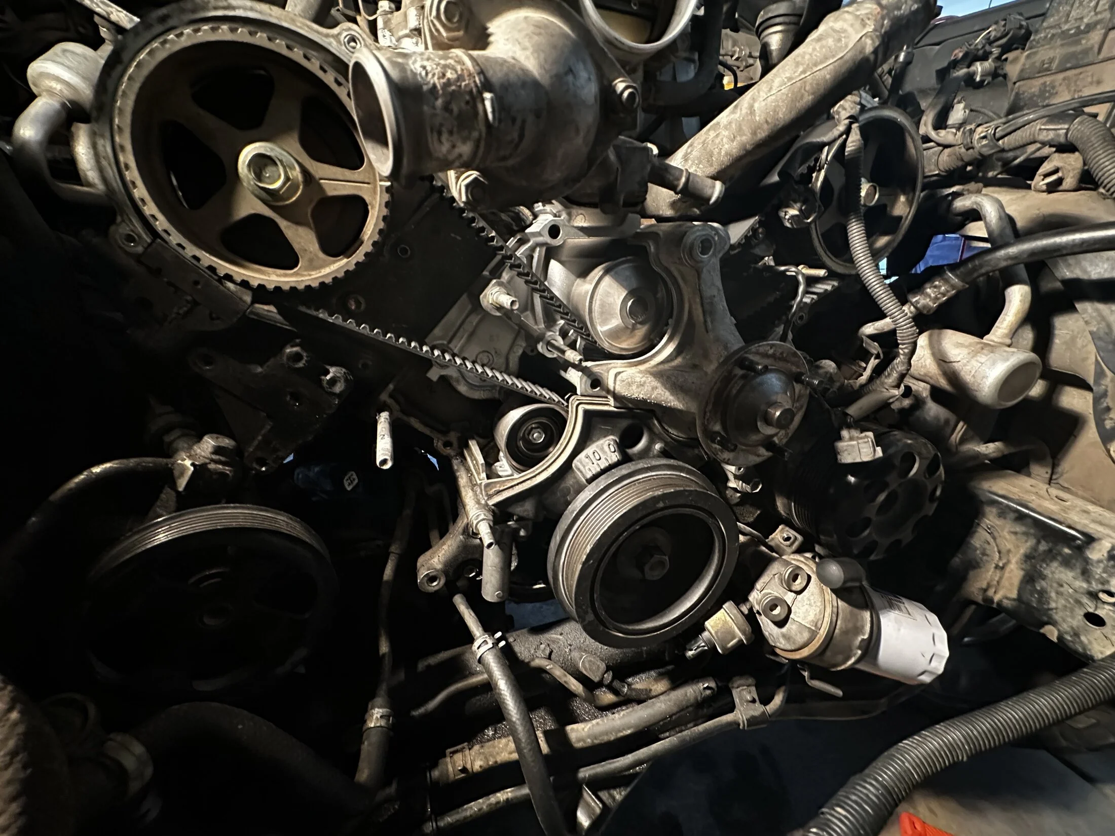

Here's some photos of the timing belt service (1.5 years later lmao). I used Yota Shop's Timing belt kit TKT-021. In retrospect, I probably should've changed the accessory pulleys while I was in there, but I was on a time crunch and didn't have a ton of extra $ to throw at the job.
