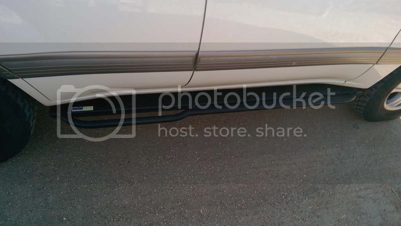

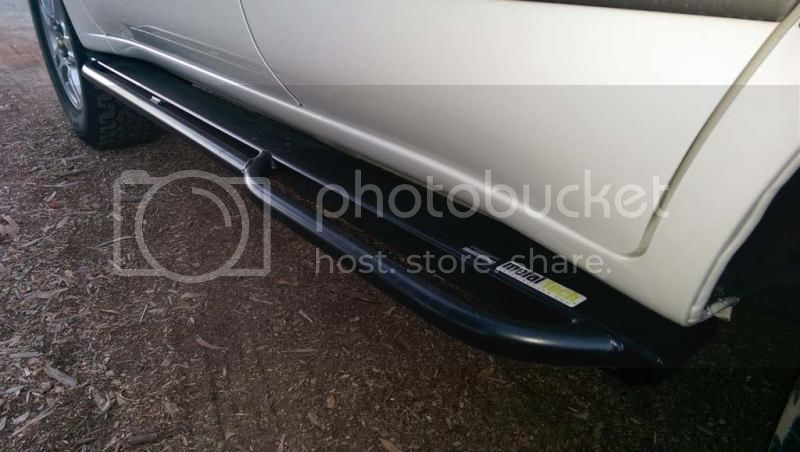

I picked up a set of Metaltech sliders a few weeks ago. They are almost too pretty to scratch up.

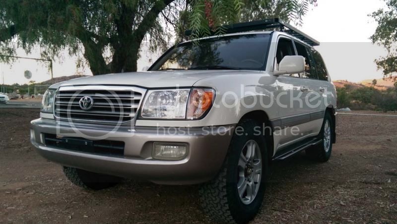

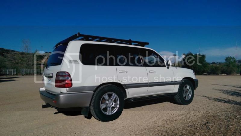

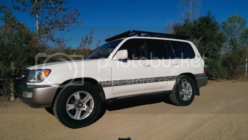

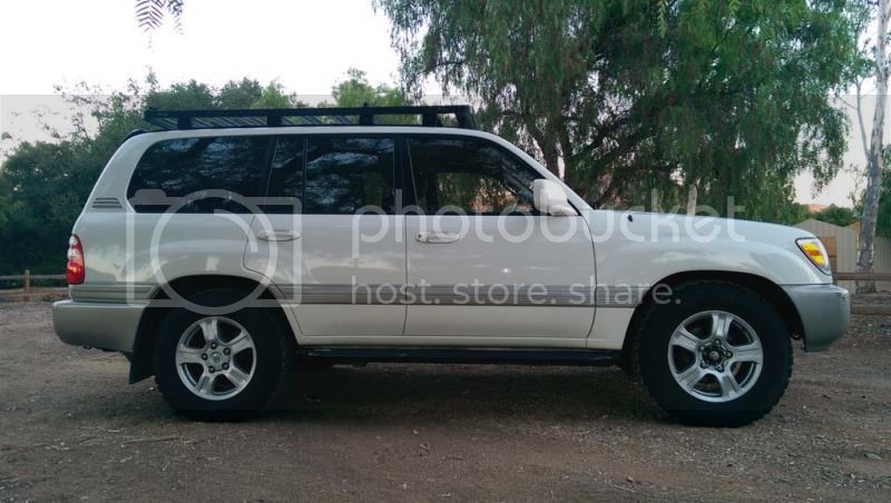

Finally got some new shoes. I was happy with these on my 80, so went with them on the 100. Toyo AT2. :cool:
I was undecided on wheels. It was either 275/70R18 on the factory wheels or the Tundra wheels or 285/75R16 on the factory wheels that came on the 98-02 trucks.
I liked the look of the 18" Tundra wheels, but was concerned that the 275/70R18 wouldn't have enough sidewall. My test setup seemed to work well on the Santiago Peak run, but there weren't many rocks there to test sidewall flex. I saw in another thread someone running this size tire in a rocky area, and the rocks were dangerously close to the wheel. Plus the 18" tires were more expensive.
I decided on the 16s, but was having a hard time finding a set. Not having any luck locally, I bought a set from a guy in CO. They looked good in the pics, but after receiving them, I discovered the clear coat was pitted beyond my liking, so I kept looking. I then bought another set for a great price from a guy in AZ. These were much nicer but after receiving them I realized they were the darker silver color and I wanted the lighter. I was about to give up and get the 18" tires, but decided to check craigslist one last time. Just so happened there was a set there, just up the coast a bit, so I drove up and bought them. Now I need to sell the other two sets :hmm:

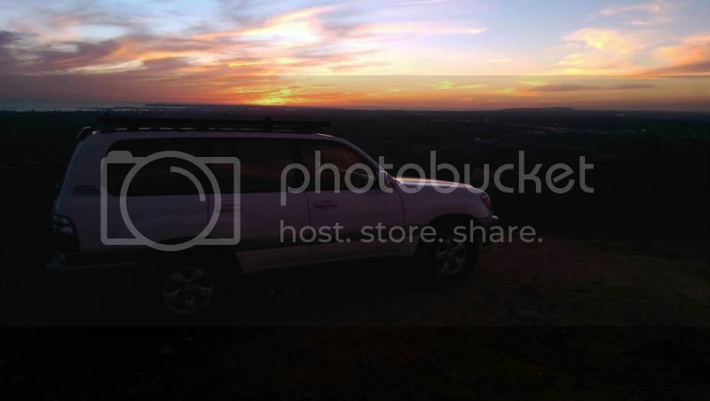

Took a drive up a local dirt road to test them out and watch the sunset.
Looks great, I like the Toyos. We're running basically the same setup, 285/75r16 with stock lift...and a white cruiser.
The sliders look great too.

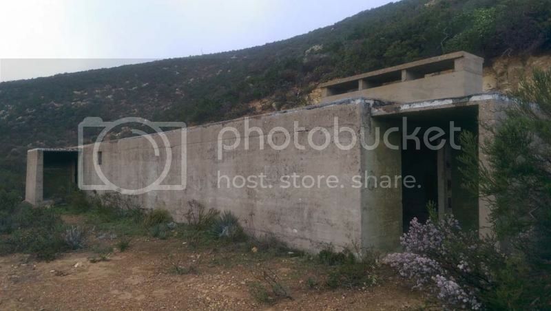

I stumbled on these strange rock formations. Not sure what they are or why they are there. Maybe someone was bored :smokin:

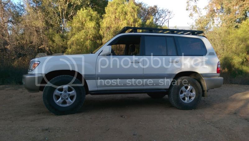

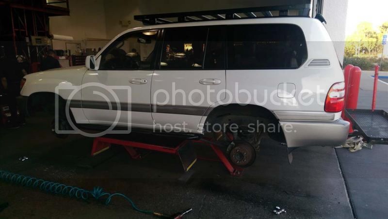

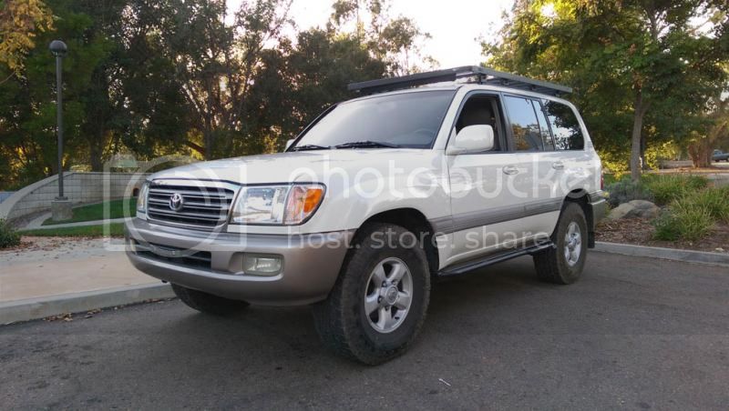

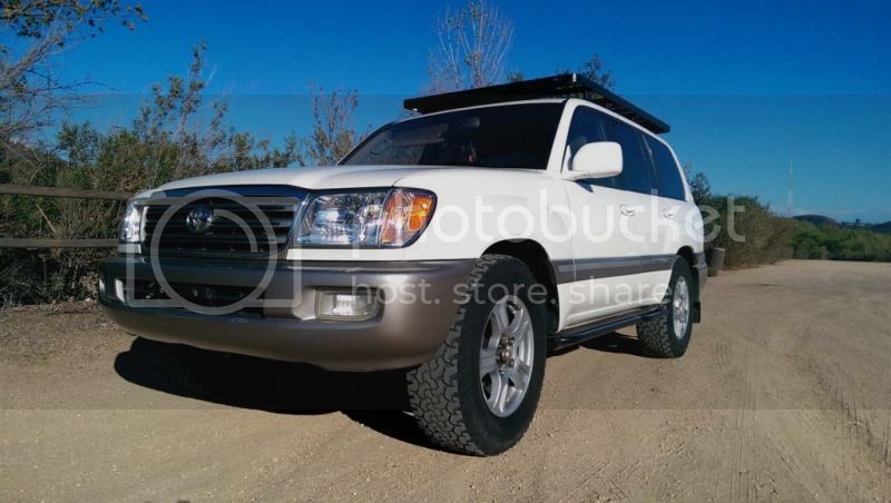

Finally got a lift installed. I had some OME 865 springs I got from Tare sitting in the garage for months. Slee just had the TJM XGS Gold shocks on sale so that was my motivation to get this stuff installed. Also picked up a diff drop from BIOR. Adjusted the factory torsion bars to bring the front-end up.
Installed I netted about 1.5"-2" lift. Just enough to add some much needed clearance, but not enough to affect driveability or cause too much CV angle. Pretty happy with the way it turned out.
Measurements from center of hub to fender lip (vertical line)
Before After
FR 18.75" 20.25"
FL 19" 20.25"
RR 19.25" 21.5"
RL 19.25" 21.5"
Droop 5" 3"

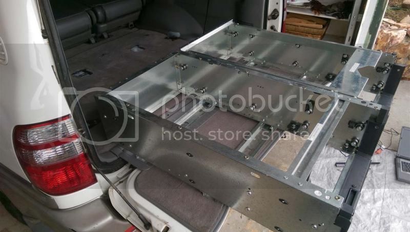

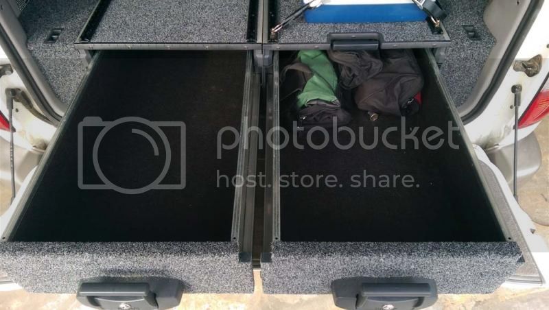

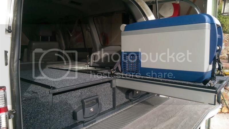

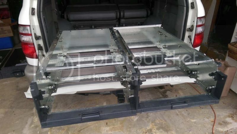

Ordered a set of ARB drawers. I was a tiny bit concerned about the semi-permanency of the whole thing, but I think it will work just fine. Besides the organizational advantage, I wanted something that would provide a flat surface with the second row seats folded down. I tested a queen size air mattress in there and it fits like a glove.
I also installed some L-Track (airline seat track) on to the drawer tops using the existing mounting locations. Got the hardware from uscargocontrol.com.

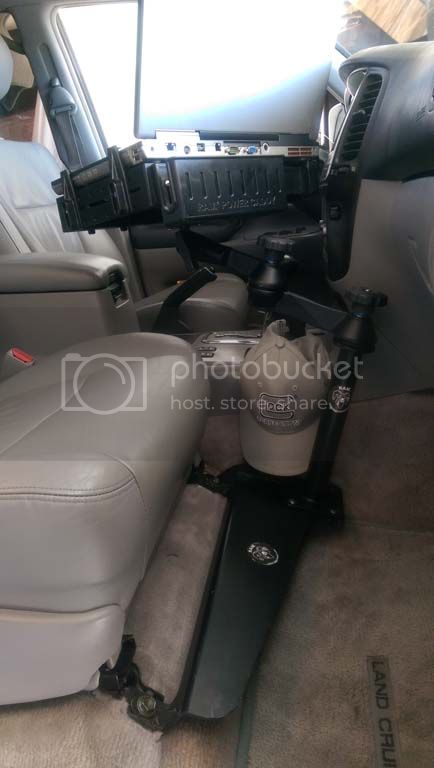

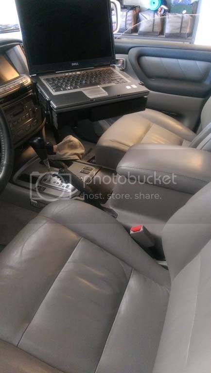

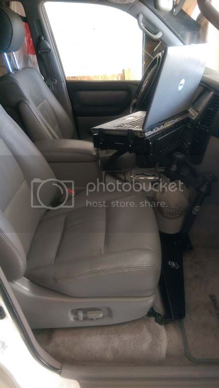

I picked up a RAM laptop mount recently. I wanted a computer in the truck for navigation, mapping, APRS, radio programming software, techstream, repair manual PDFs, etc.. Shown is a 17" laptop, which is pretty large for that area so I will probably try to find something a bit smaller. I know a lot of people are using tablets, and I may eventually go that route, but I already had the laptop setup with most everything I need so will try that for now. Plus it's nice to have the serial port as some of the programs use it, and the USB to serial port adapters can be problematic.
