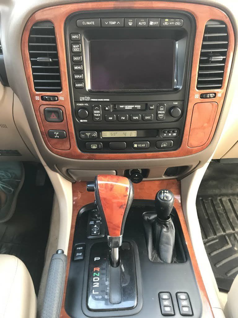

Hello all. I'm getting ready to purchase a 2002 LX470. Love everything about the truck except the navigation/radio. Is there a way to remove the navigation and install a standard non-nav system? I'd like to install a google play system, but can't find any that are compatible with the navigation system. Any help would be appreciated.

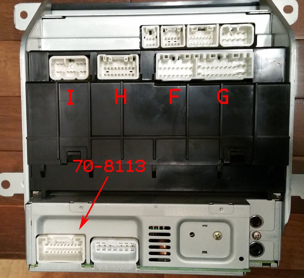

I’m thinking about installing the Grom and somehow mounting and wiring an aftermarket amp to the factory harness under the passenger seat. Any wiring diagrams for the factory harness and the Grom would be awesome if anyone has them.
Is it possible to turn the pre 2003 LX470 navigation into a pre 2003 LC Manual AC bezel? By splicing in the wiring harness?
