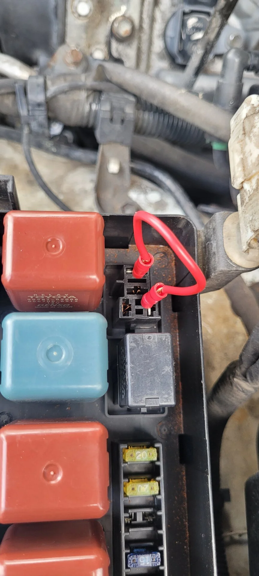

  • Jumped the magnetic clutch relay. Ac was blowing cold but noticed a smell of refrigerant and actually started to feel light headed after about 20 mins of driving with nice cool ac. A/c light was still blinking.

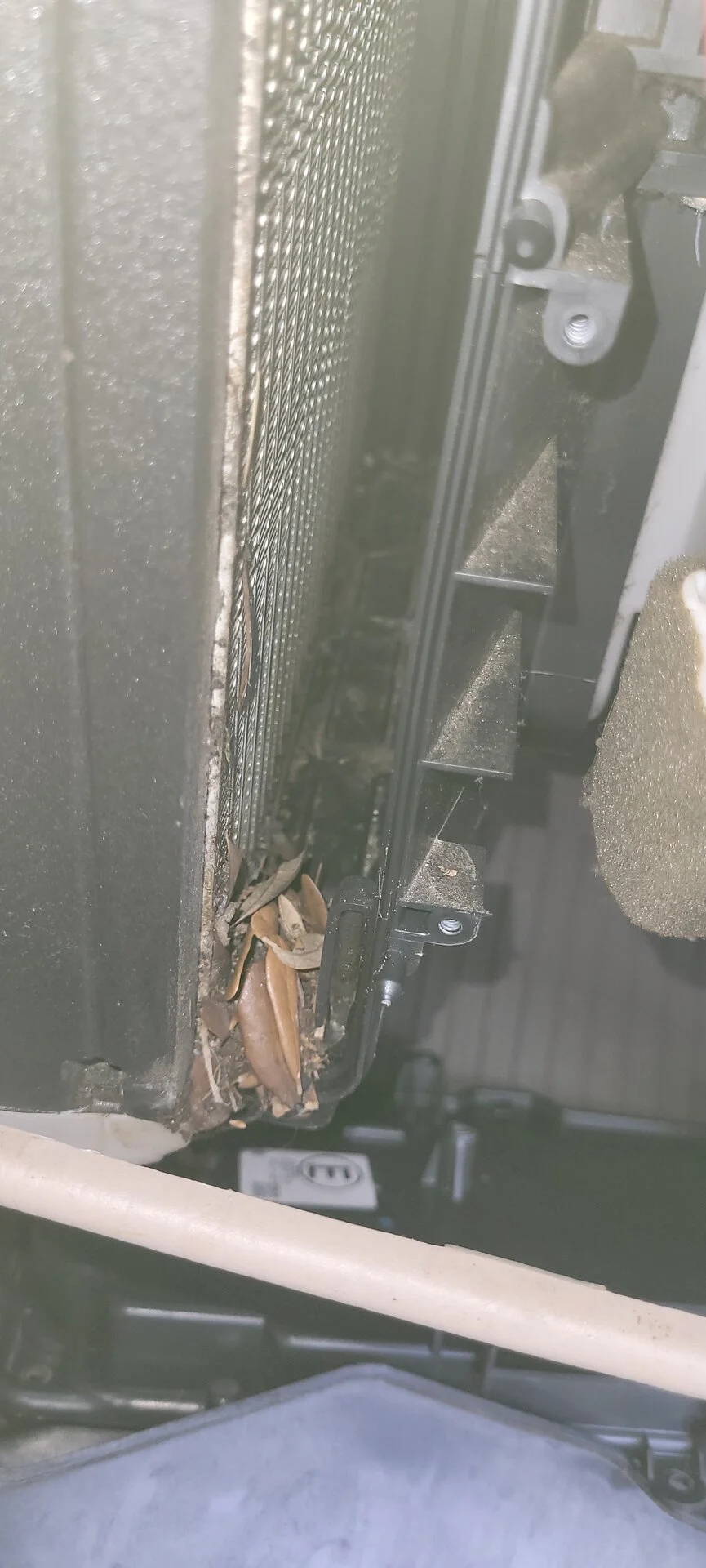

  • Bought a leak detector from Amazon and it caught a leak in the a/c evaporator core. Must be small because the pressures are still pretty good.

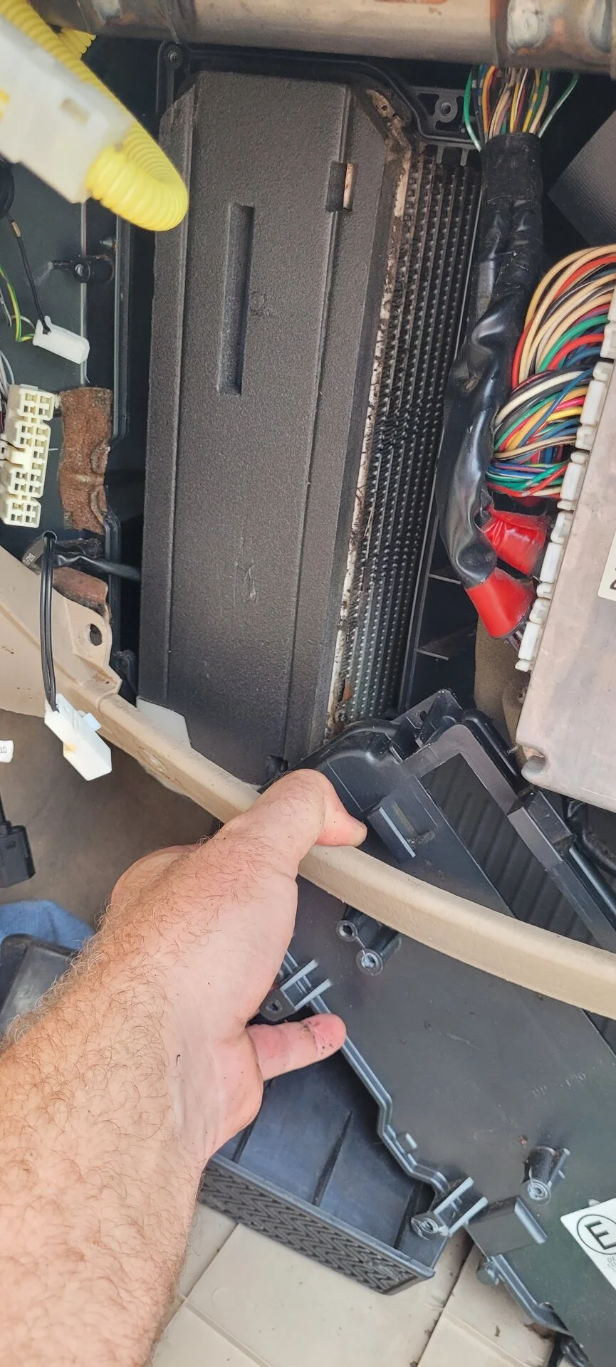

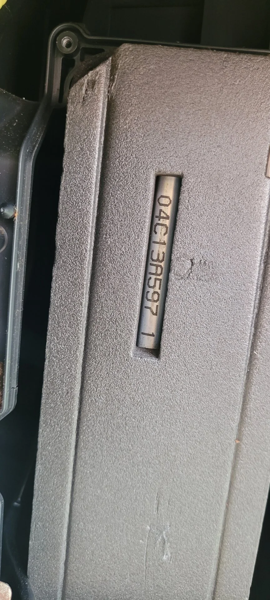

  • It could be the original denso evap from 2001, I'm planning to replace it using the tips here and will report back. Number imprinted is 04c13a5971 also the expansion valve. I will probably bite the bullet and replace the condenser, pressure switch, and compressor.

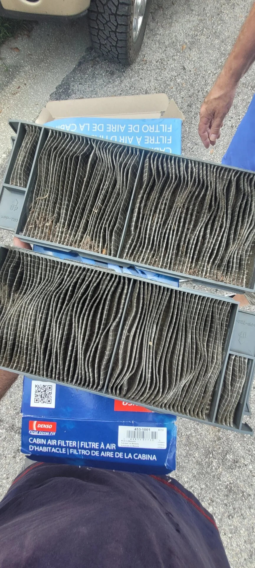

  • The ac filters were pretty gummed up, so will be replaced.

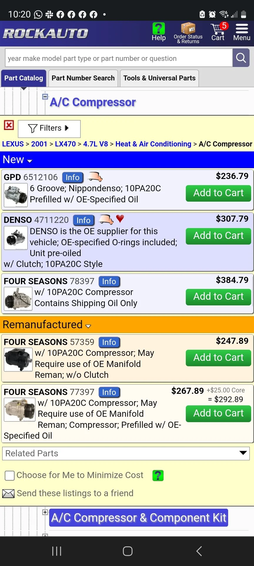

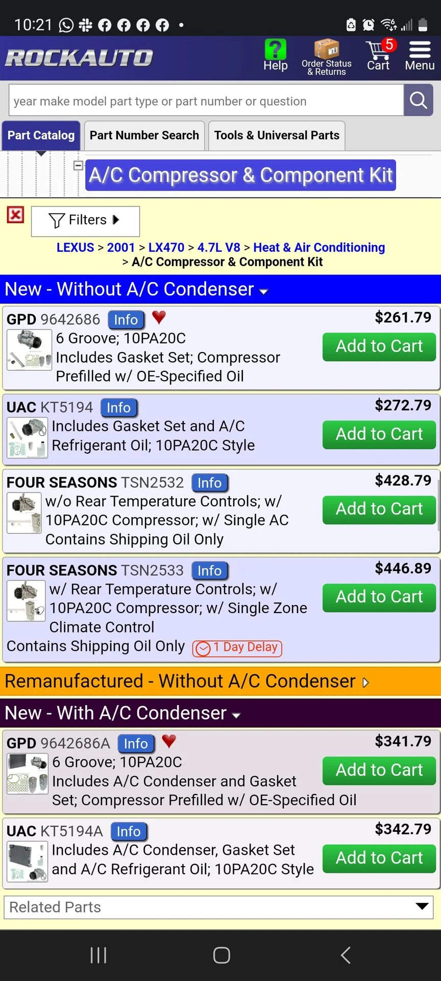

I'm thinking to pull the trigger on the compressor but it seems some of them aren't for front and rear ac. I'm planning to keep the rear intact.
