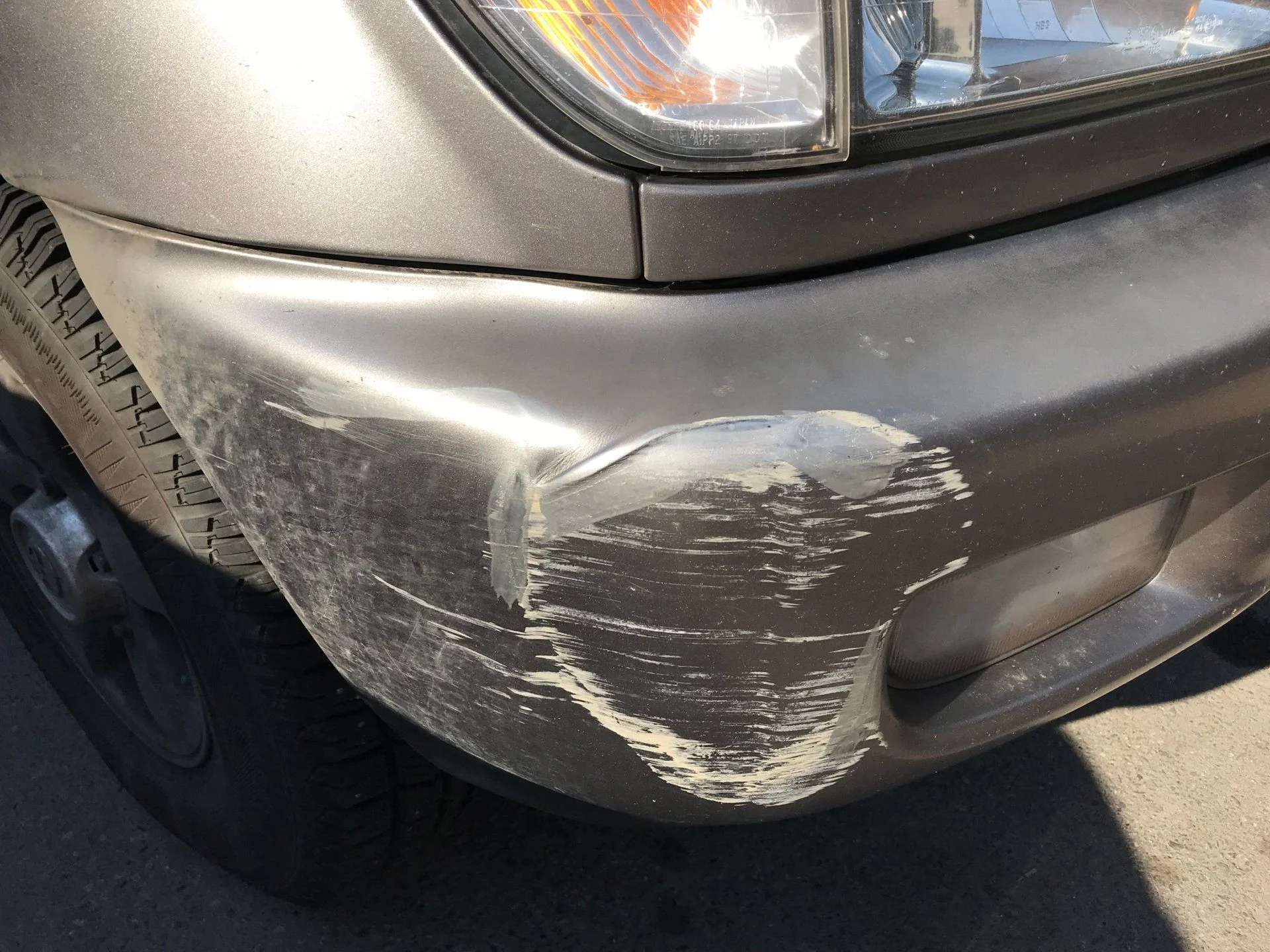

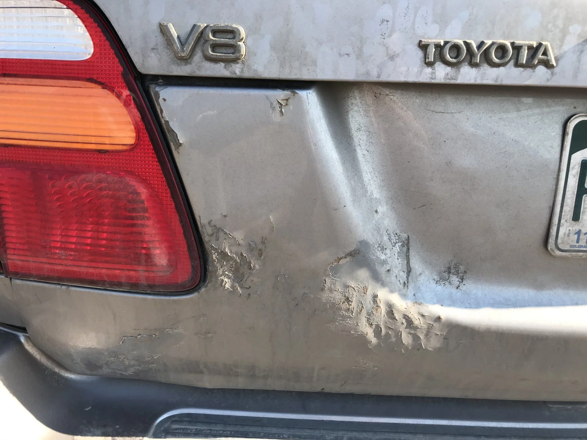

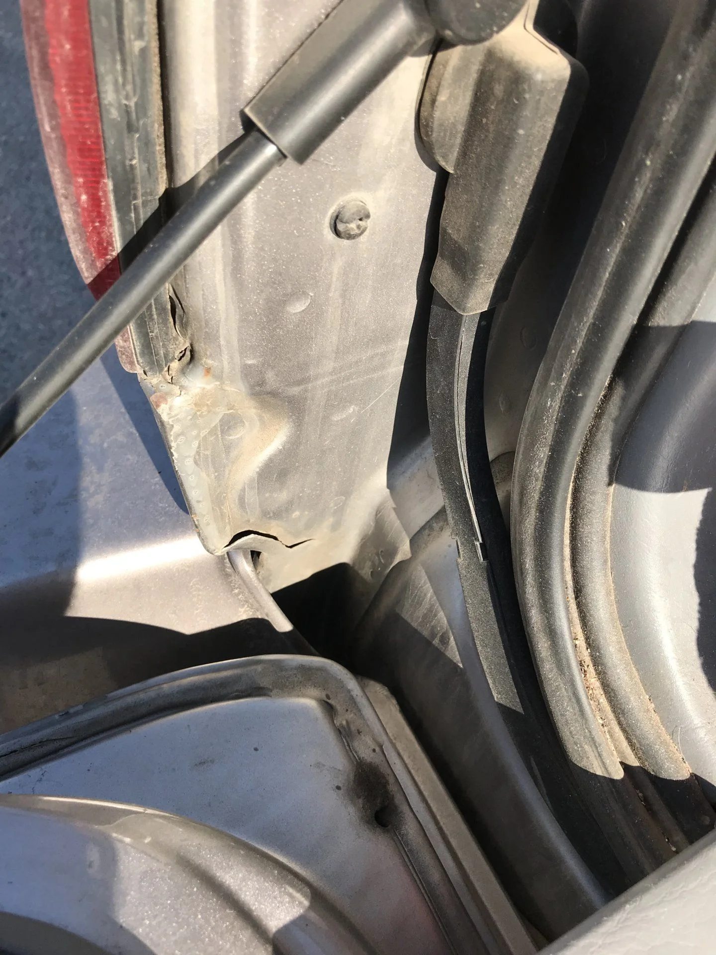

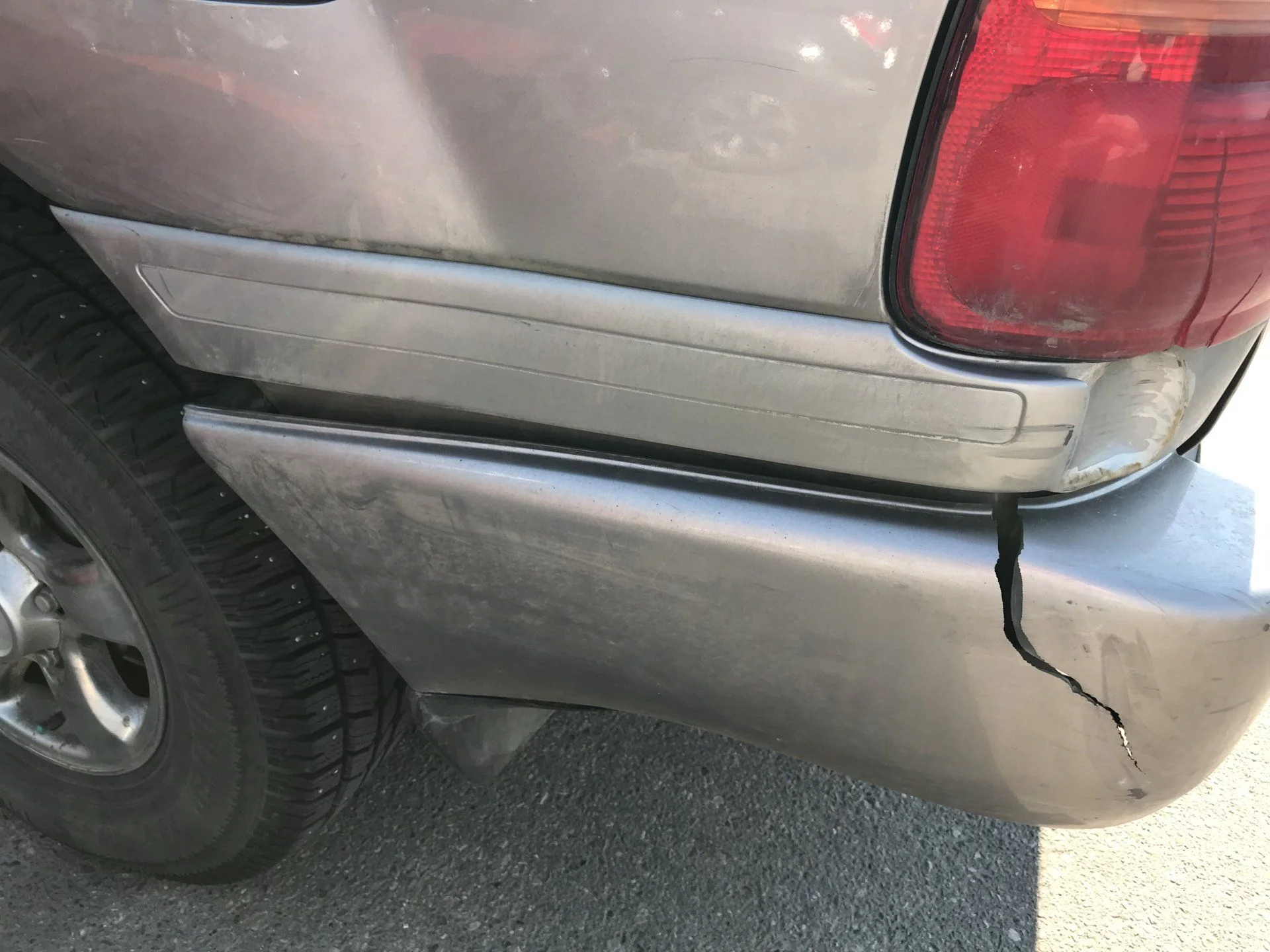

This 2001 LC has low miles at 121k, but PO before current owner really banged it up. Asking price is $8500 and I don't think they'll budge on price. Wondering if it's worth taking to mechanic and purchasing if it checks out? Test drove last week..brakes shudder when applied...so probably need attention. Serp belt looks relatively new. Engine cover has a crack (how does that happen?!). Current owners have put ~20k on in last 18 months..mostly highway miles. Needs a good cleaning. Seats in decent shape..tear on seam in passenger front seatIf it's mainly cosmetic issues, wondering how much I'd be out replacing: front and rear bumpers and lower rear tailgate. Or too much hassle to match paint and repair? Maybe spend 2x to get one in better nick? Long-time lurker, first time poster. Thanks in advance for advice!

Brake shaking is probably warped rotors, or could be pistons sticking and not applying even pressure. Not too terribly expensive to replace. Bumpers are cheap, people on Mud give them away after they get metal bumpers, or at the very least, sell them for like $100, so no worries there.
Thanks for the input, FxFormat. It seemed like warped rotors. No leaks. No rust. PO was a kid..I'm guessing careless and clearly reckless (may have inherited from Gramps..). Current owners just deal with condition and use as daily driver.. I'm concerned with getting bumpers and tailgate painted to match.. Just when I'm ready to say no, I think low miles and see what these are going for nationwide..
That cruiser is two toned, you can just get some rattle can that's close to the silver and paint it to match the front and rear and the side trim. Then spend some good money on the Spraymax 2K clear and it's going to be good enough, it's expensive but that clear is as close to automotive quality as you can get.

I guess it really depends on if you want to open up the can of worms and see how much work this thing really needs. That would be a nice project vehicle for a 2nd vehicle to restore and bring back to a nice looking LC. I agree with FX that if the mechanics on it are nice you can find the cosmetic stuff on here even though you really don't 100% know what all needs to be replaced on it. I for sure would ask a lower price. For $8500 there are a few here in Atlanta that are in lots better shape than that one.
