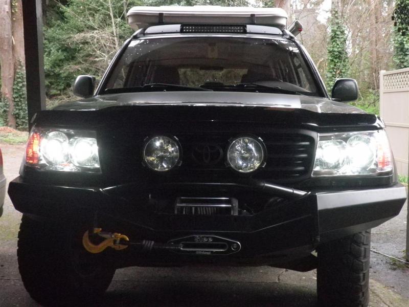

Got the four Morimoto H1s mounted and *mostly* aimed. Went with the graphite shrouds.
The cutoff is sharp and parallel across the four projectors but need to tweak for height. I'll post more after I pull and seal them all the way around. Anyway here's a gratuitous shot or two:
Now we have the same headlights!:popcorn:
graphite shrouds :cool: looks good
Thx. They light up the bowls a bit (which I like) and I used an LED wedge bulb for the marker lamp below the outer projectors and some Vision-X 1157A marker/turn signal lamp replacements.
The Vision-X bulbs freak the system out a bit (double rate blinker) indicating to me that the truck thinks a bulb it out. Later model owners may see a bulb failure indicator thrown.

Thx. They light up the bowls a bit (which I like) and I used an LED wedge bulb for the marker lamp below the outer projectors and some Vision-X 1557A marker/turn signal lamp replacements.
The graphite's are my favorite shroud for the Mini's. Throw a CCFL behind them and they look sharp (I'm not a CCFL guy btw). You need to add a resistor to the blinker to get proper flashing, hyper flash can ruin a blinker relay over time.
