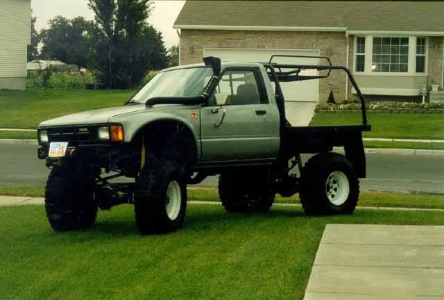

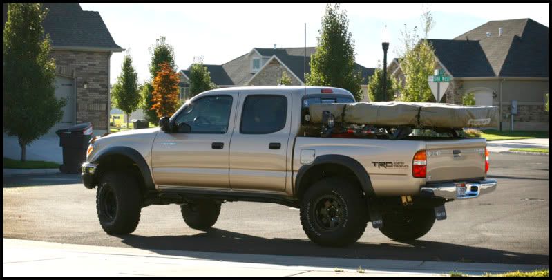

Just because I'm a photo junkie......and since it might give you some ideas, here's a few pics of my trucks of those eras.
My '03 Tacoma just before a 1000 mile wheeling trip.

my '85. Obviously had the rust issues with the bed so I removed it and built a flat bed.
