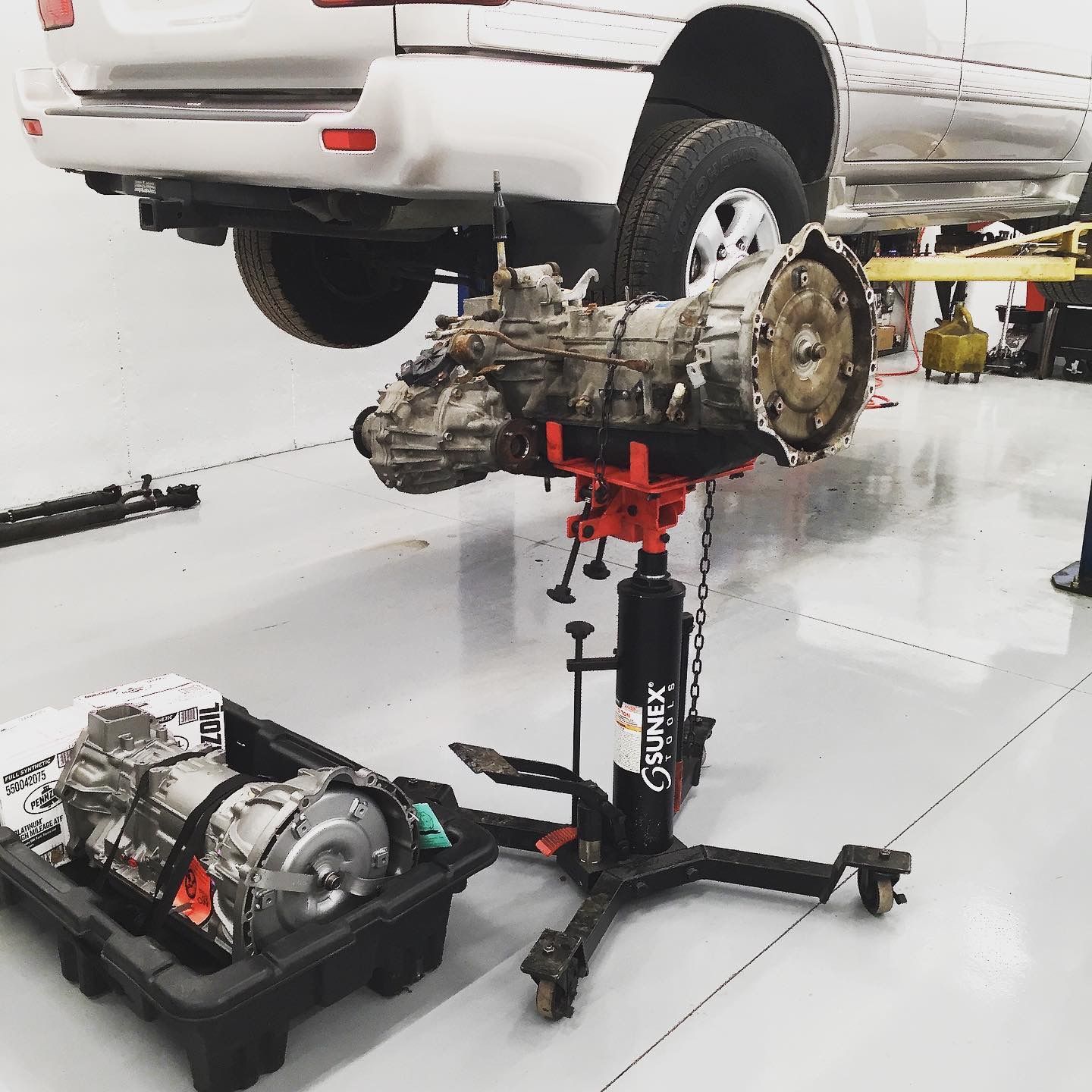

Thought I'd give a quick update with the repair with the reman trans from StreetSmartTransmission. The trans that came seemed very high quality and went in with no issues according to my mechanic. I did have to replace the front sway bar bushings and endlinks which were in poor condition upon removal.

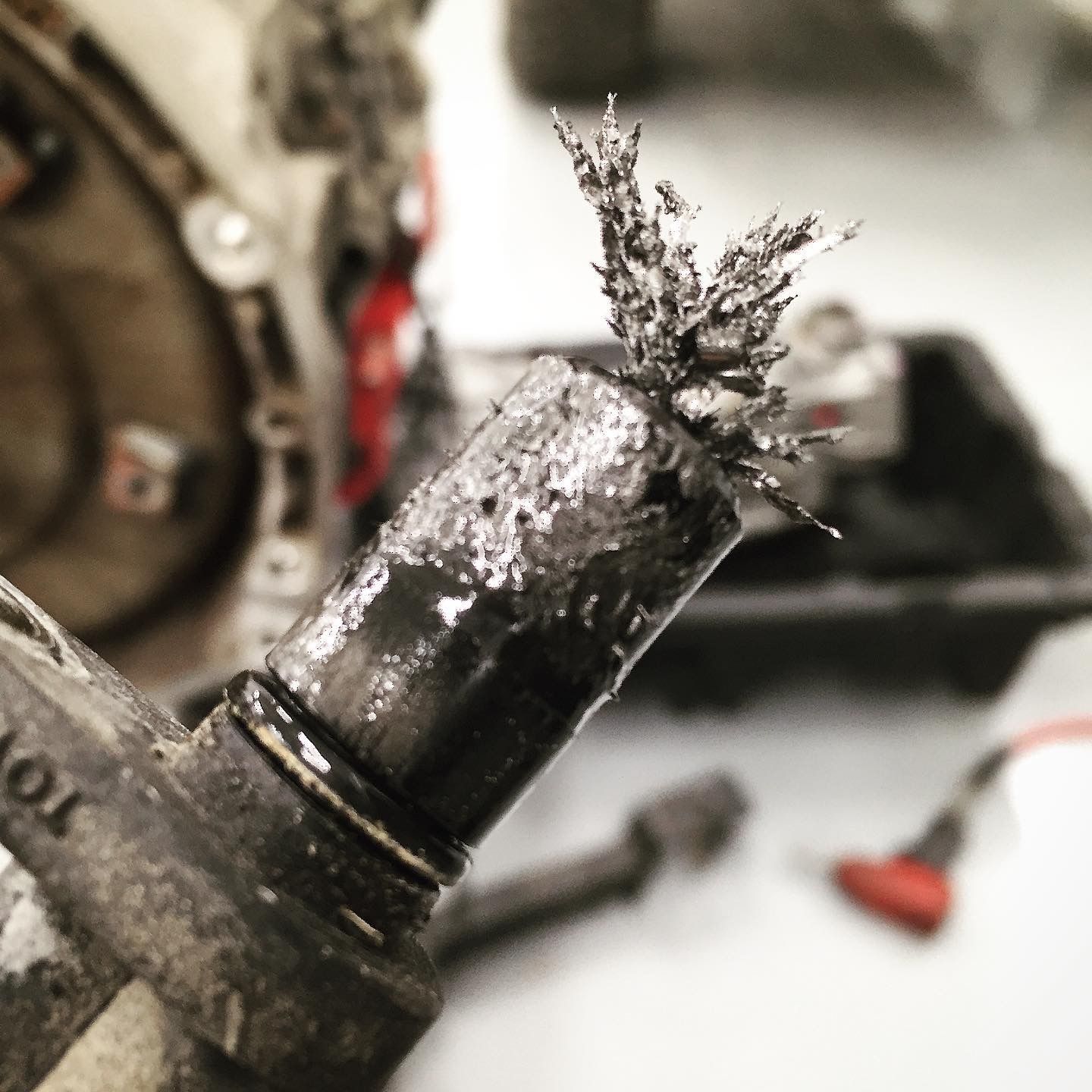

Dealer diagnosed the original unit as a total failure. By the time it got to my indy mechanic for the swap it had no forward or reverse gears. The speed sensor magnet was full of metal shavings:
