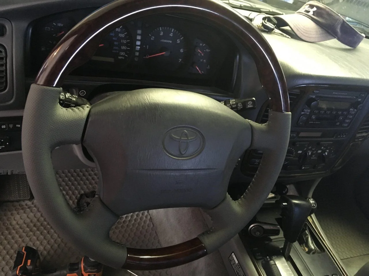

I bought the $300 wood/leather wheel. It's better made than the $200 one. I think it's worth stepping up to the better leather on the more expensive one, IMHO. I'm going to put mine on this Sunday. I'll post before and afters.
Got it done. Looks good.

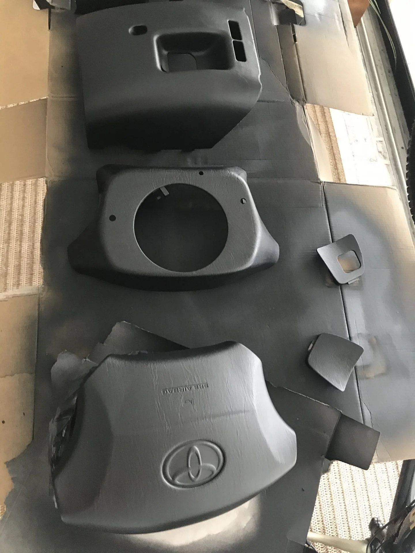

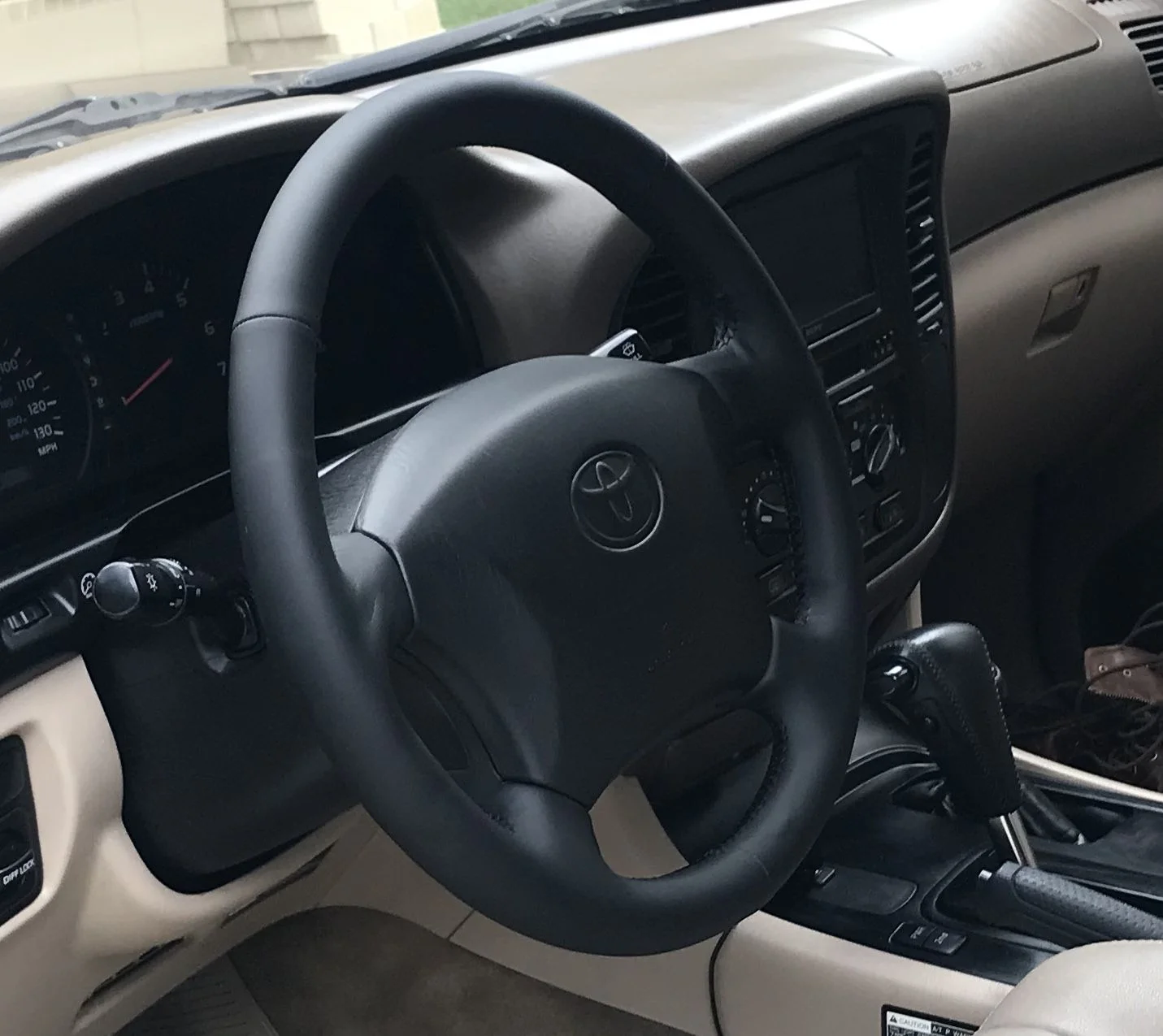

Not satisfied with the brown leather re-wrap kits I opted last minute to color change the plastics and airbag cover along with wheel to black.
looks nice though. Thanks to Stephen McMurdie for selling me a replacement wheel. This means I’ll have a spare refurbished wheel to sell soon. IM me if you need one.

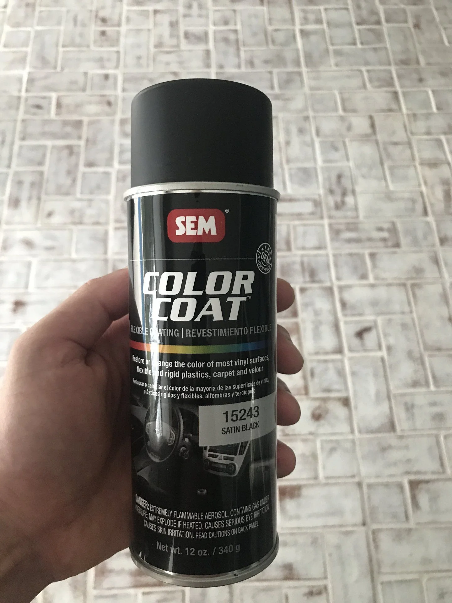

This worked really well, however i did need some coats of satin clear to protect the final finish. I did get a couple minor scratches from a heavy Stanley cup hitting the plastics.You might consider a 2k clear for extra protection.

I was most worried about the airbag, but that has held up really well the plastic next to the ignition got scratched and so I redid it one time with more coats and some clear over it to protect everything.
You only need the SEM paint on the airbag. But on the hard plastic, you might consider going over those with a 2K clear.
