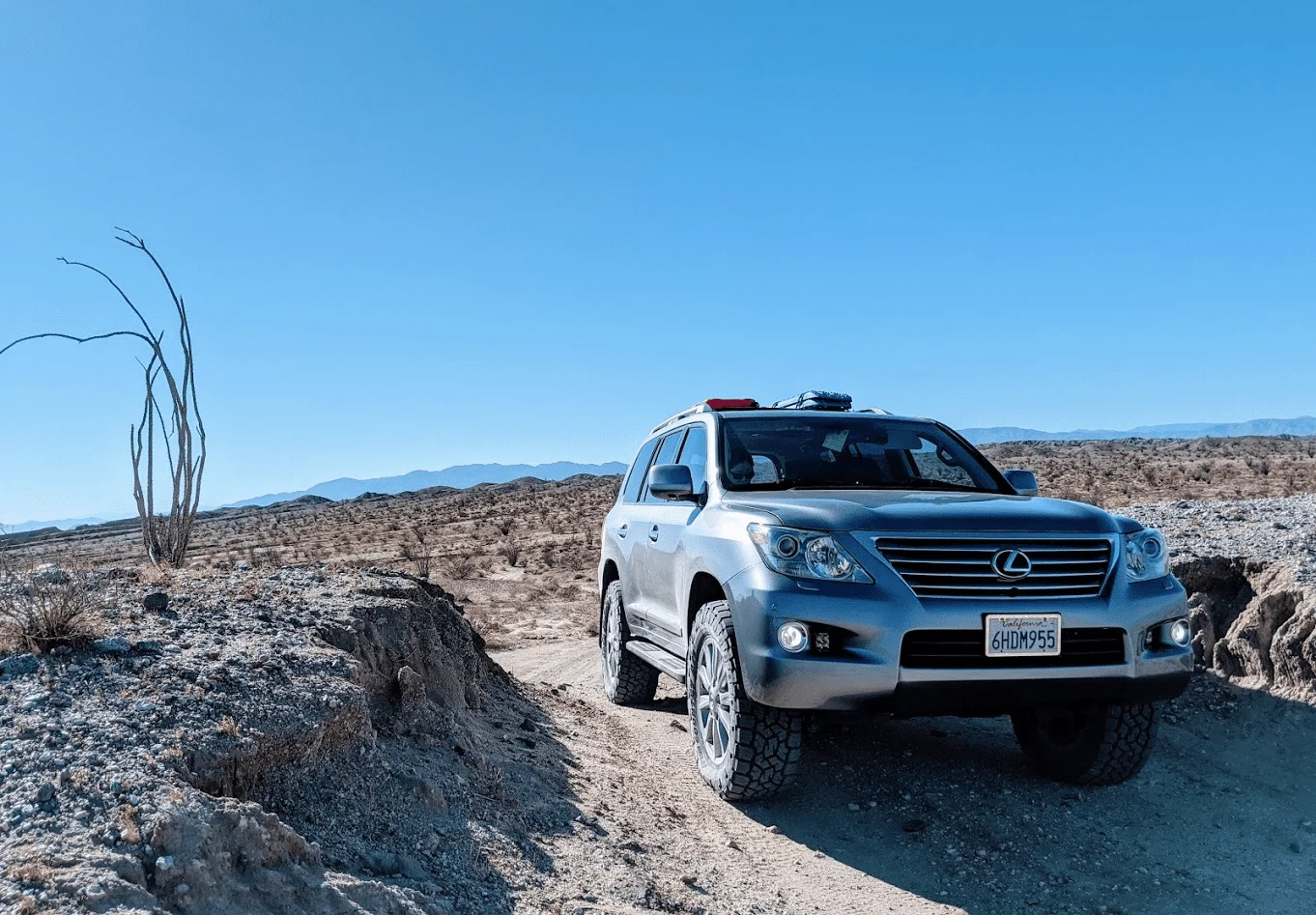

Goodyear MTR 275/80r17 (34.6”) on Rock Warriors. Fits 2010 LX570 with Total Chaos UCA. Removed mud flaps and drew front fender liner forward/heatgun. Does NOT fit in spare tire underneath.
No rubbing and they rock offroad
Edited to clarify - no rubbing means no rubbing anywhere with the shock removed, full bump, lock to lock
