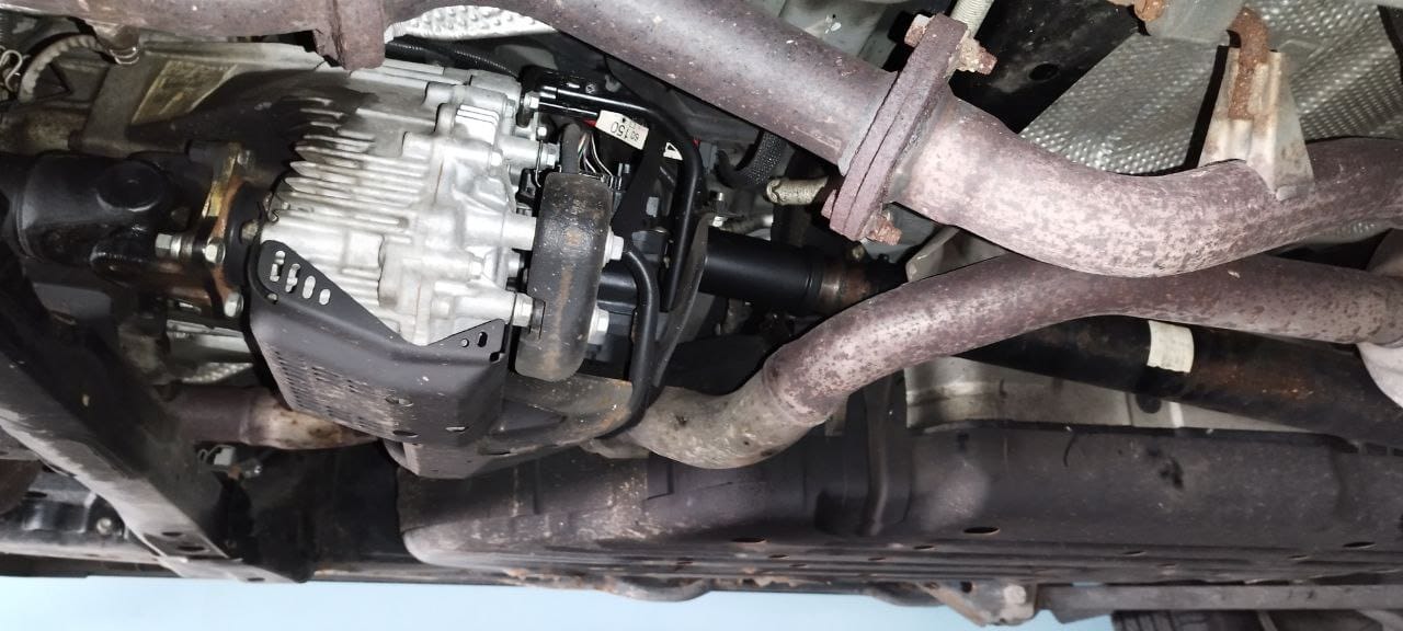

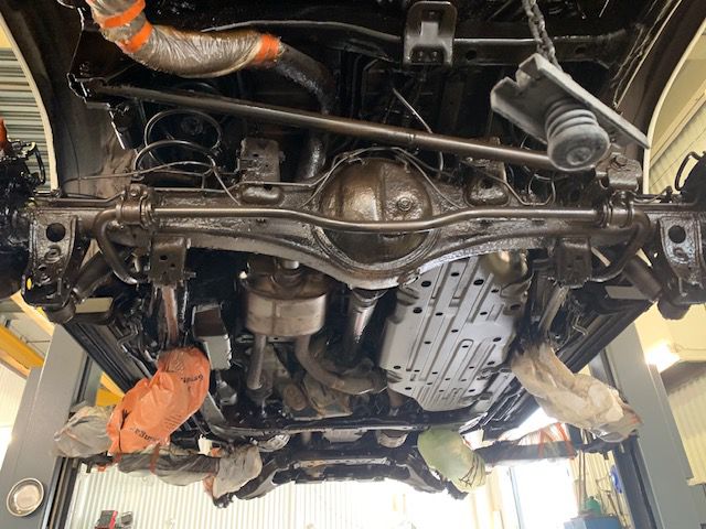

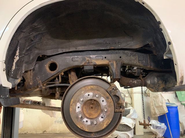

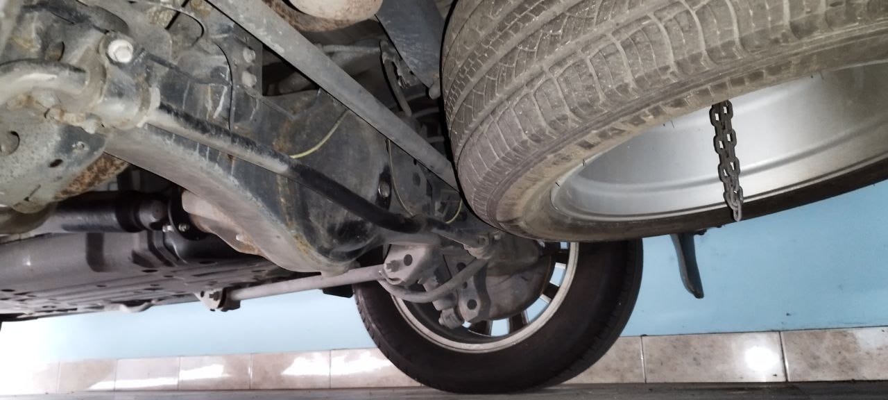

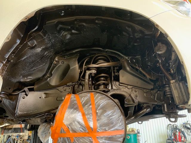

So it's a car in EU I am considering buying. Do you think the rust was too much before? Should I look for another option?
It's not too much rust to operate, but if you have a less rusty option available, it will be much easier to work on. With that much rust, you will be breaking any bolts that you may choose to remove...working on rusty rigs is a pain in the *ss. It's good that it has been treated, but it will still be a major pain to remove any bolts down there. If body rust materializes, that's a whole other can of worms.
I'd pass, if you can find a similar deal without as much "iron-oxide patina".
Not the worst, but I would try to find a better example. I think the before photos might actually make it look better than it really was...
