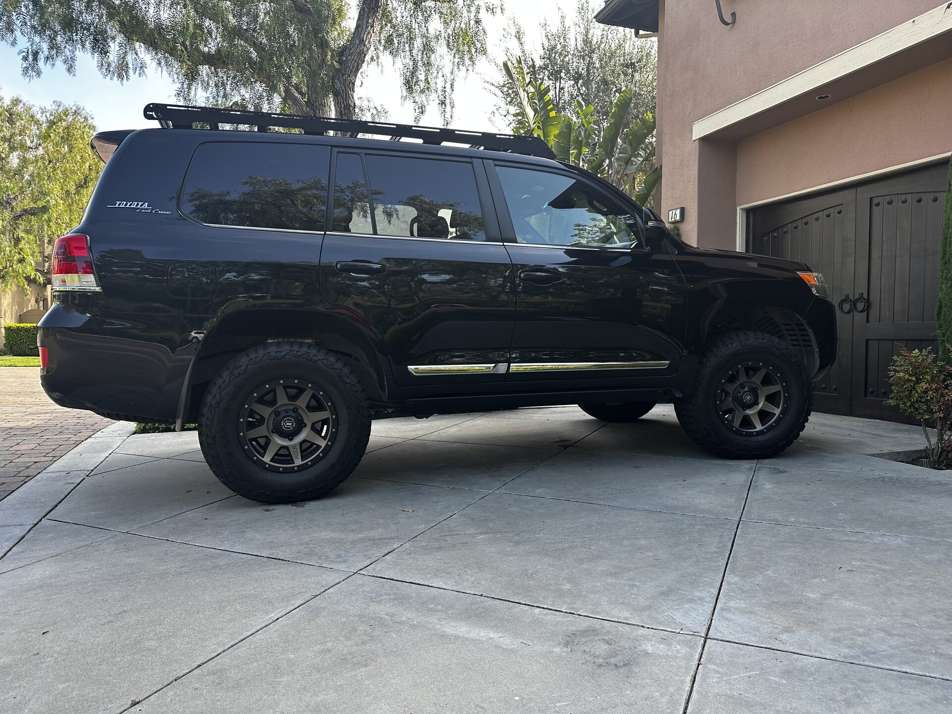

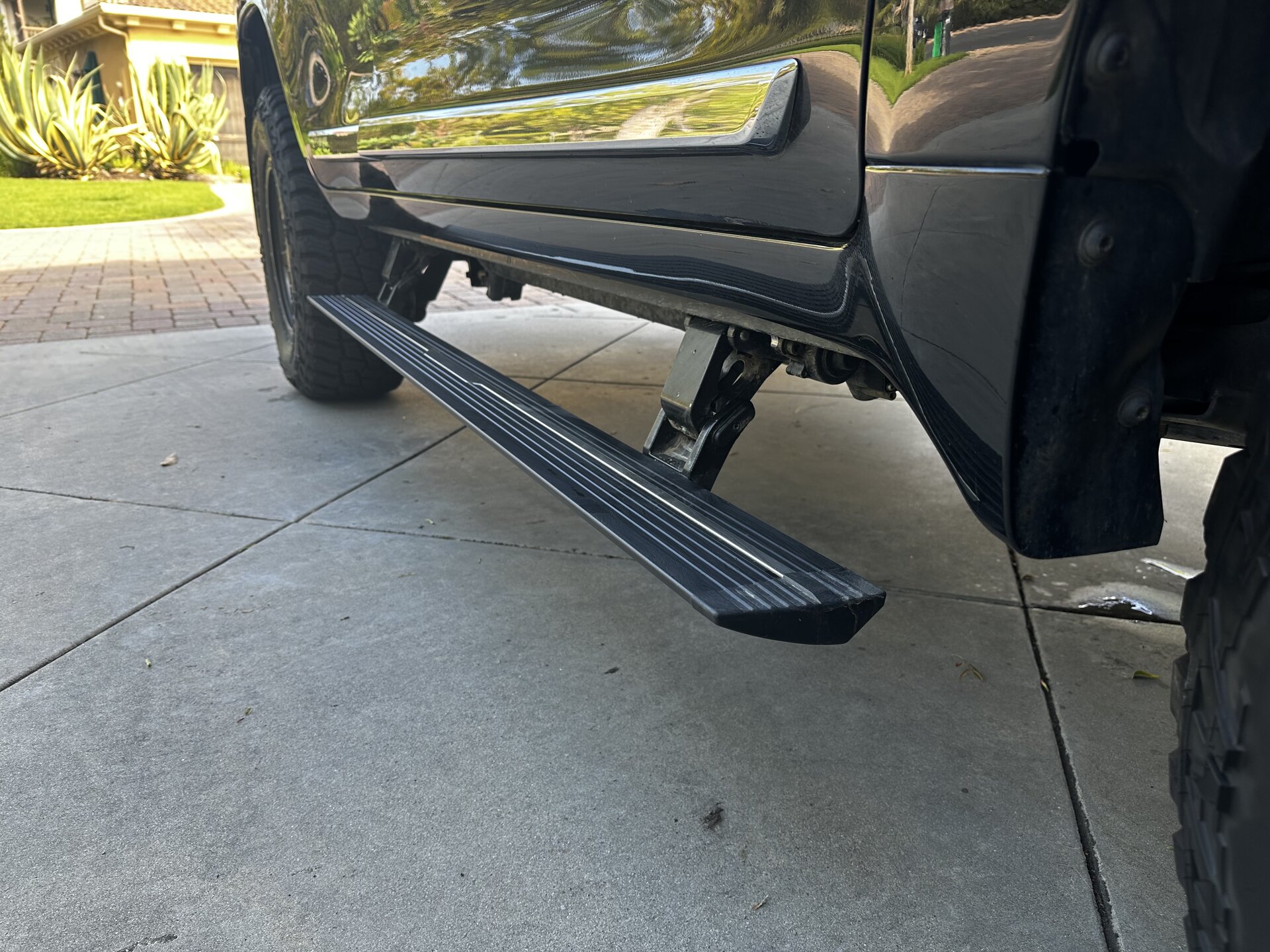

My wife kept complaining about the step up on the lifted 200 so I went on a search for step options. Unfortunately our market is not big enough for companies like poweramp to import steps so I tried shipping from Australia… they wanted close to 4K! My next thought was to go straight to the manufacturers in China and see if they would sell directly which was harder than I thought. They want you to buy in the thousands to ship them over!

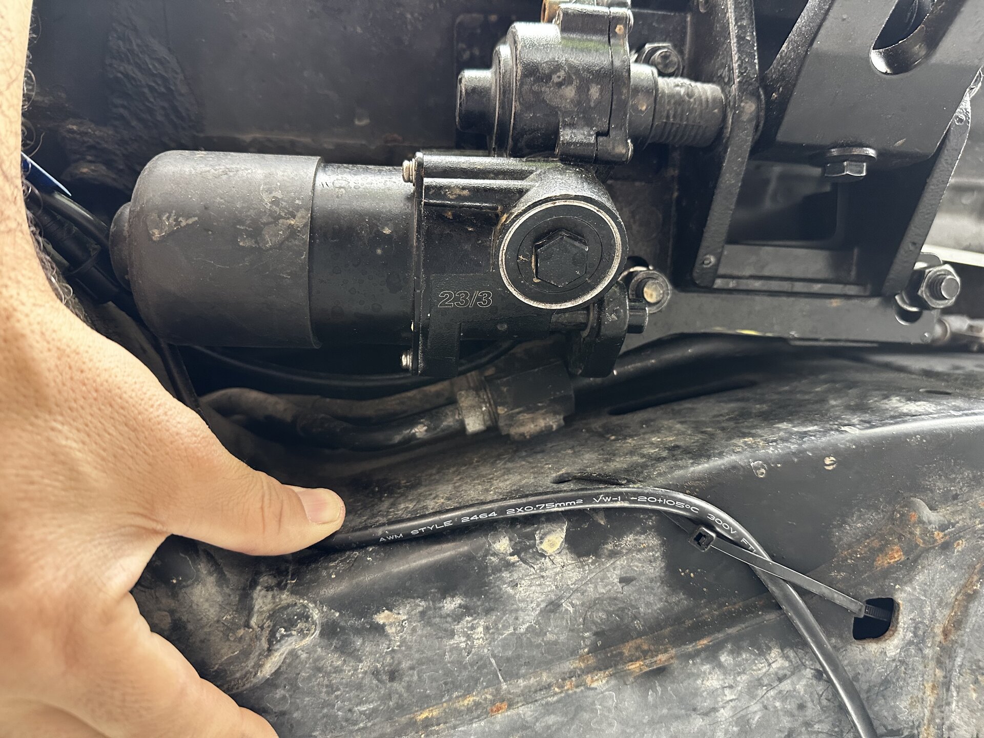

Anyway, I finally found one I liked that would play ball and send me a single unit to test out. So far, I’m really impressed. I had some wiring issues at first but they actually were very responsive. I also had to modify the mounts to work with our KDSS. So far they’ve only seen a ton of rain but not mud and sand yet. Once I put them through their paces I’ll update this for anyone that might be interested in getting a set. They’ll give my significantly cheaper shipping if I order 6 so maybe we can figure out a group buy.
Here’s some pics in the meantime
Just keep the one side🤐😜

100% interested, I would love if you could get me a pic of them open and closed from underside.
If this can close over the AHC tubing, and somewhat protect the globes, I'm totally in.

I meant AHC not KDSS! Sorry my brain is all over the place because I've also been looking into wheel/tire options since I'm not really liking the new 33" Mickey Thompsons I got. It clears but I had to modify the mounting plates. I would try to have the manufacturer update these for an order but I'm guessing it won't be enough orders for them to change. If that's the case I can modify and paint them prior to shipping out to everyone. It's only the drivers front that need to be dremeled a bit.

Wiring shouldn't be a problem. We just have to tap into 2 wires. I didn't use they obd2 dongle either. It's cleaner to wire directly.
