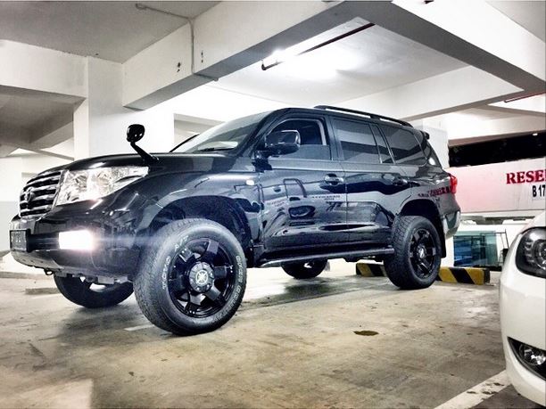

INSTALLED THE OME LIFT KIT SPORT
any idea why it rides so firm and a little harsh?
is it because the "sport"?
nevertheless it look so much better
how it looks like previously and on the yellow wrap :)
