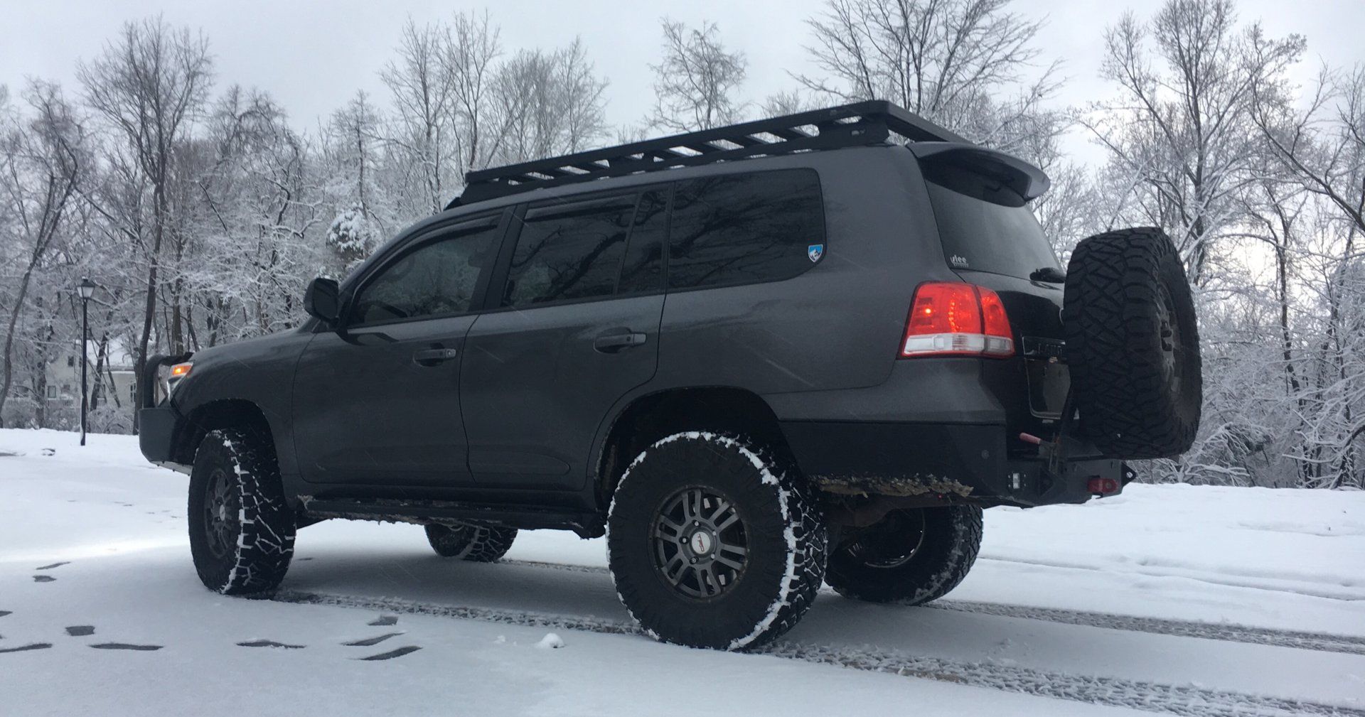

Glamour shots in the little snow we received last night.

What lift and tire size are you running?
No spacers. OME BP-51 lift at 3" Tires are a fuzz under 34"... 285-70-R18. A Slee sway bar relocation bracket was added. It's maybe 5/8" thick. There was some concern about having some scrub at full lock but so far I haven't had any rubbing. Tires fit nicely into the wheel wells and look appropriately sized IMO. So far we've only done some light off roading, still wearing the brand new off. For sure the capability has gone way up. I'm happy with the results thus far. Like I said, as the newness wears off I'll get braver wheeling harder in an 80K rig.Looks great! Specs please! Are you running spacers on your OEM wheels? What size tires?
