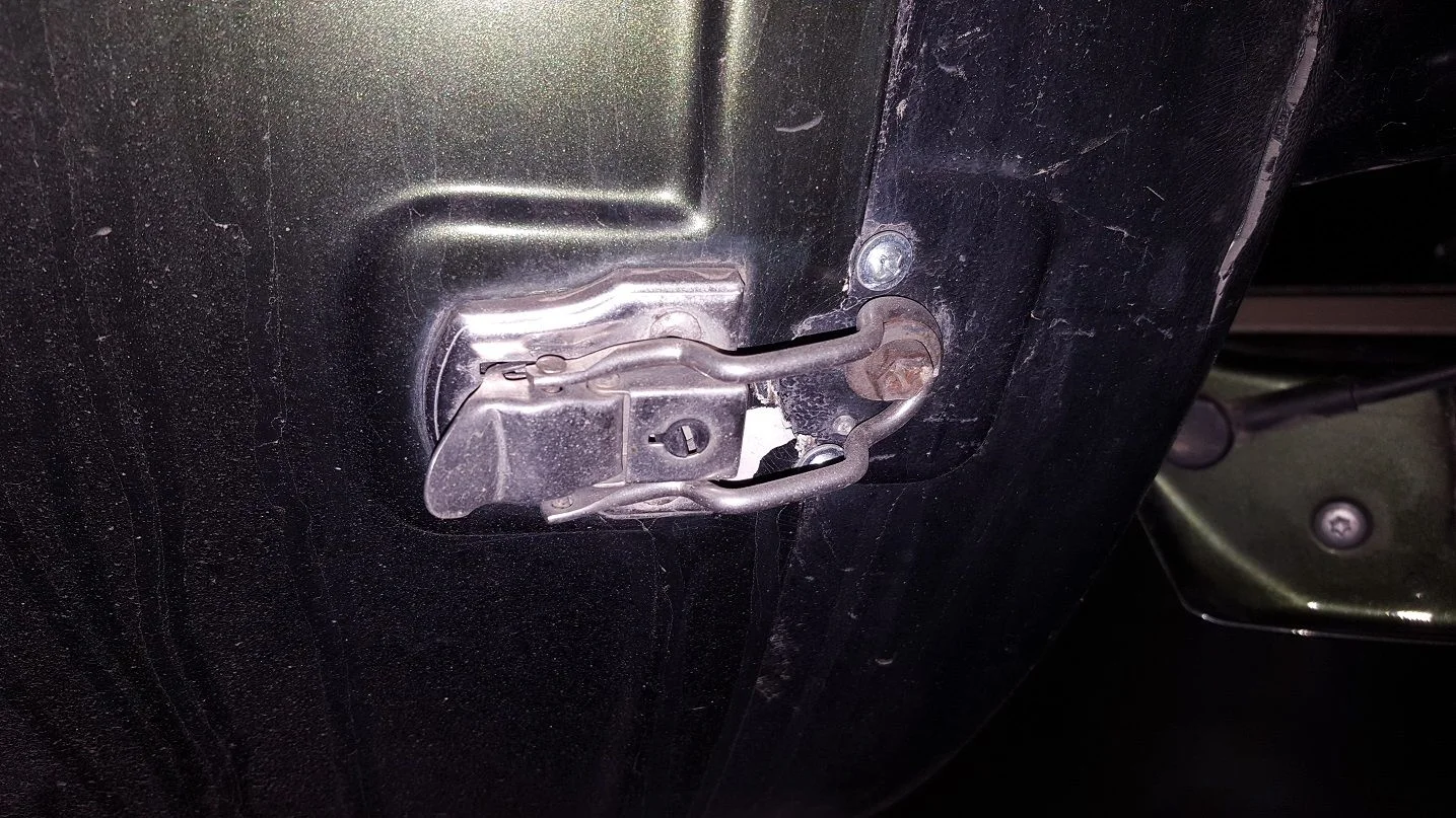

Forgot You key to rear spare cover? No worries, Ahmed to the rescue!!

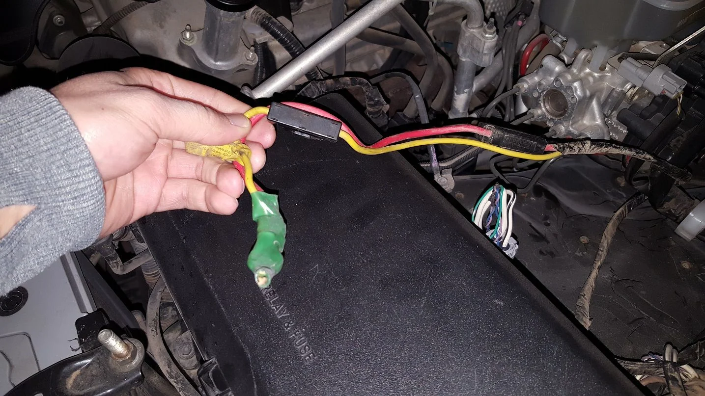

No 4 (linked with 5 and 6):
Ahmed removed front bumper for some purpose, probably because of some minor damage to it. When reinstalling the bumper, he forgot to connect one important plug on the middle of bumper - that`s right - FOG LIGHTS! So what he did was - he made an extra wiring loom straight from low beam to fog lights. So they were on all the time after I turned the knob for lights. Don`t mention the wiring - and the quality of it. He surely thought about safety - fuses were installed!!
I`ve removed the wiring and connected the plug. 1/2 day labor.

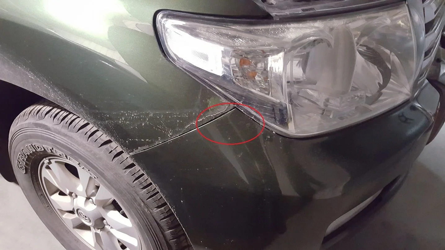

No 5:
When the bumper was removed something went wrong and some bumper sliders were broken.
Rivets to the rescue! OEM paint on them to the rescue too!! For now on bumper is unremovable... :/

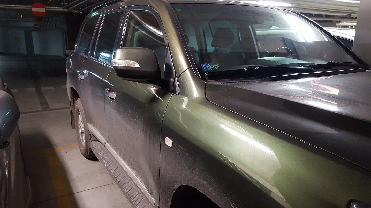

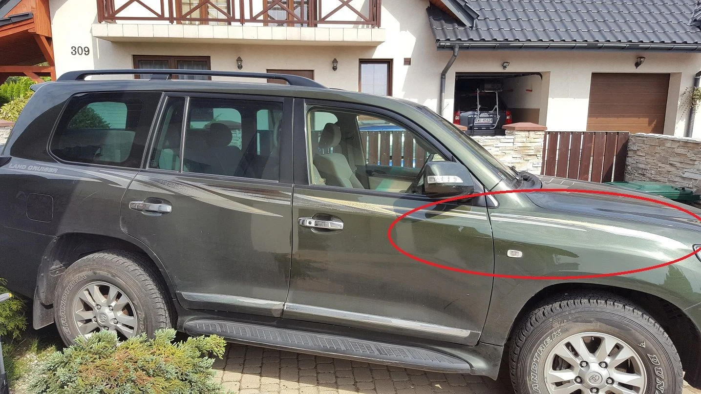

See these decals on front fender and passenger door? They were spray painted with clear coat - probably during some minor damage removal. Unfortunately for me - I wanted to remove all these burnt by sun decals - beacuse they looked like crap.
So it took me 1 and 1/2 day labor, 3 wheels of 3m eraser tool and a lot of lacquer thinner.
Then car went to be resprayed and now looks a lot better. :)

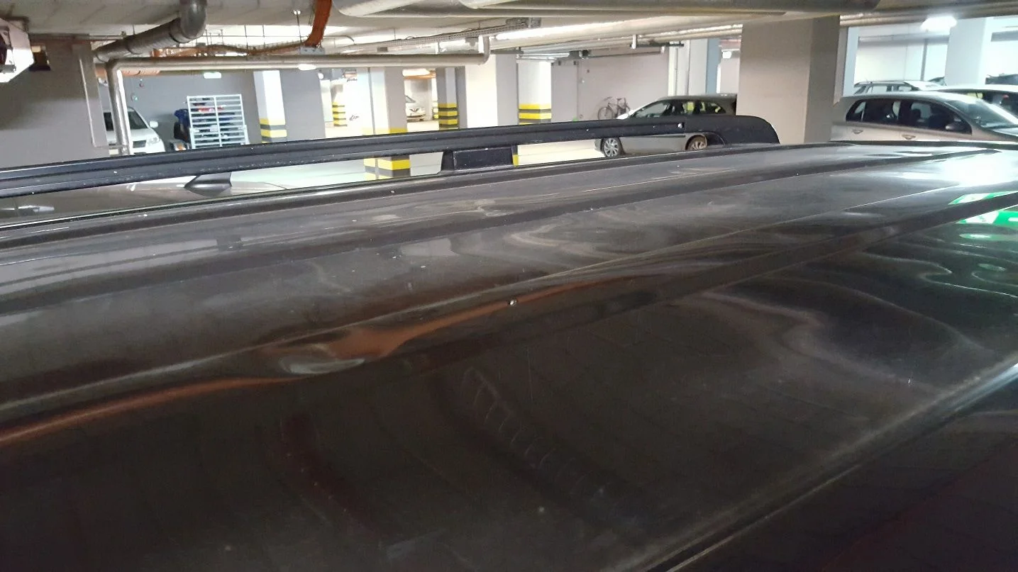

No 7:
And finally - roof party. Probably with friends or some wild animals.
Damage still not removed. Fortunately it`s behind my eyesight, so it`s not so annoying... :)
