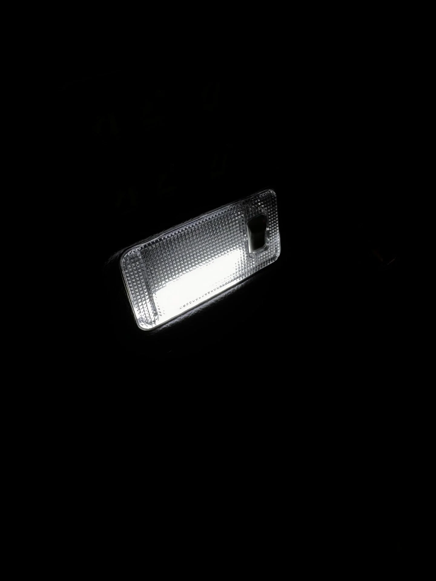

Trying to just make it work, but as you can see the LED panel doesn’t fit when in the clear shield.
Had to go without the gray plastic housing ans rhe LED square won’t fit inside the clear housing with the plastic piece on. In this setup, only two bars of visible light. Looks pretty awful compared to how nice the front and center row lights look.

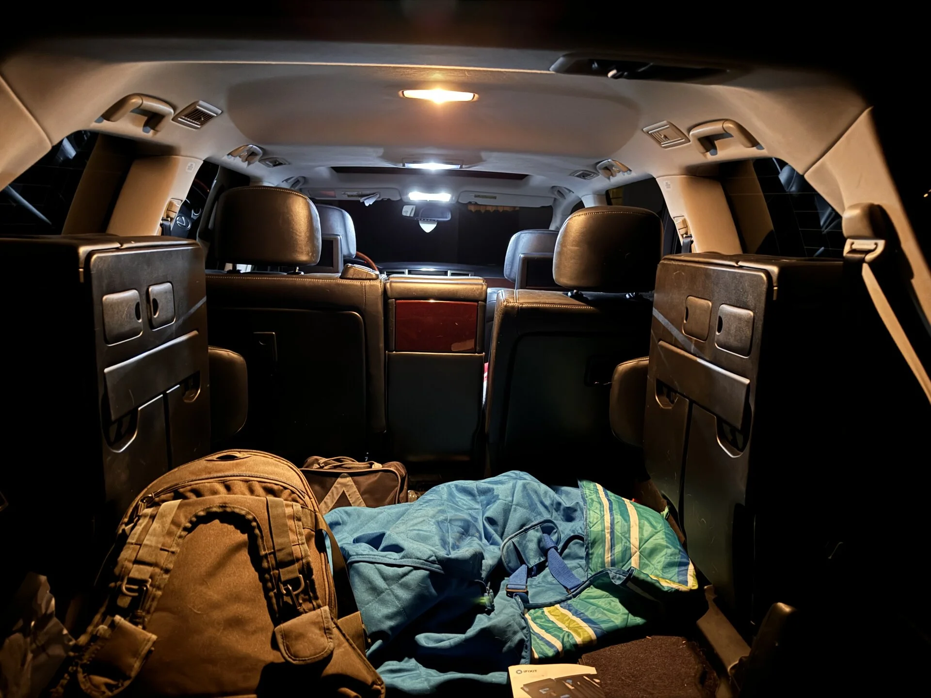

Here is what I’ve accomplished. Defeated. Yellow incandescent bulb is the same brightness as the new bulbs after everything.
Looks better in the white though so definitely happy with that. Someone said the cargo is the significant brightness change so I hope I can find a solution.

Now that I’m seeing this, are you trying to put the upper cargo light into the rear lower cargo housing?
the upper rear cargo light should be a panel and then the rear light is a smaller panel. If you only got one panel, then you probably got the wrong kit.

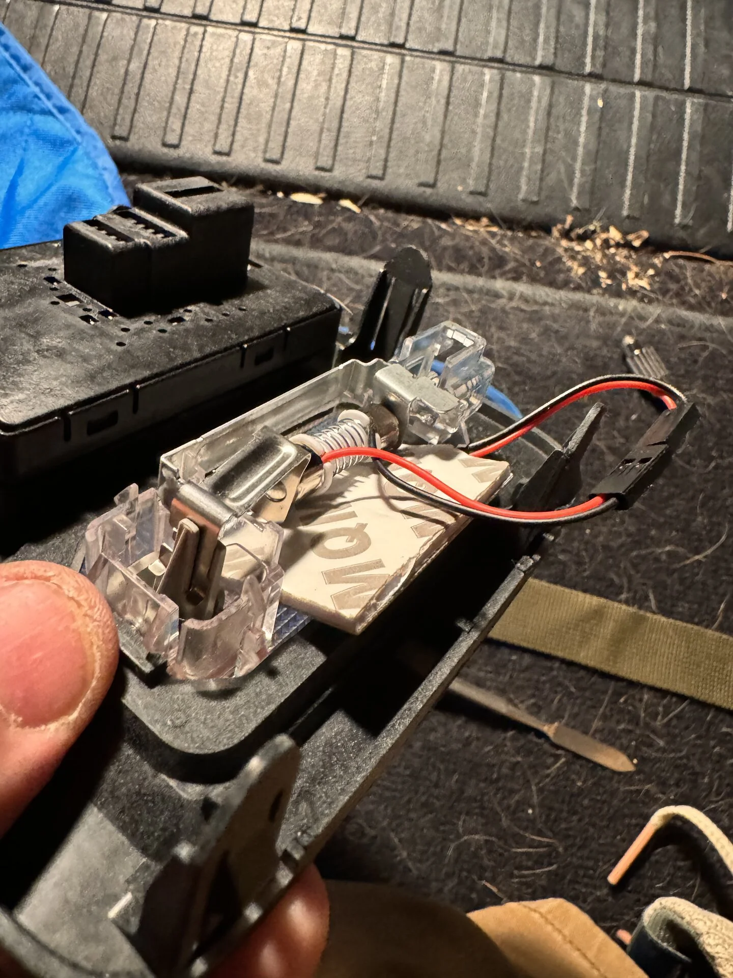

I struggled with that lower cargo light. Somehow I mangled the metal enough to hold the led bulb. The solution suggested for that spot is hit or miss. I am going to find a different led fixture and solder it in if bulb pops out again.

I'm wondering if I got the wrong part as my LED panel can only show 2 rows of LEDs where everyone elses' seems to be 3 rows visible. Furthermore, someone said their cargo dome light was also an LED panel? Was yours an LED panel?
The panel you are trying to put into the rear lower cargo light is the panel that should be going into your upper dome light. The panel you are missing in your kit is the one for the rear lower light, that is why it doesn't fit. This should also help with your complaint that the bulb you put in there wasn't very bright. The panel is much brighter than one of the normal bulbs.

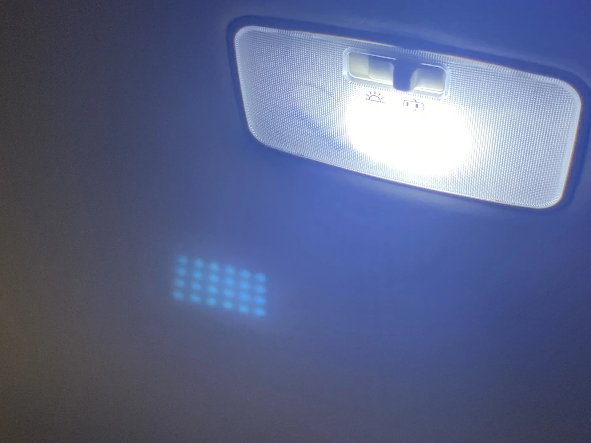

I couldn't get the picture to dim enough to show the matrix, but the set of boxes in the glare under the light in this picture is the LEDs.
So I was wondering that, but I couldn't figure out how to get the LED panel into there. So how do you get that panel into that light you have pictured? Did you take apart the clear plastic shield? This would be a game changer for brightness for sure if I can find a way to get the panel into the the housing.
When I removed the whole light housing (Frame and all) to get to the bulb, I tried to put the panel in, but the whole way smaller and would require bending the LED panel to fit in (and possibly break).

Prett sure the cover pops off.
