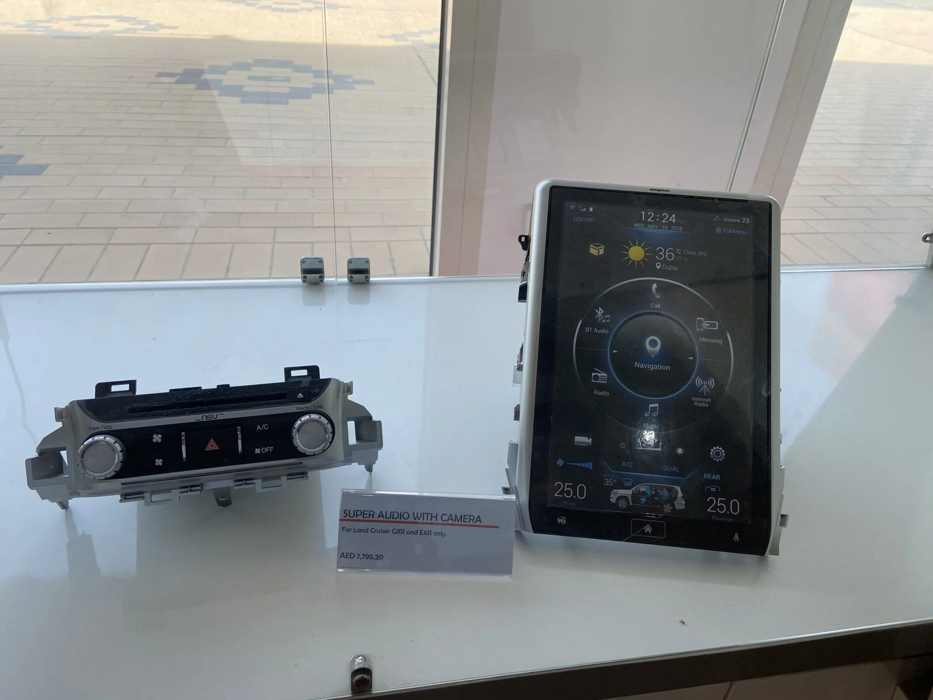

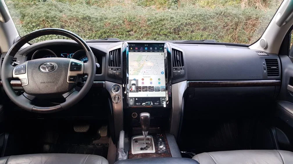

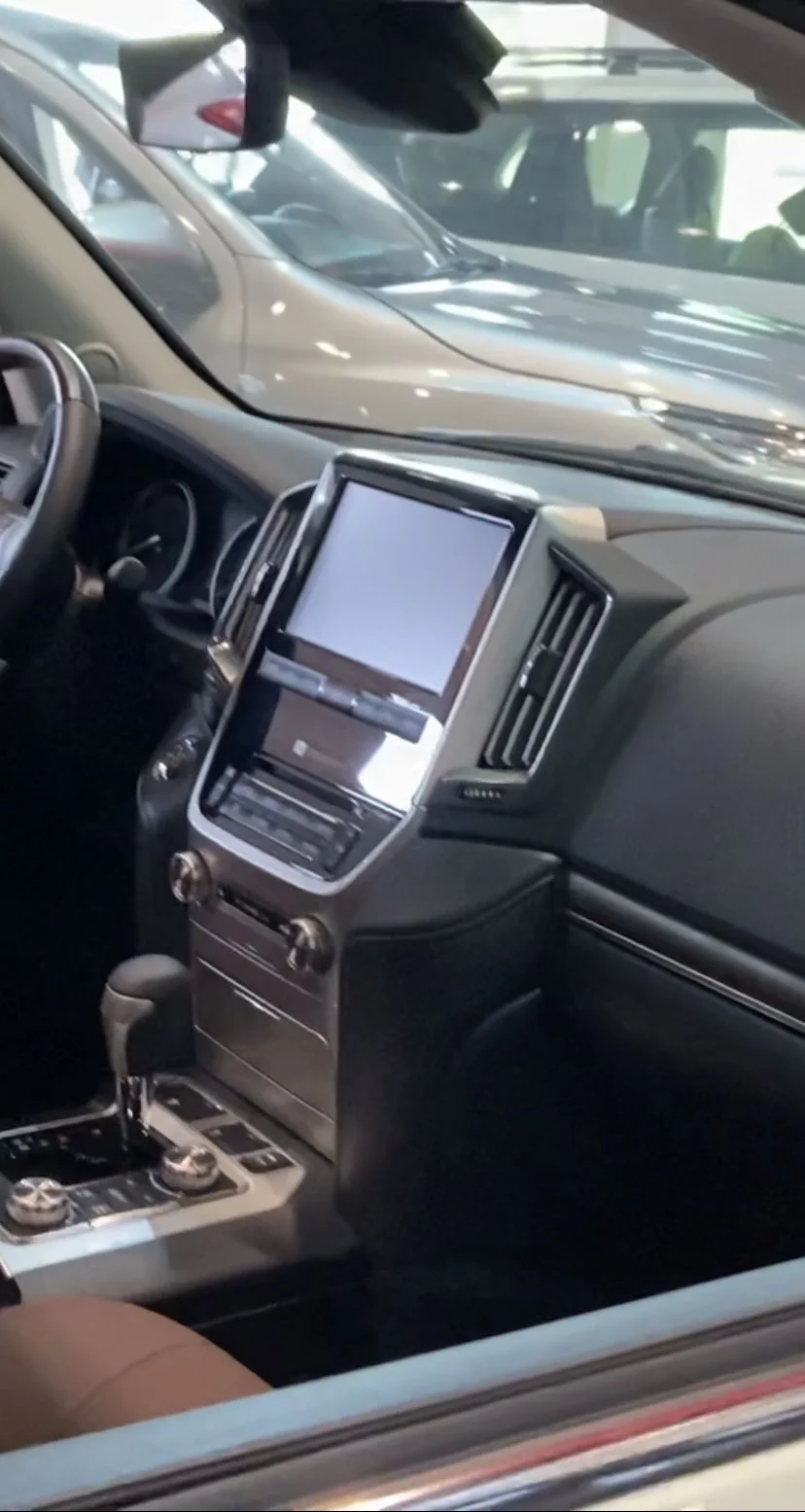

I wonder if this OEM screen would work. Dealer here in Abu Dhabi, says it fits their GXR and EXR models. Believe the VXR is their rop of the line model here, so it may be compatabile with a US spec version.
Second photo is a 2020 VXR center console.
