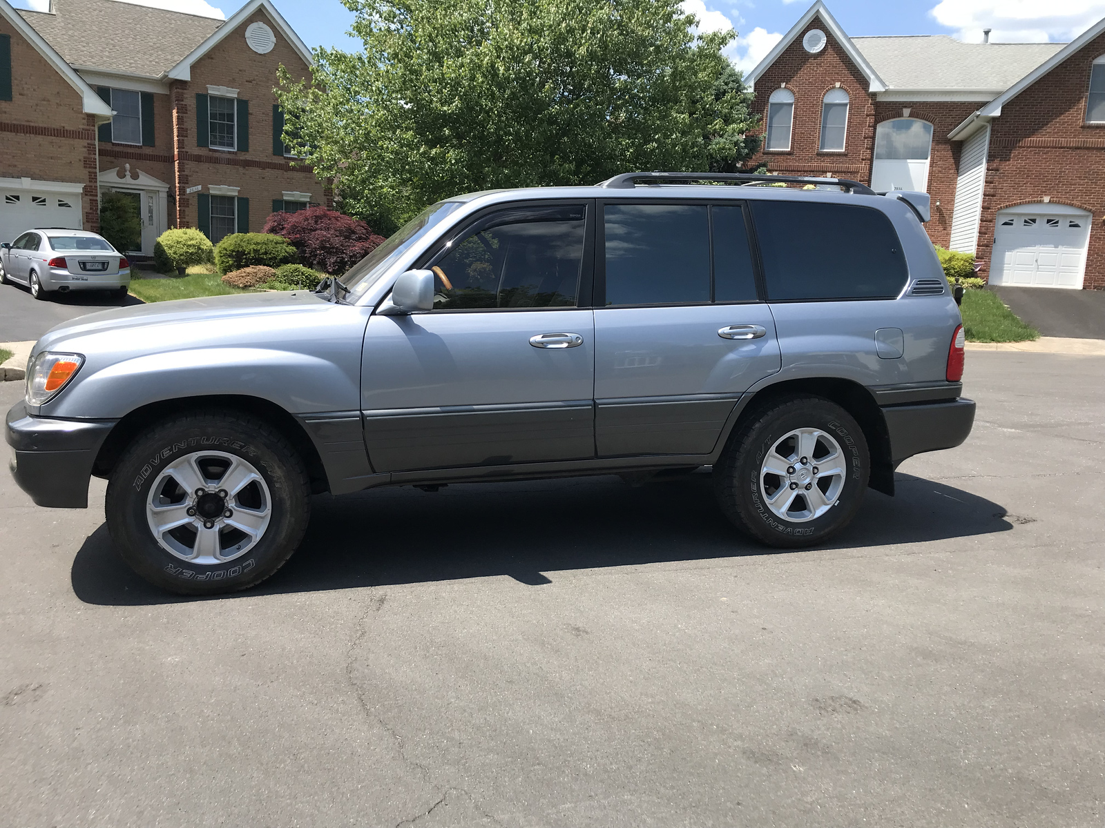

2000 LX470. Bought a fresh set of stock silver 16’s last summer when I bought it, then 2 different sets of tires since.
Thanks to a local IH8 forum member, now have a set of (5) 2014 LX570 20’s, installed yesterday. Went in expecting to need front wheel spacers due to the older big hubs, but no, everything fit perfectly center caps included. Looks great. 15 years fresher. And rides great.
