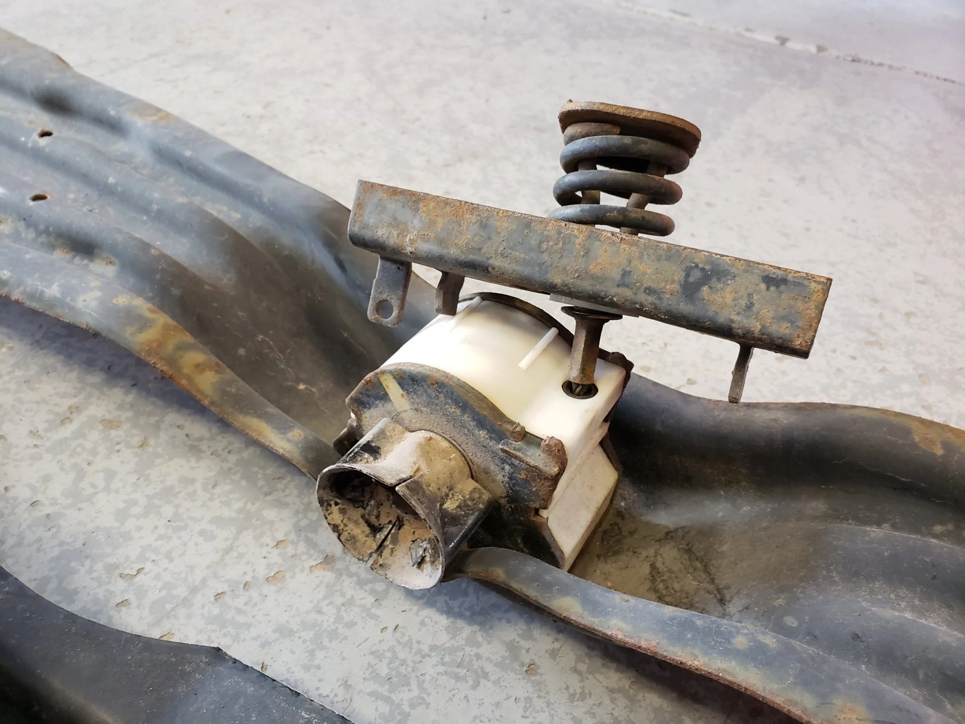

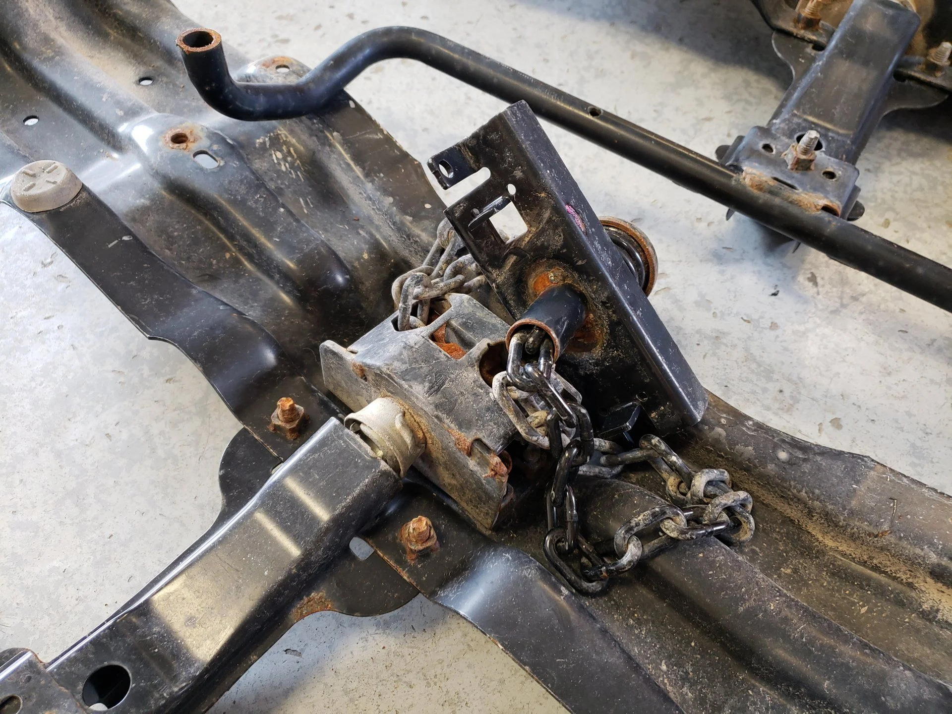

Are guys in the eastern rusty climates seeing these seize up like the 100 Series variants did/do? The 200's use an "open" design with a chain link hoist that lets debris and perhaps most importantly salt be washed out whereas the 100 has a cable hoist that has a plastic cover that let's them get packed full of junk. I've got a pile of 200 cross-members and hoists here left over from aux tank and rear bumper installs and they all function smoothly. Yet it seems every other 100 one we pull off is seized or a PITA to operate. Is it a design "upgrade" or simply age based? On that note, anyone have a need for some 200 crossmembers/winches before I offer them to the 100 guys to retrofit :D
100 Series cable w/cover
200 Series open chain
I kept my 100 hoist lubed and did not have a problem, despite my midwest address. I know that if neglected (common) those are a pain. I had to cut my 4R chain and R&R the hoist, which is where I learned to lube the 100 (and not to be under the spare when cutting the chain). Great idea to offer to those with frozen hoists! I do of course keep the 200 hoist lubed too.

On the GX470, they originally came with a cable hoist. However, if you go to replace the cable hoist for whatever reason, Lexus will no longer sell the cable as a replacement part. The replacement part is now a chain hoist.

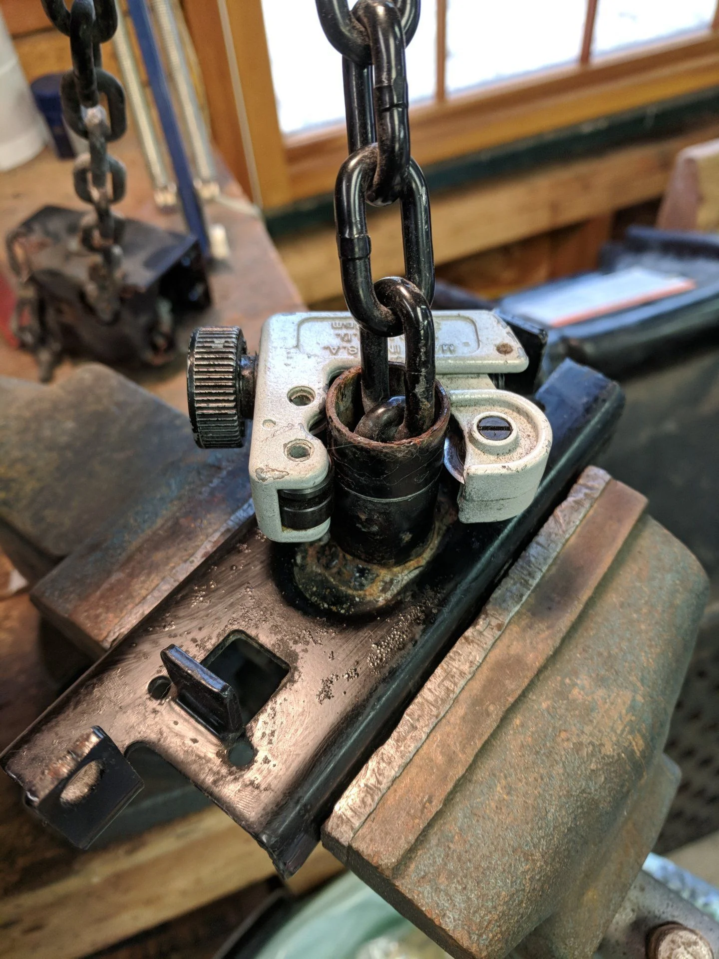

Geez, the modification is super easy. Doesn't seem worth the trouble or expense to get a different one. The hardest part is unbolting it from the crossmember, and you don't actually even need to do that to modify the hanger. Just take a pipe cutter and slice off a bit of the tube, then split and remove.

I understand it's easy... but I don't have a pipe cutter or angle grinder/anything along those lines to cut. So figured if he had one from a newer 200 that has the smaller sleeve it's even easier than getting around to cutting mine.
