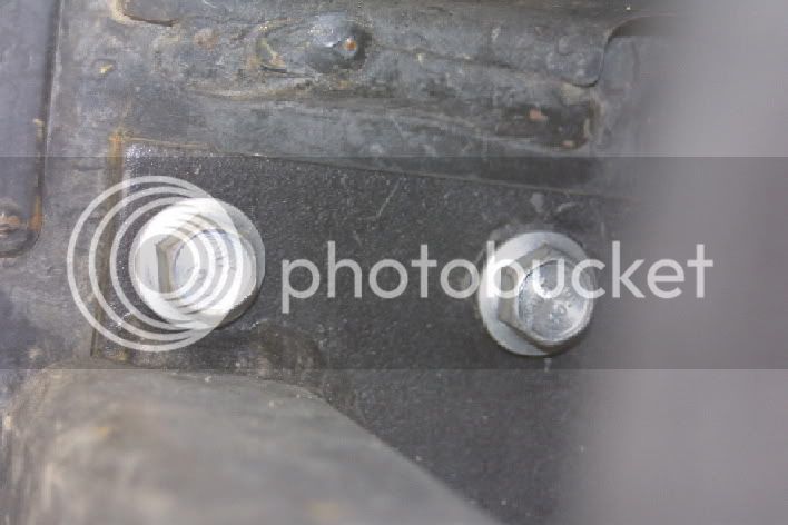

FWIW, I fabbed these sliders for my Xterra back in '03. I cut down on cost and simplified the design by eliminating the main stay, and making the outrigger the main stay. The end result was that they flexed a little bit, but they were lightweight and very effective. I got the steel, which was 2"x4"x3/16" square tubing, plus six base plates at 4"x4"x5/16" for just over $100.00. The base plates were scrap, the steel company had them laying around in stacks for like $0.50 apiece. I didn't have a proper chop saw at the time, so I had them cut there, which cost around $18.00. The welds, as you can see, aren't pretty, but they sure were tough. I finished it off with a couple of cans of Pep Boys spray-on bedliner ($7.00 a can).
The main difference between the Xterra and the Cruiser is the shape of the frame. The Xterra's frame is bone straight, and sticks out well below the body pinch, unlike the more complicated Cruiser, which requires offset gussets and other stuff.
The Xterra also had threaded holes in the frame which are meant for bolt-on sliders . Hardest parts were finding the correct size grade 8 bolts, which were rare, and lining up the holes when you've got no template and no precise measurements. For my Cruiser, I would definitely weld the sliders on. It's easier to grind off a welded slider than to machine the right size holes in the exact right place and bolt them on. My opinion, anyway.
I don't own the Xterra anymore. I beat the crap out of the sliders, repainted them, and now they are being used by a guy up in NorCal with no complaints so far.
