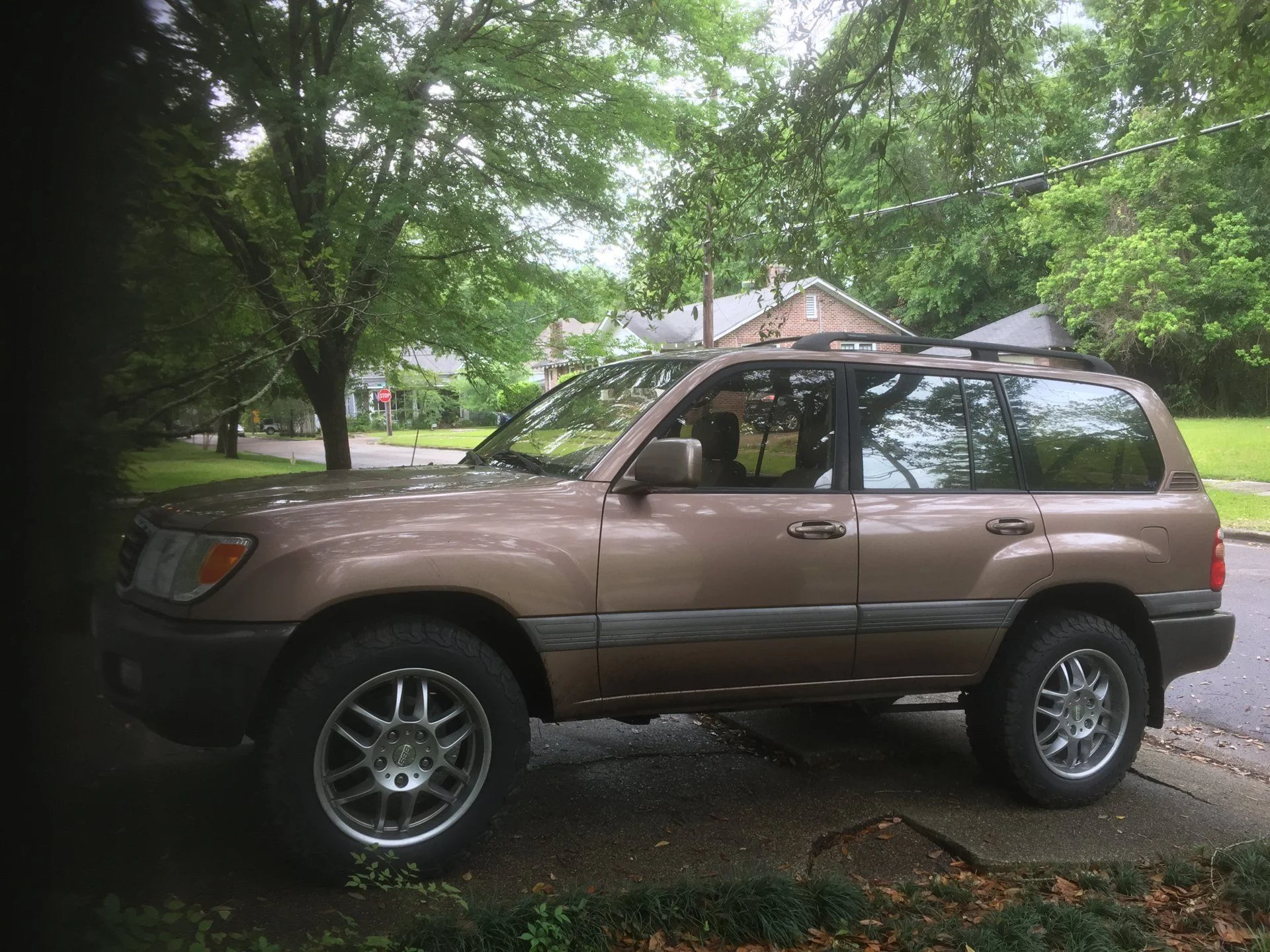

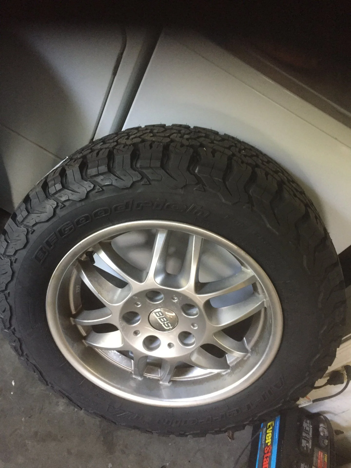

Little before and after. Stock suspension, 8 turns ds and 7 turns ps torsion bars. 275/60r20 K02. You do have to run a spacer to fit this wheel. Went with 1.25" spacer.. would be perfect if i was running fender flairs. Sticks out just a little.
I have those same 20" BBS wheels. Getting my powder coated Gloss Black right now.
