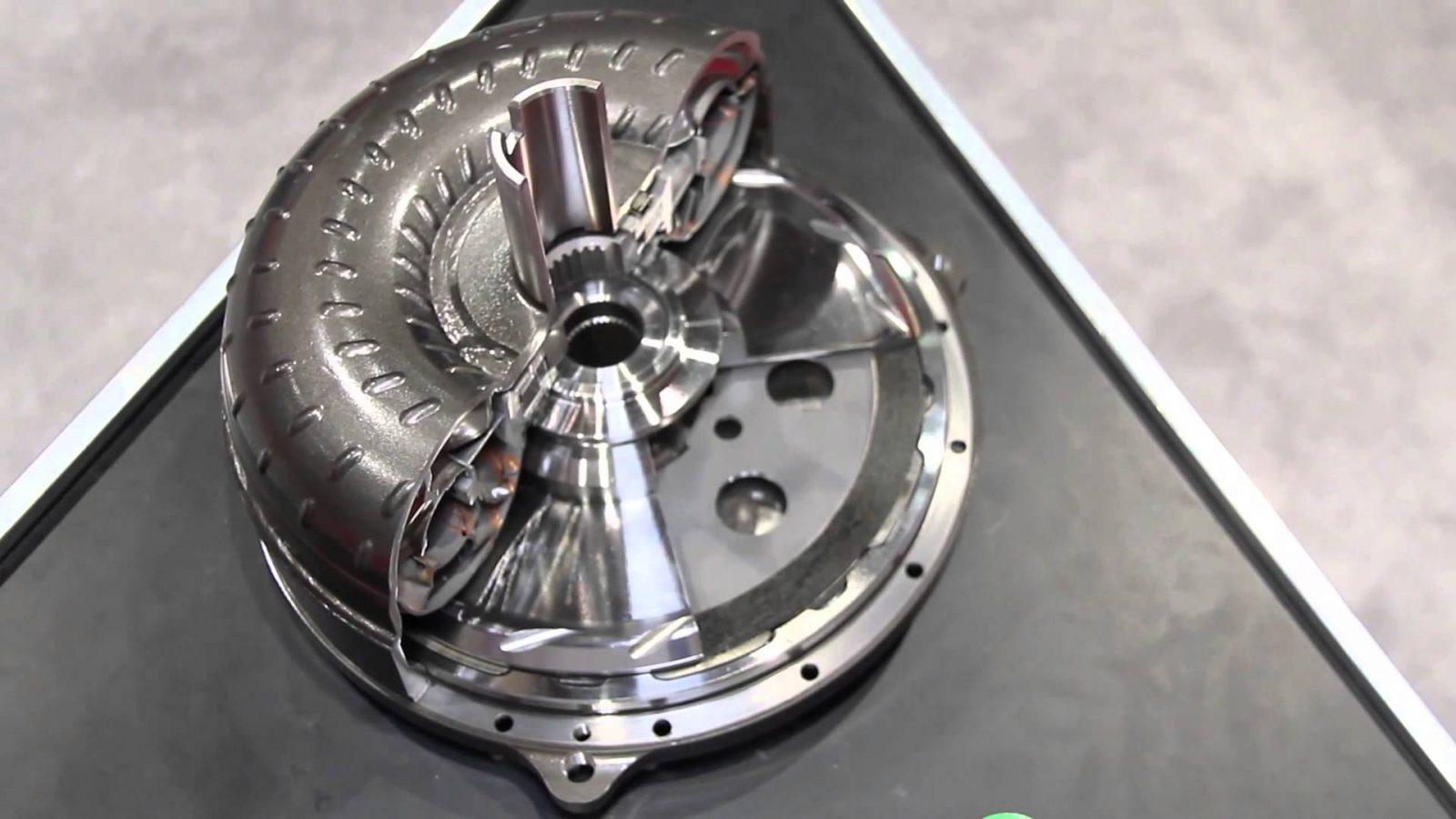

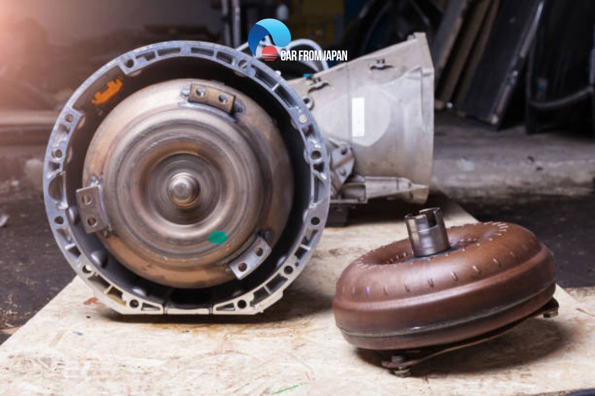

The torque converter is a large radial pump. I am going to radically simplify its function to attempt to explain how it works. It looks like a pair of fans, one fan drives the other. (Go ahead and set up of a pair of fans in your living room to see the effect) When the moving side fan (engine side) pushes trans-fluid into the static side fan (transmission with vehicle stopped) force is applied. As engine RPM is increase the force applied becomes large enough to move the vehicle. As you can imagine there is slippage, after-all its two fans that are not traveling at exactly the same RPM, the driven fan lags behind. When it lags it creates heat in the fluid.
To minimize the heat build up, there is a clutch that engages and couples (locks) the driven fan to the driving fan as the driven fan approaches the speed of the driving fan. It disengages when you slow down to stop so that the torque converter fans can have slippage so the vehicle can stop.
If this clutch that is supposed to lock the two fans together doesn't lock up, there will be excess heat created in the shearing of the fluid. It is non serviceable other than to change the torque converter.
Here is an excellent article on the subject.
This lock up only occures above a cirtain speed, I will need to consult my FSM for the information, but my guess is you never got moving fast enough to engage the torque converter lock. Hence the high transmission temp.
