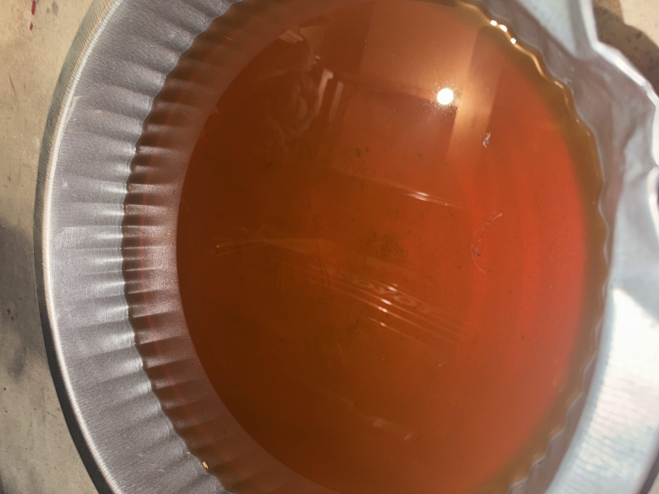

By the way this is what my coolant looks like after 3 months. I drained it to swap the fan clutch because my rad hose is in the way. Looks pretty bad
I was hoping that the dirt just comes in from my broken reservoir cap but that seems wishful

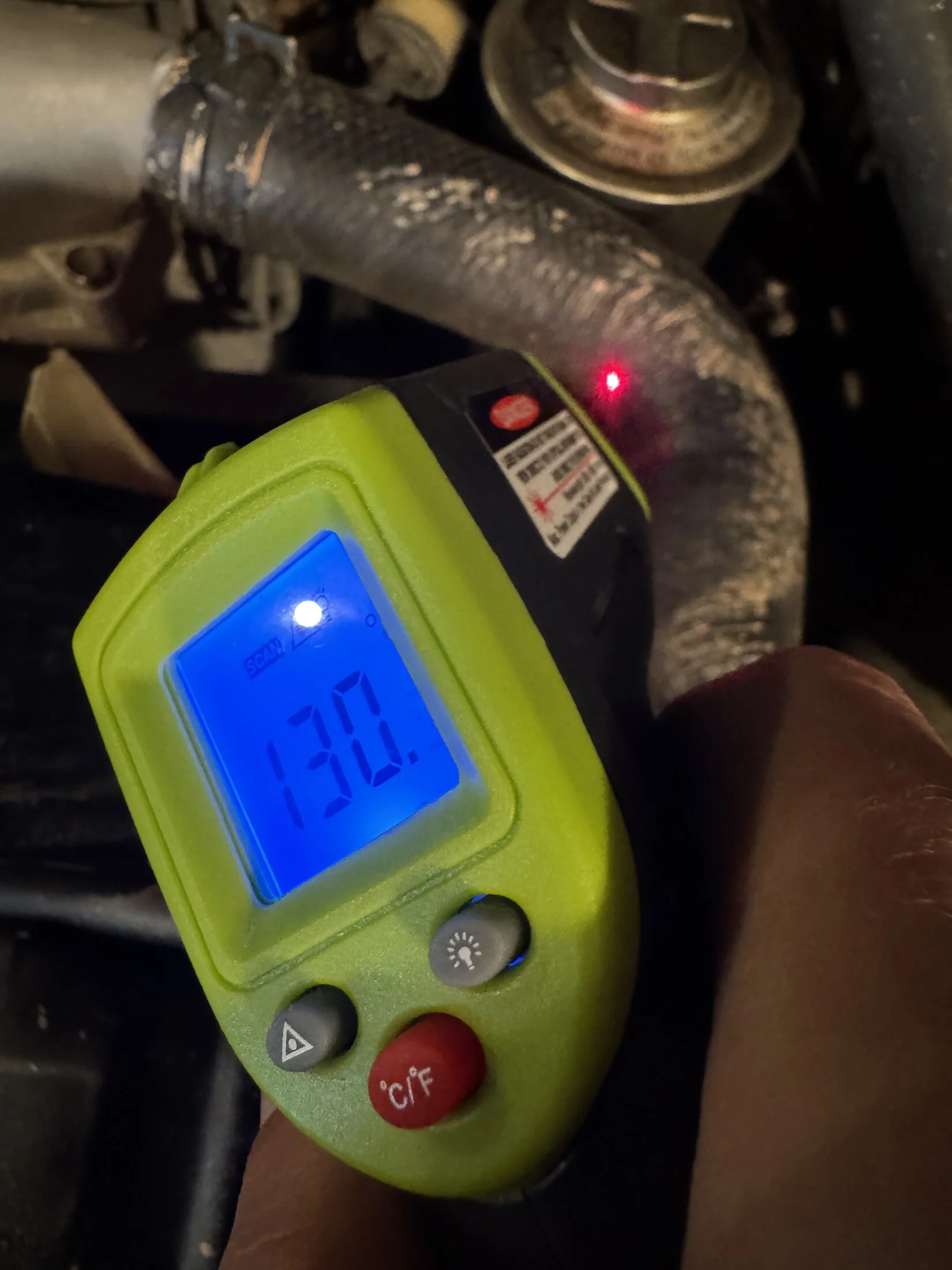

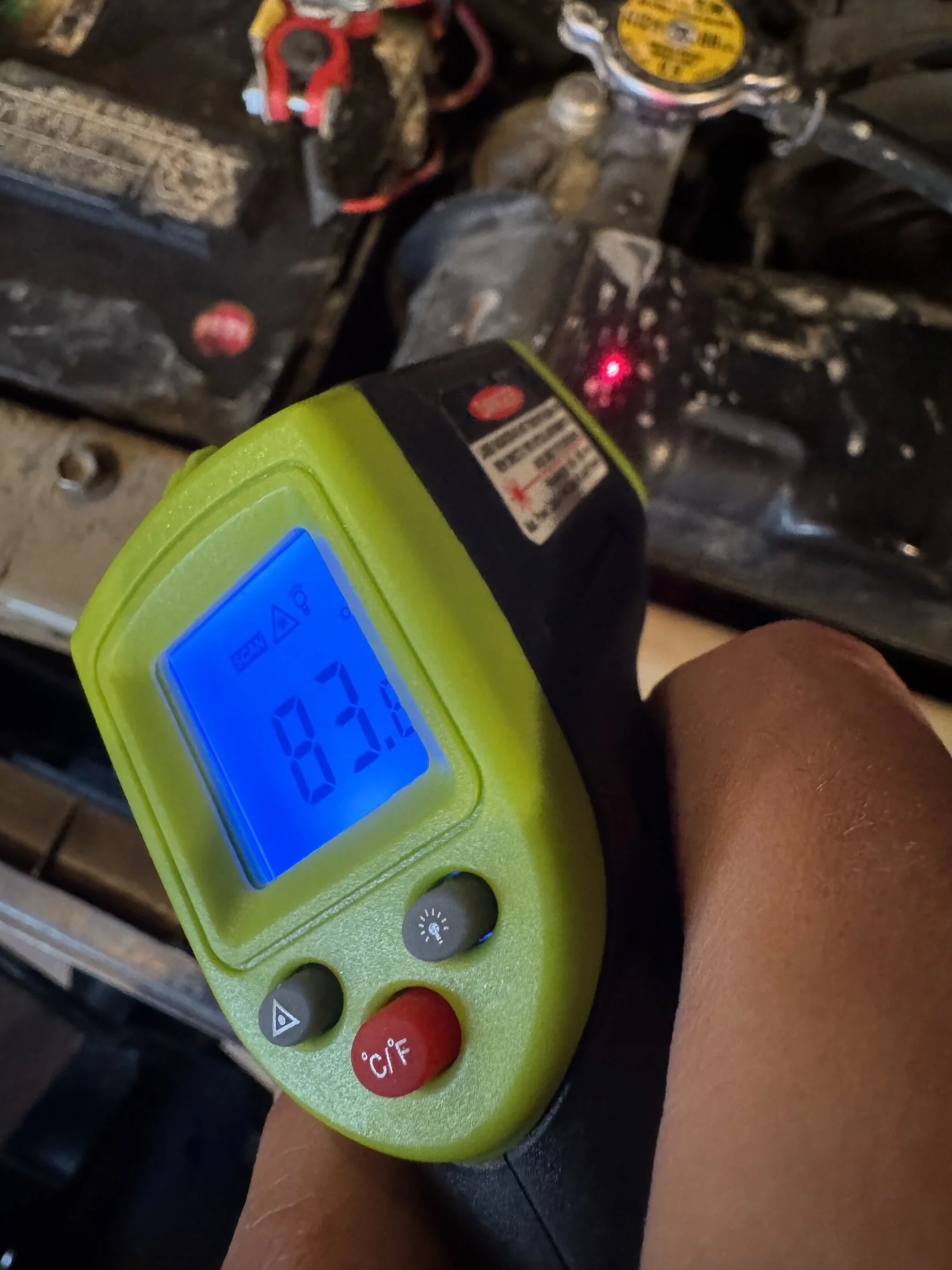

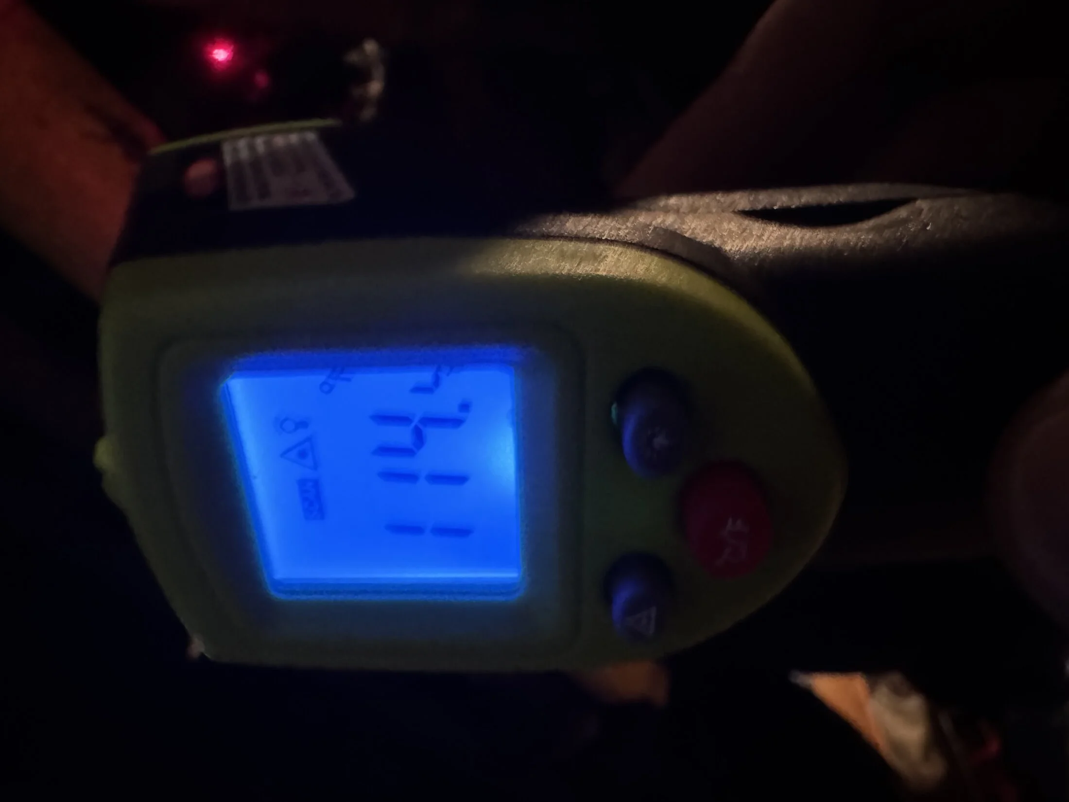

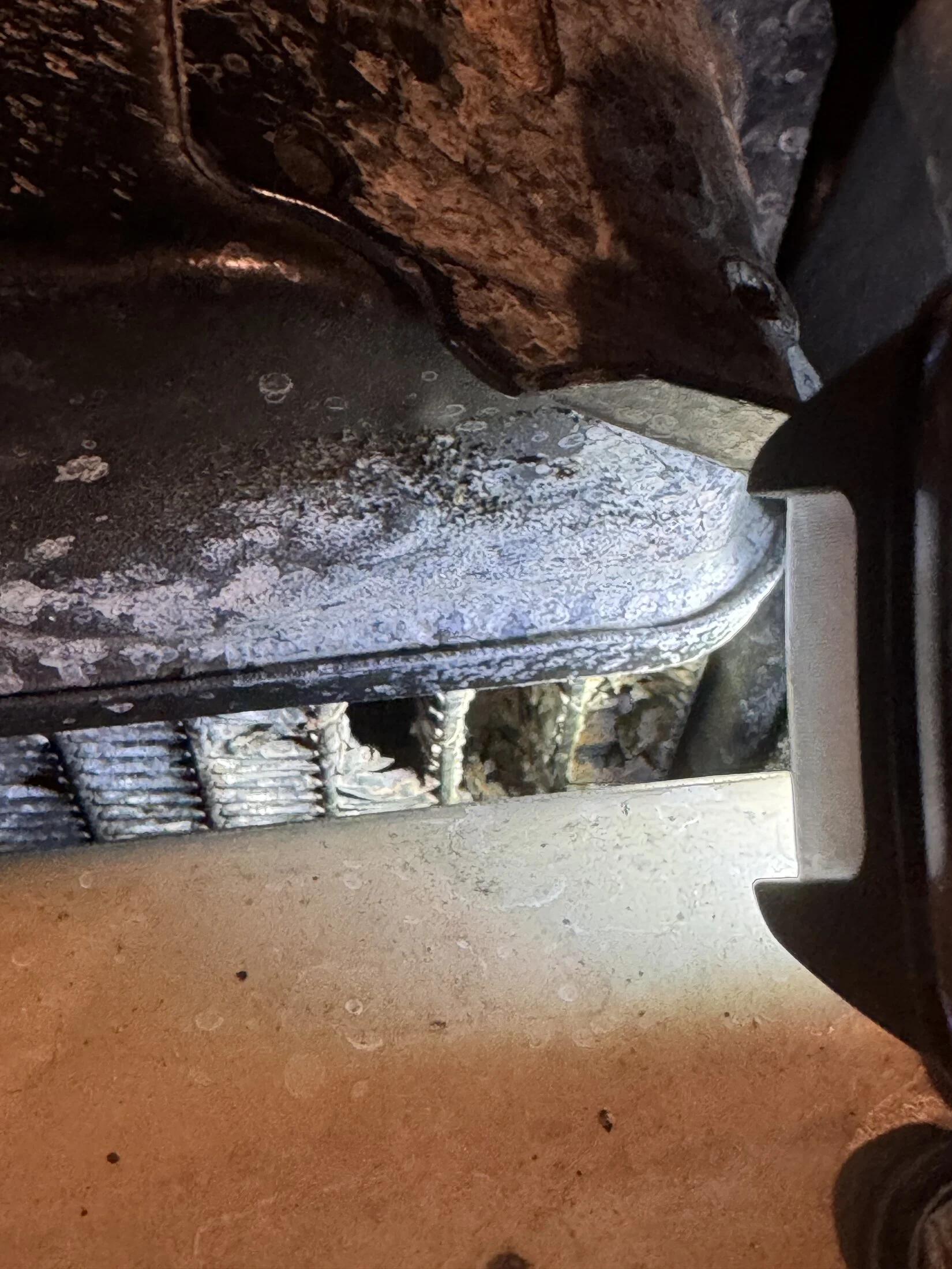

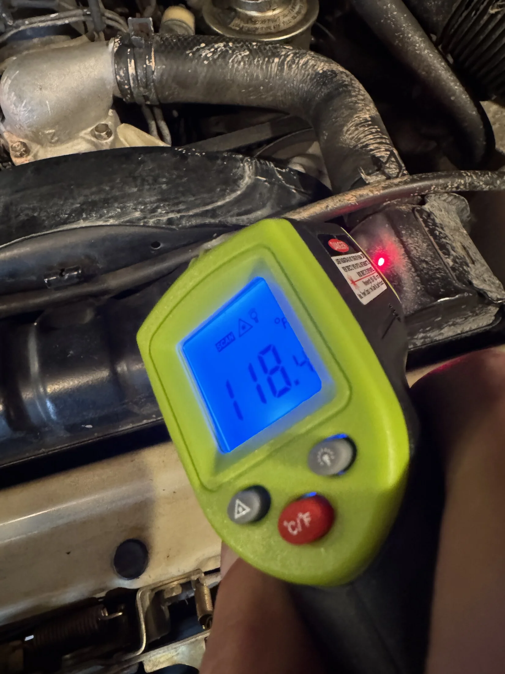

Update: Im starting to suspect the radiator is the issue. I idled the engine for 15mins and took some measurements of temps around the radiator. The temp gauge was 3/4 to the top and the bolt holding the thermometer wire was 145 degrees F.
The radiator fins and fan clutch bimetallic coil were only warm! I'm thinking my radiator might be clogged because the right side (facing the engine from the grill) is much hotter than the left side and theres a nasty impact area on the top right (just noticed)
Here's my temp readings (right=drivers side)
Top rail radiator: Right=111F,Left=81F
Fins:
Top right=118,Top left=85
Bottom right=116
Bottom left=90
Center fins in front of fan clutch=103
thermostat housing=150
Here's whats interesting though- both upper and lower rad hose are 105 degrees.
So maybe the radiator is clogged or bruised and only passes coolant through the right side. My other theory is the water pump may have something wrong with it because I'm not able to feel the "pressure surge" when squeezing the top hose with engine running.
Here's some not so useful pictures (ignore the splash of coolant everywhere I was checking the level to burp the system and it had pressure in it so when I turned her on the fan sprayed It everywhere)
Top radiator rail:
Upper and lower hoses
Edit: Eureka! This also might be happening because the radiator core isn't full of coolant from when I did the hydrocarbon test because I needed a few inches of air at the top. This could be causing the coolant to only flow from the right side where the hose supplies it down the tubes on the right before the left side gets any keeping that side of the radiator just full of air. I'll fill it all the way and burp it and try again.
Propped up front passenger side and burped her for a good half hour and temps stabilized across the fins. I drove up the mountain road (never got very hot but then again its snowing out) and at the pullout the fins were a good 170 degrees and the bimetallic coil was too hot to touch yet the fan wasn't engaging and with the engine off it spun freely. The heat sink around the fan clutch was a good 140 degrees (cant point the temp gun directly at the coil). Glad my radiator isn't the issue. Upper rad hose 140 lower hose 110.

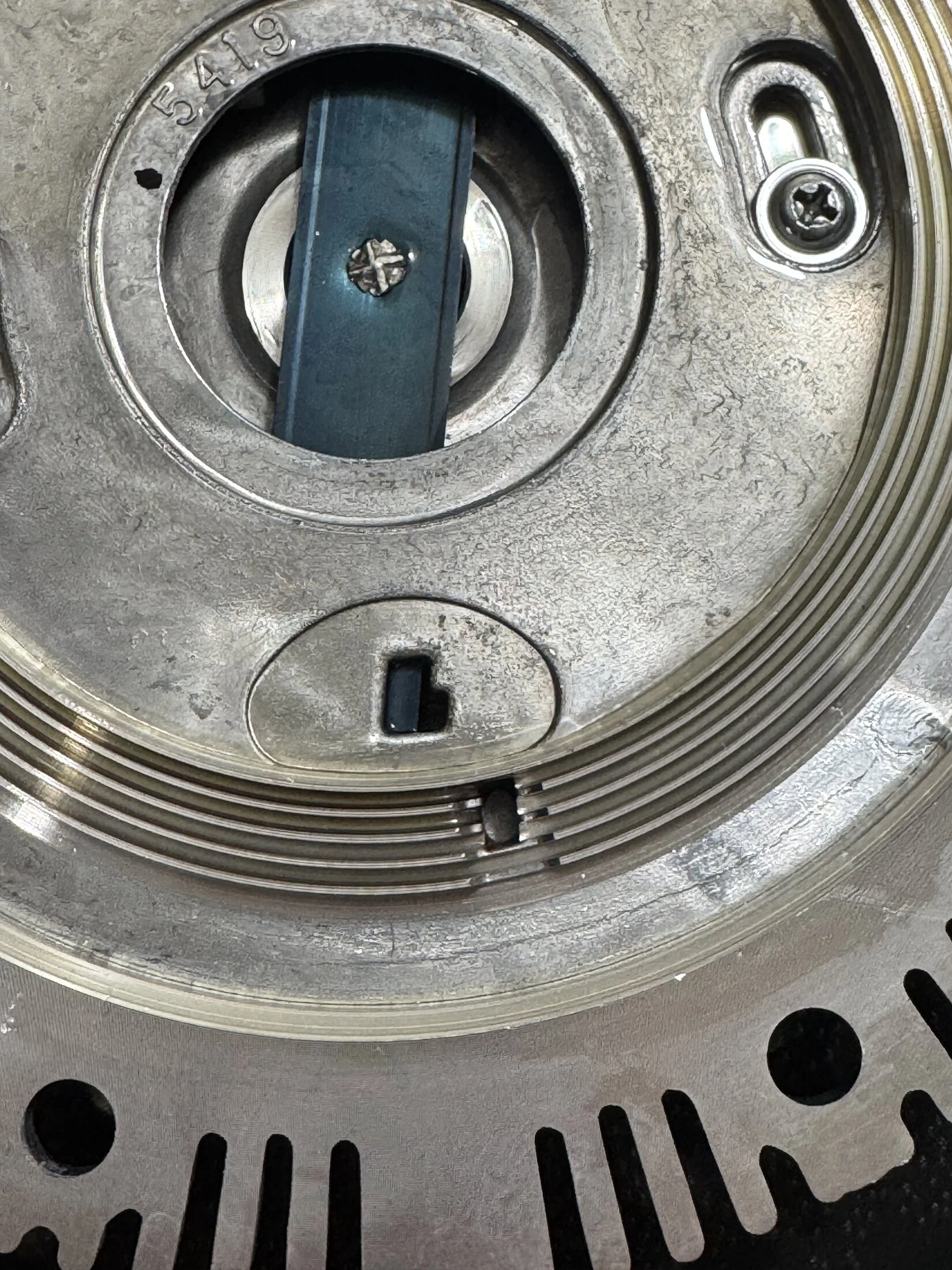

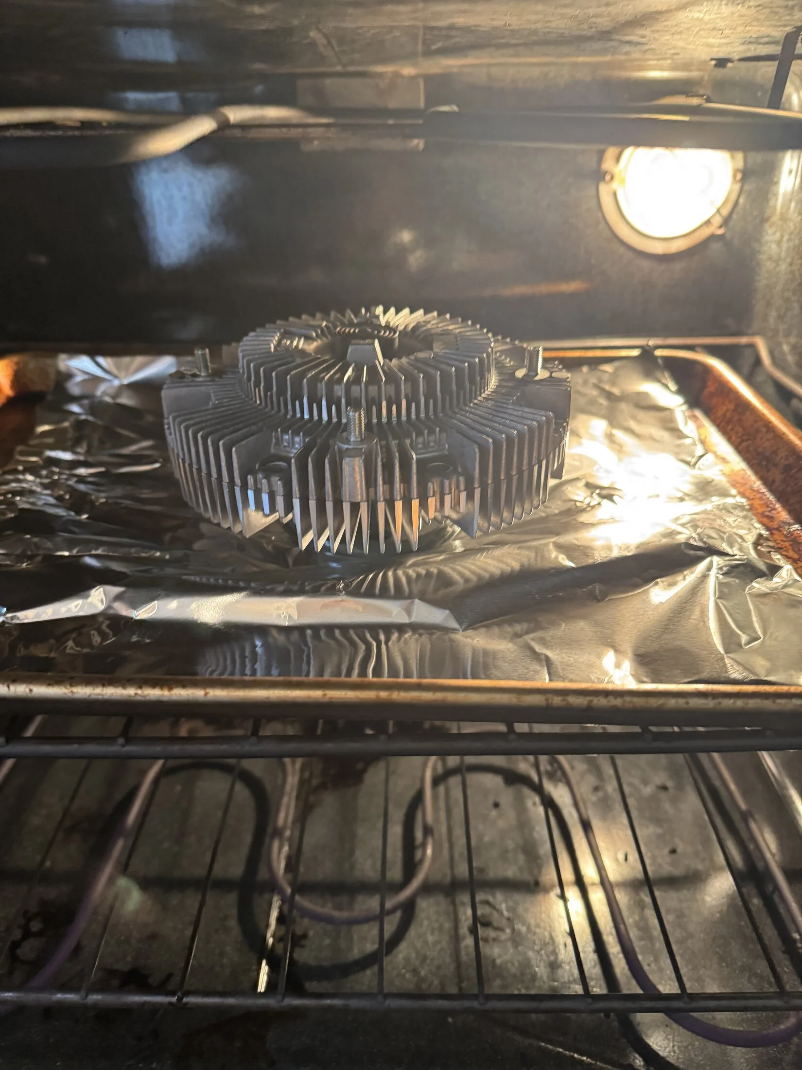

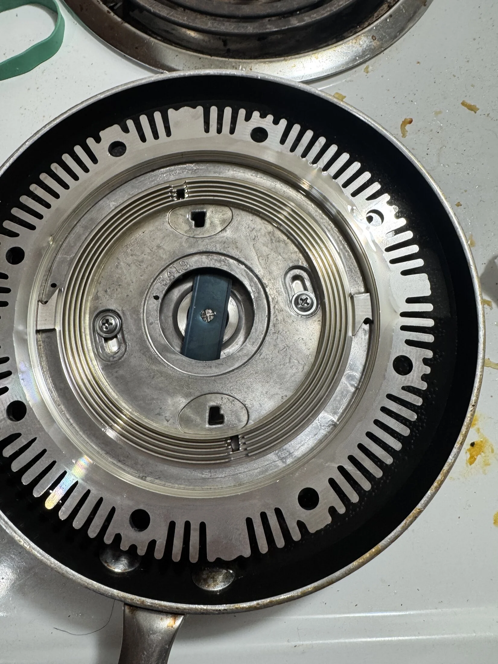

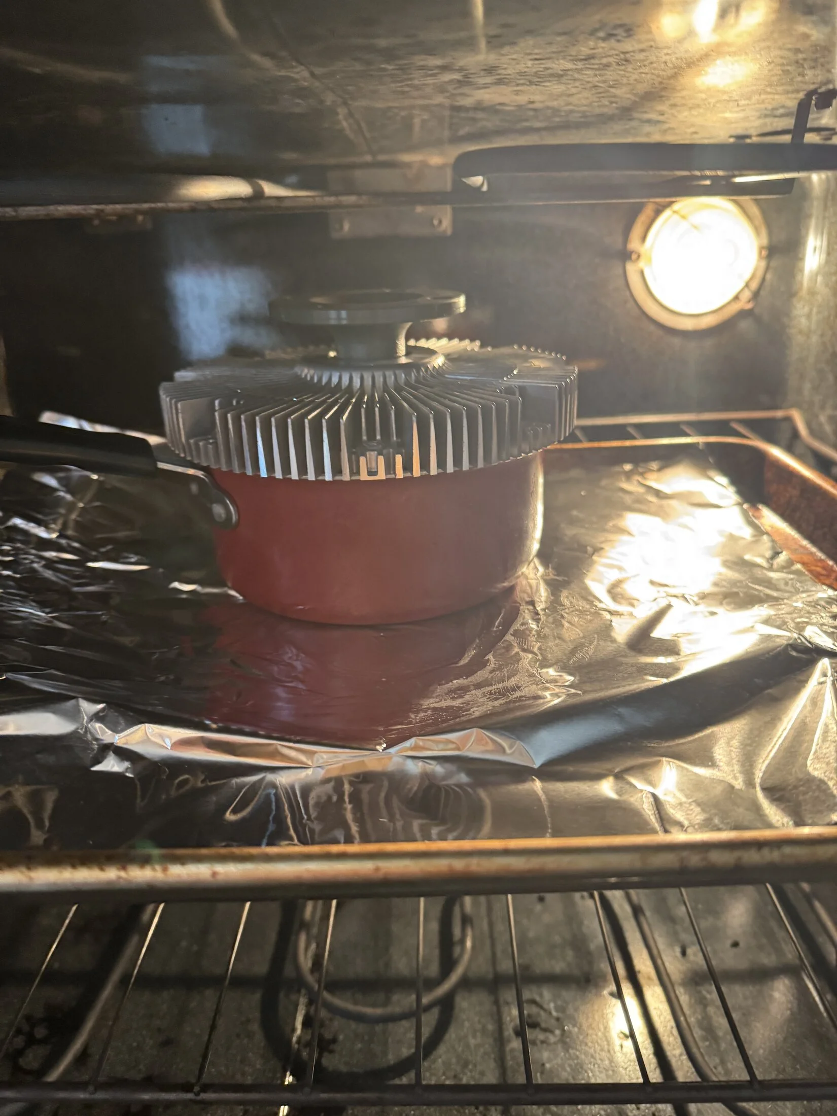

Finally resolved the issue! First blue clutch wouldn't work despite adjustments so had to wait for replacement.
I got her warmed up in the oven to drain to the water pump side so when I disconnected it the coil side was dry
Then I drained the other side in the oven while I made the adjustments on the stove up top
Put it in a small sauce pan on a cloth to keep the coil from directly touching the pan and slowly heated up- picture shows hole completely open after getting it too hot without opening much and adjusting the plate.
Initially the plate was set to stay closed until the inside of the fan clutch was around 140 degrees (coil was hotter) but after adjusting it as far as it would go I can confirm when the bimetallic coil gets around 100* the hole opens half way- good enough for me.
It's freezing and snowing outside so I had to take it on a 40 minute drive up the mountains but right when I began to lose hope she kicked in and stayed on. What a relief. My cruiser has now had 5 fan clutches :D
