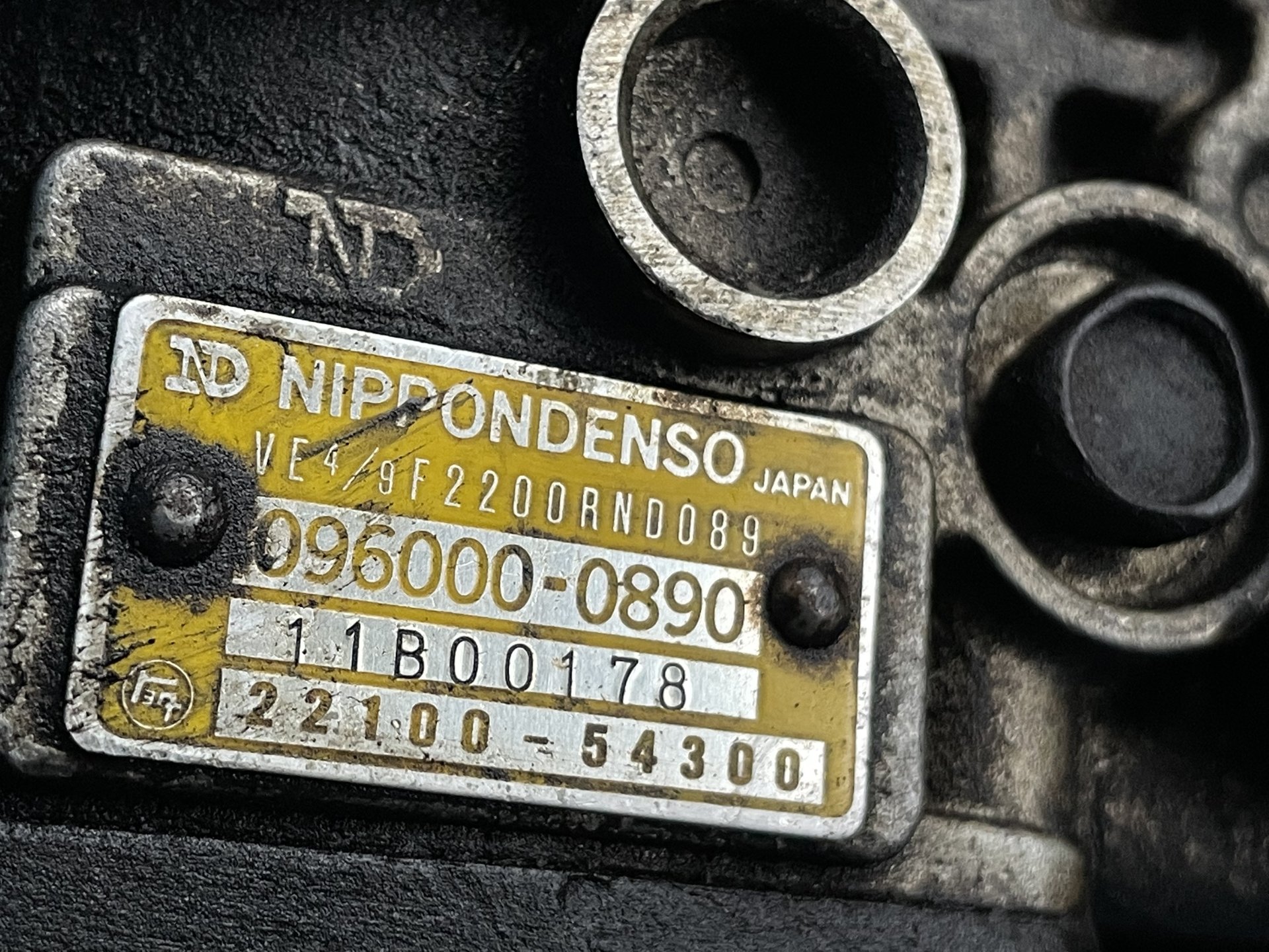

What does the ve part number on side of injection pump say? The proper pressure is part of the number.
Image attached...
2200. So your injectors are perfect.
Thanks for replying, but I am hoping you could maybe elaborate? My injectors are currently setup at around 135 kg/cm2 (~1920psi). You are saying this is the correct setup? 2200 is the max that this pump can put out? Any idea about benefits of higher or lower opening pressures?

Interesting. The thing is that the part number(22100 - 54300) matches what is specified for 1983. For laters years the second number goes up considerably.
FYI 2200 on the pump name plate does not mean 2200psi. VE pumps never state the pump pressures on the name plate. For your VE4/9F2200RND089 it actually means;
VE - distributor type injection pump
4 - 4 cylinder
9 - 9mm plunger diameter
F - mechanical governor
2200 - pump governor RPM, keep in mind this is pump RPM not engine RPM. So actual engine speed is twice the pump speed so 4400RPM
R - clockwise pump rotation
The remaining ND089, is just the production/serial numbers used by manufacturers.
Oops, thanks for schooling me. My bad. Not sure how I mixed that up. :oops: Best to go by the fsm then.
4 - 4 cylinder
Thanks. I had found a weird page that mentioned something along these lines, but was uncertain of how accurate it was. I am thinking I will have them reset the injectors down to the top of the FSM specs and see how that goes.
