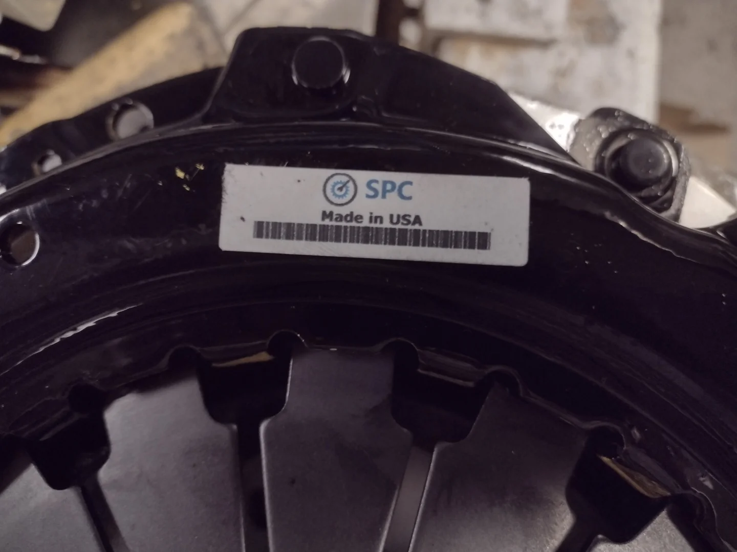

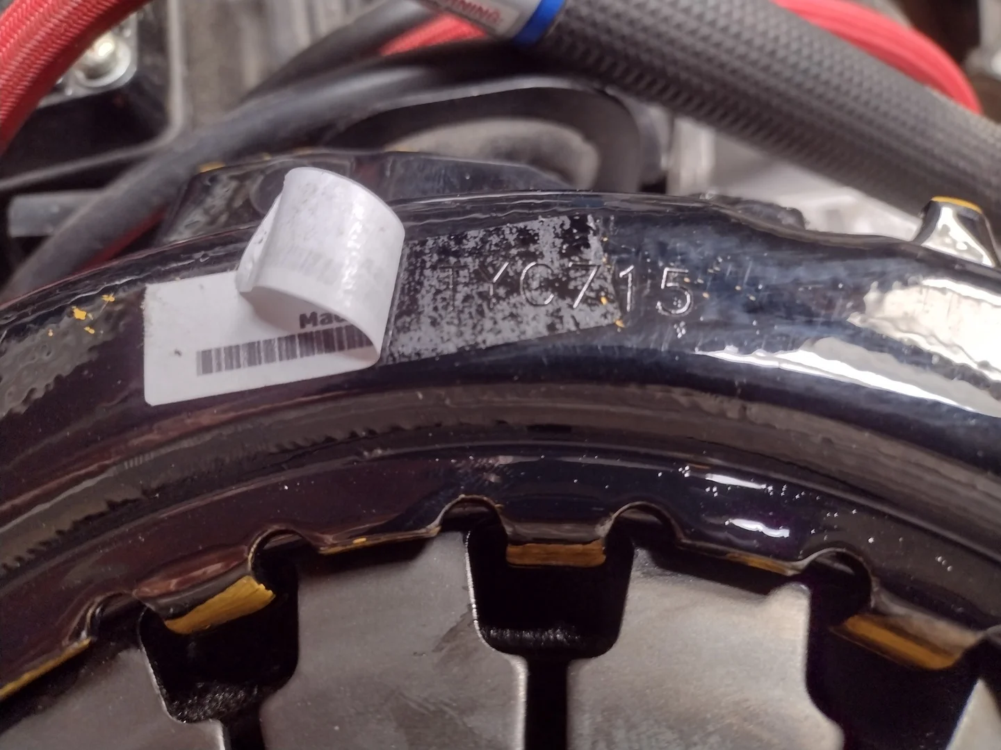

Now a big, fat warning for anyone thinking about ClutchXperts SPC or CXP clutch parts on amazon and ebay. They are selling clutch parts for a Supra, which are 9.25" for the 5VZFE, 9.75" application. See thread below what they are pawning off. I'm in a dialog with a 'Head Manager' by the name of Jason S. after they shipped me the wrong pressure plate, they are now saying I must have a different engine, and I'm dealing with a swap, and Jason is assurring me this is for the 5VZFE. Well, I have a ruler and pictures which I will post below. If you are getting a pressure plate and disc from them, it will fit once you drill the locator pin holes, but you will have 20-30% less clutch surface will actually make contact with the flywheel. It's funny that Rock Auto, Exedy, Kupp, FX, ClutchMax and everyone else show the 5VZFE as a 9.75- 9.84 (250mm) clutch disc, but not ClutchXperts. I applied a little heat to the sticker to peel it back a bit and this is a Exedy TCY715 pressure plate that they have applied a ton of yellow, then black paint on. Now their communication has been excellent, let's just hope they can admit someone screwed up. I'll update as I learn more.

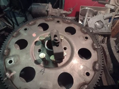

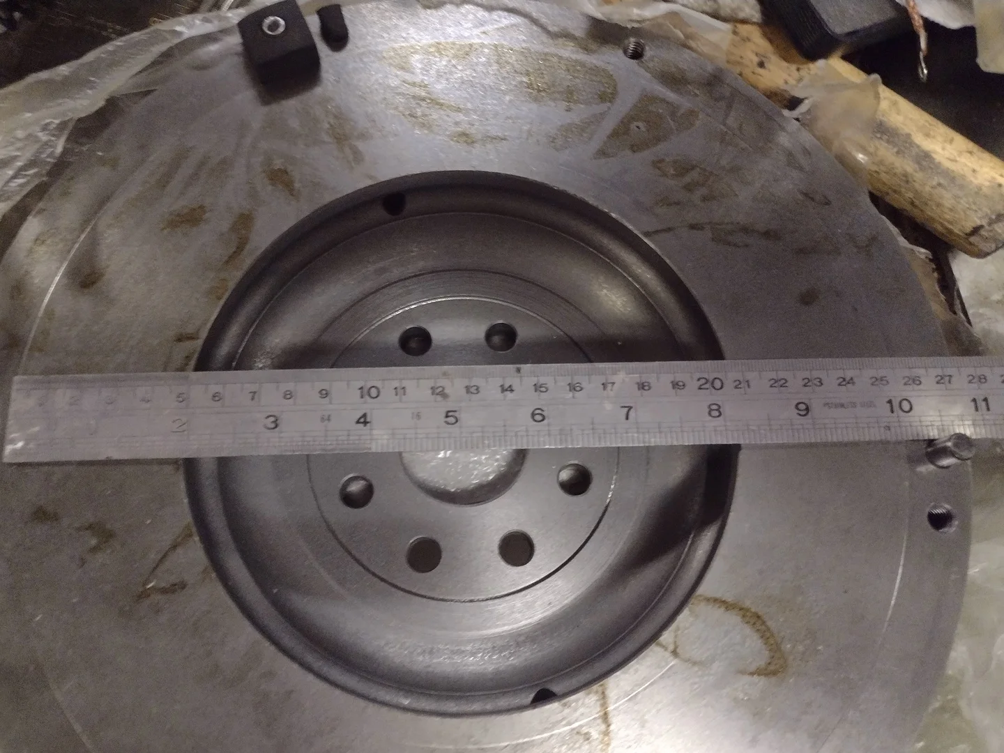

First, the flywheel.
So far,three two possibilities.
The 2005-2015 Tacoma 4.0L V6, which has a 10.75" disc, same as the Land Cruiser. I'm trying to get a used one from the local clutch shop to see fitment. This is ideal, because this engine had the bolt-on factory supercharger and puts out close to the 3UZ. The ring gear will need to be R&R, but it looks like the ring mount surface might be the same as the 3.4L. Way the heck too big. The ring gear leaves about 0.100" if it were turned down to fit. Big disappointment, that.

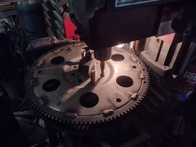

The 2004 Tundra 3.4L V6 5VZFE. This one works with only the hole egg operation! The catch is the original automatic ring gear plate is retained and this flywheel slides on in front of it. This gives you both the original spacing for the starter AND gives you close to 10" clutch disk diameter, since these took 9.75" discs.
The total crankshaft bolt dept: 22mm crank surface to bolt bottom out. Spacer plus flex plate measured with dial caliper: 29mm. Clutch thickness ~12mm. So ignoring the flex plate and spacer, say they are 34mm, or 1.33 (1.25-1.375). M10x1.25.
Part numbers:
Perfection Clutch 50-135 (from Rock Auto, the one I confirmed fit with), $41
LUK LFW199 $57.79 (Rock Auto Price)
Brute Power FW9135 Autozone $86
Pioneer FW-322 Autozone $152
Sachs NFW6939 Autozone $86
This larger flywheel opens up more options. I no longer need to modify the 350Z clutch disk, there is more plate area and I need all I can get.
While we are here, the flex plate is 3210150010 for the 3UZ. Looks like the same number for the 2UZ.
There are three considerations, the gear pitch, the outer diameter, and the distance from the crankshaft.

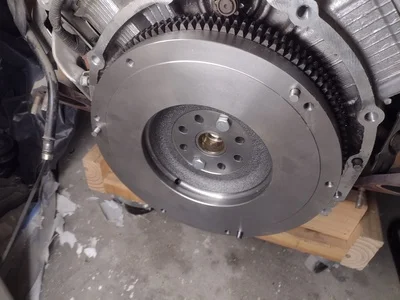

I bought one from Oddesy fab: 1UZ 2UZ 3UZ Manual Transmission Flywheel
It was $275 delivered to my door. I also bought a flywheel off rock auto for $50, the LUK LFW196, from a 1990 Toyota 4Runner 3.0L.
I am 99% sure Odessy just milled this flywheel (which is what I was already planning on doing before this came). The inner diameter is a perfect fit on on the crank.
The hole diameter is about .062 interference fit hence needing to egg the bolt holes which I will do with a 27/64 end mill. I don't know why it is not metric, but this endmill is a perfect fit.
Other suppliers of this flywheeel are
XAT OEM Style 1UZ V8 Flywheel (per Effjay76), and UZ to CD/JK Swap Components.
the latter I bought the bell housing adapter from to convert to the CD00A. They claim their flywheels are machined from billet, and I believe them. Their adapter is very nice. I don't know if the flywheel will fit a H55F application.

SPC-XT56035TTNDHP5-CC - Stage 5 with only 2100lbs Clamp? 389HP, 359lb-ft from SPC, whoever they are, $80 to my door. THIS DOES NOT FIT! See above and below.

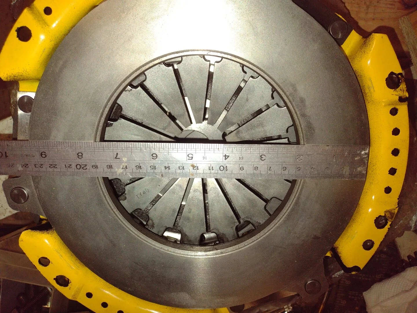

The pressure plate(MR2):
I figure I need (1820/224)*320 = 2600 for the 2UZ application (stock MR2 1820@224 vs x@320), so according to the chart below, ACT extreme would be needed for a 2UZ.
I can confirm that the M_PACT 98725 pressure plate fits the LUK FW196 flywheel, which I bought so I have something to play with.
I also called M-PACT, and they did not have info on the 98725, but said typically it's 25% more than needed by the application.
They did say their 98725-HD is 2200 lbs.
I've found other forums who say stock is 1820 per ACT.
