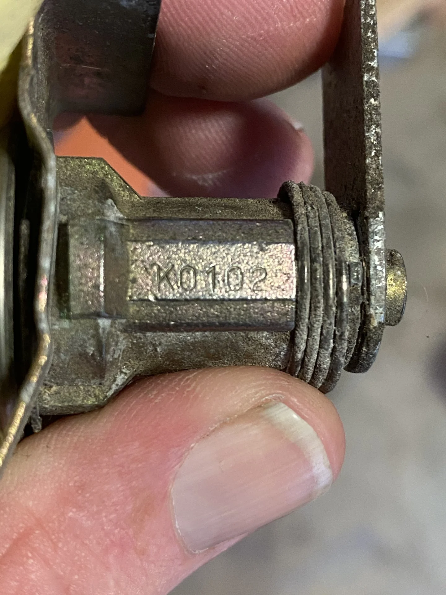

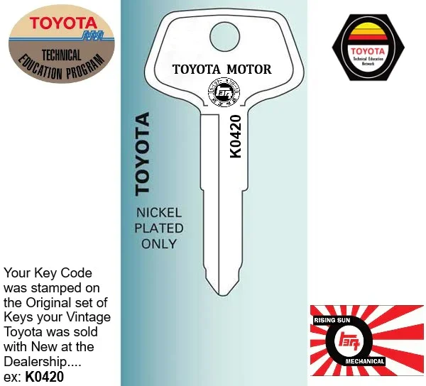

- Options now exist , that have NOT in the past for the entire 1997-Older 70 series community Globally .........
- globally speaking , that is ..
- i can and do factory SST machine cut to the Factory KEY code any land Cruiser owner operator provides me a photo of , that code factory stamped , on a passenger side lock cylinder , OEM little CHROME KEY tag thingy , or stamped on a factory KEY itself ...
- i DO NOT look up key codes via ANY frame # or VIN # , so please do not ask ,
- the below example TECH. images are from my understanding ALL 1997 - OLDER 70 SERIES ,
- my NipponDenso SST Hard Drive is up to date for ALL Global key keys codes , globally :)

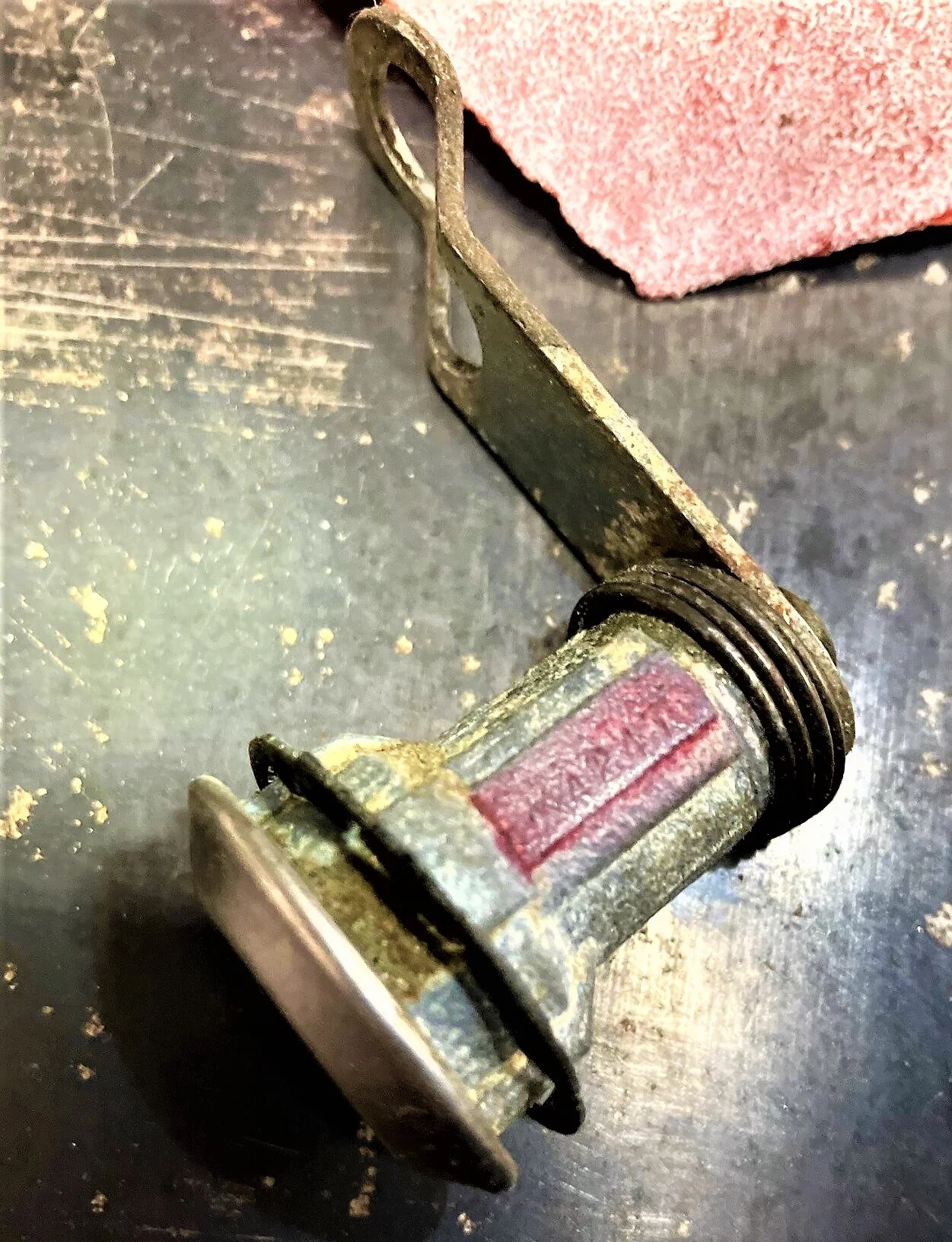

- passenger side lock cylinder like below :
- i do not store or record key codes , so write it down please
- THIS IS THE WAY

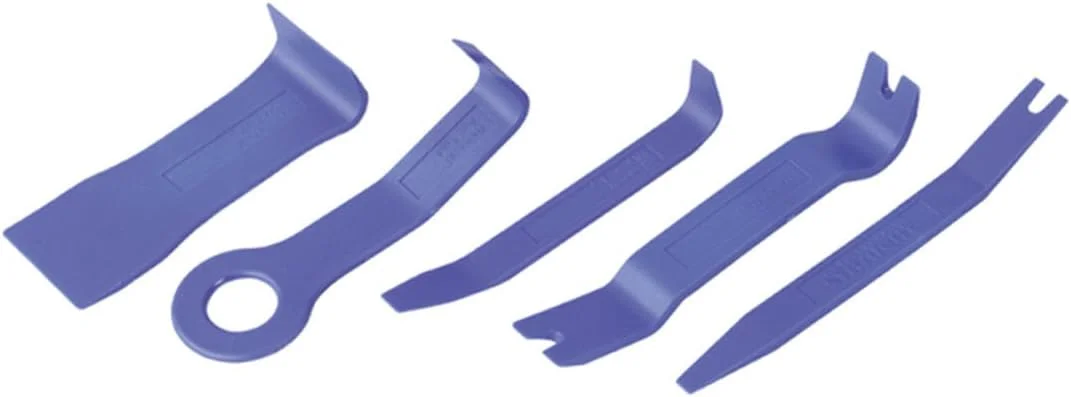

you will need to go to harbor freight or NAPA and get a simple BODY clips spoons and door card popper Gismos kit ...
- THIS is EXACLTY what you need
OTC is the TOYOTA SST Maker
all plastic non-marring
THIS IS THE WAY !
Amazon product ASIN B000I28MKU
