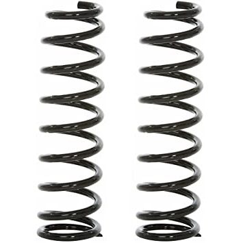

Now that I think of it, you can kind of check. Factory springs are black with either pink, white or purple paint dots on them. Each spring should have one dot that's a different color than the opposite spring's dot
edit:
A quick Google search says US spec LCs have bands on them, mine were dots
My Old Man Emu coils have tags/labels on them, I believe. Something else to check for.

Just got under it and it’ll look around and there is an OME 63 tag on one of them. So it looks like they’re old man emu but I’m not sure what the 63 is in reference to. Does this refer to the height and if so, are there some springs that they make that are a little shorter?
just buy OEM if youd like stock height
The springs arent typically shorter or longer, they are just rated for different weights. A high weight limit will lead to more height if you dont have that much weight added.
That being said, even with OEM your LC will sit a bit higher because it doesnt have 3rd row seats
That 63 should be a reference to "863" an OME coil spring. Info here.
