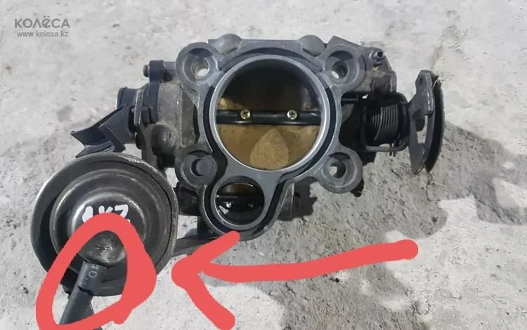

After taking videos and looking around at what’s happening during shutoff, there’s a little clunk sound. It happens right as this like black piece spins I think?? I’ll show a photo, it’s the part circled. Is that possible the butterfly valve?
You could pull it off and have a look.
