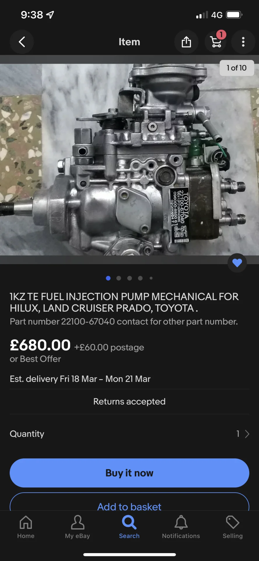

you have a toyota part # for this pump ?
i might be able top help
I need one of them
@tomjohnson123 PM me I can get you a fully rebuilt 4M40 looks like new mech pump, running one myself.
