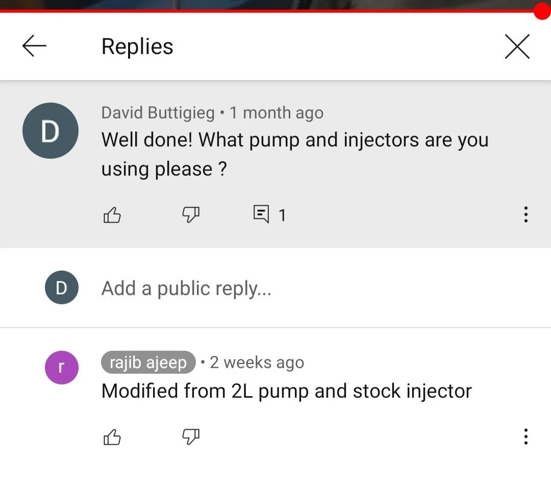

Got some interesting info about the manual pump conversion... So when we were discussing this last time, I had found that video that I posted earlier and I asked him what pump and injectors he used. I just checked now if he replied and...
