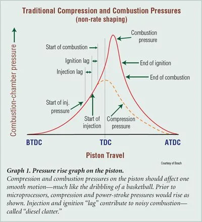

Yeah your diesel will always use the smallest amount of fuel needed to move the vehicle. Matching gears more to your peak torque can have a good affect on fuel economy. Larger plungers can also have a bennifical affect as it can shorten the injection stroke and deliver the same amount of fuel faster. This can alow for slightly less timing and give you cylinder pressure where it can be more useful for the eninge instead of a long injection stroke that begins to build pressure long before TDC creating higher peak cylinder pressures, but not making more power for the engine. This also stresses the engine out alot as well. Here is a pic.

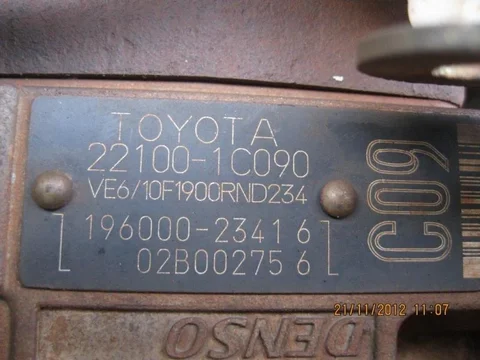

Limit of 11mm pumps are baed a lot around who builds them. Std 1HZ pumps are all 10mm pumps - easy to tell from part number on pump.
The 200hp @ wheels was an 11mm upgrade. They are good for ~ 230whp, possibly 250. The 12mm are good for over 330. 14mm custom heads from the USA are apparently not great and a lot has been done with them here. Just not been able to make a nice running engine and keep pump reliable.

I was told this about the later 1HZ pumps but have not found it to be true - the number on side of pump tells the story. I can't remember the numbering system but there should be a 10/11/12 number near a 6 (for 6 cyl).
DI pumps have a different timing curve - not what you need with a 1HZ
All 1HDT/FT pumps are 12mm
