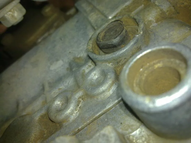

The older pumps (pre 98)have a threaded recess where the pick up fits in.
Lets see if I can rustle up a pic ... mmm here it comes.
I dont think the housing will be any different even with the newer ones. They use another method for obtaining a signal but the mounting spot would still be in the casting process
Thats it with the wires coming out. It costs about $200 AUD in oz. Unreliable little fawkers:mad:
EDIT I just went and checked my spare pump and the pickup has a 21mm hex that you may able to undo while the pump stays in place.
The stealership were telling the truth for a change:D

hi everyone...i am running in to a problem...i have the tach in my meter cluster, but as u see the image of my pump...there is no connector or even a hole to insert the pick up connector.....any ideas??
Thanx
Thanx
I can't see your pump. What model and year are we talking about? Is the pump on\off the engine?
its a 1994VX limited 6cyl inline 1HZ...]
Its an 80 series? Do you know if the pump is the original for this engine? I seem to recall that some bare bones models had no tacho.
Also the later model pumps,98 on,have a different way of getting the tach signal. So Im wondering if someone has put another pump on the engine from a later model,or maybe your whole engine is a transplant.
HI roscoFH73...and thanx for the reply ..very sorry for my late return...anywayz....here in Sudan we literally build the older models due to the cost of customs...so i guess with 5 previous owners....one of them would have changed it....im still doing bits here and there...but its running,,,got all the combination meter running except the rpm....would appreciate if u could help....learning plenty from this site, but still a newbie (rookie)...thanx again
What i have found in the aussie 80s with the barn doors,they didnt have a tacko, and they dont have a hole in the pump housing for the pickup

The housing of the pump is a generis denso part. You can order one with a tach hole.
The other possibility is to drill and tap the flat surface on your pump. But you need a tach sensor first to figure out the thread. Everything else is there.
