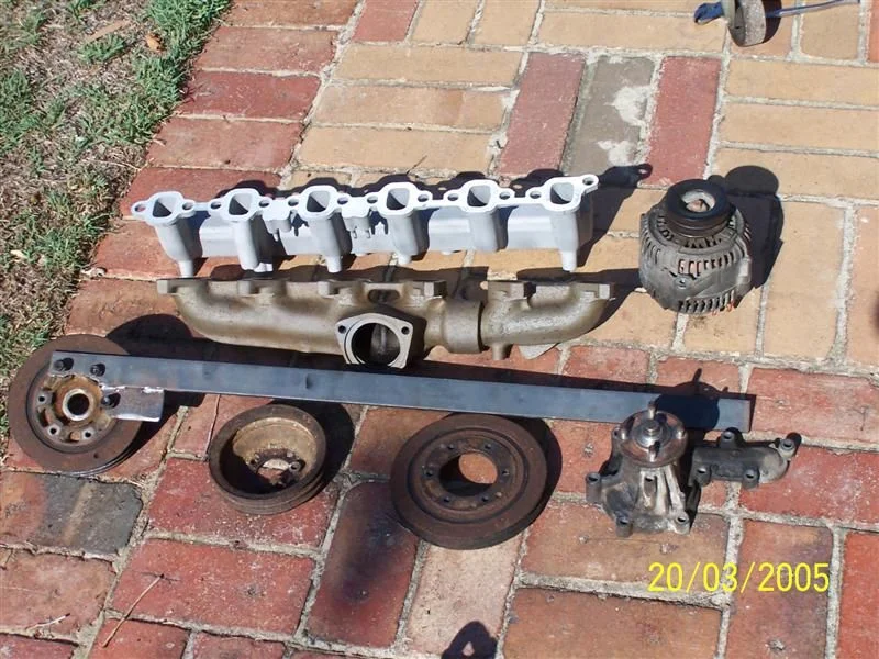

I was a little worried that my engine was packing it in, I had a hollow knocking sound for the last couple of days and when I started it this morning it was making a nasty bearing/grinding sound. So, I spent most of the day taking the oil pan off, valve cover off, timing cover off, looking around, trying to see and hear where the problem was coming from - turns out it was the pully behind the harmonic balancer that the alt and AC belts are driven by.
The pully is not just a solid piece of steel, there is a steel part that the crank bolt goes through - then a rubber band, then the stell grooved part that the belts ride on. I guess the rubber section is used as a damper for loads. As it turns out the outer steel section delaminated from the rubber and was just slipping around on there.
229 bucks from ENS and I should be on the road tomorrow.
I'll post pics tomorrow when I get it off so you can see how it is put together.
I had tried the starter method earlier today and broke 2 breaker bars, I'll build the spanner tool tomorrow.
Thanks guys!
Make the spanner a bit stiffer than mine as mine is a bit flexi

All done, didnt need an impact gun - did it all without taking the rad out. Used a big homemade spanner and a 4 foot breaker bar, thread locker - it is very tight now.
