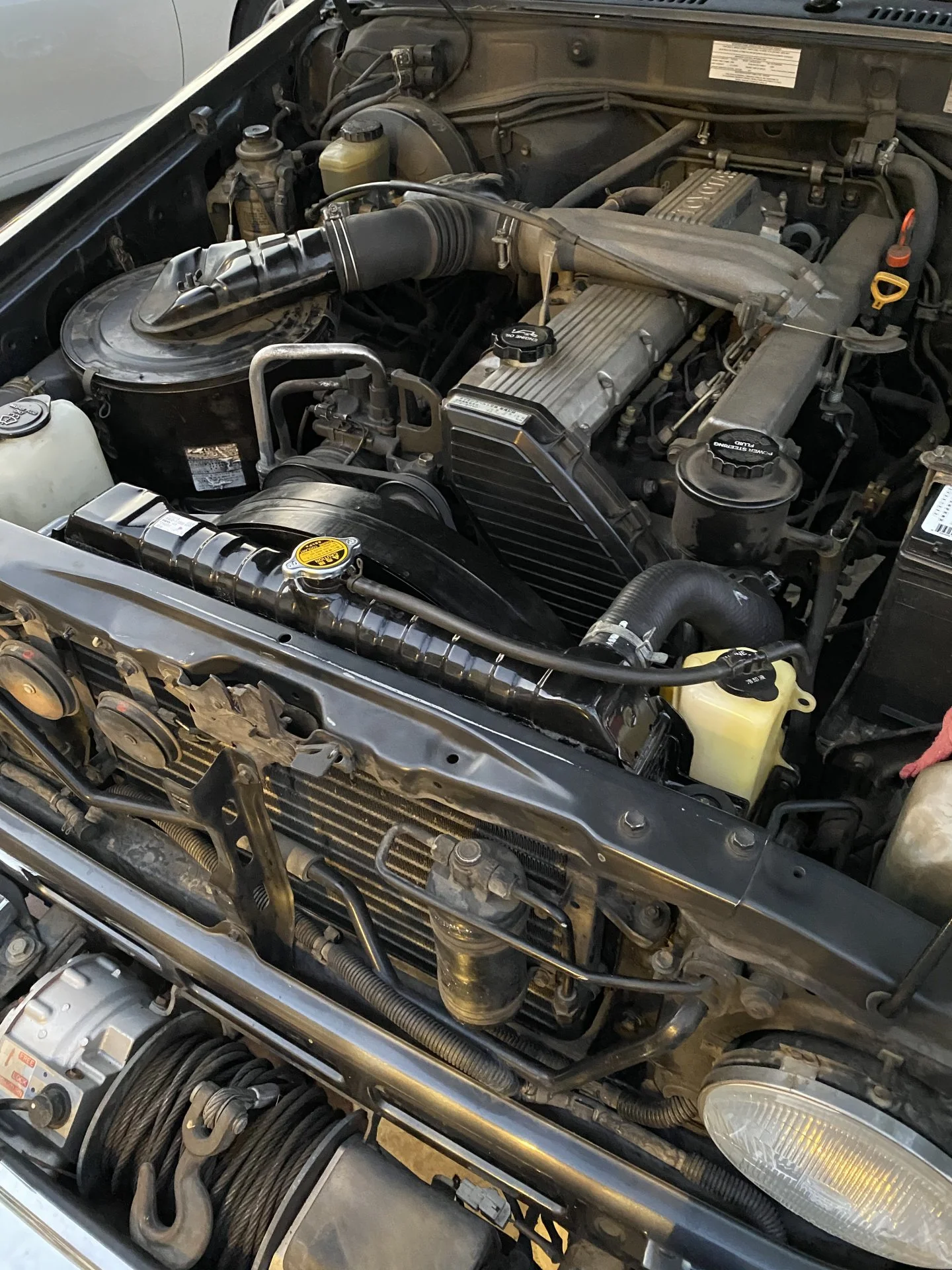

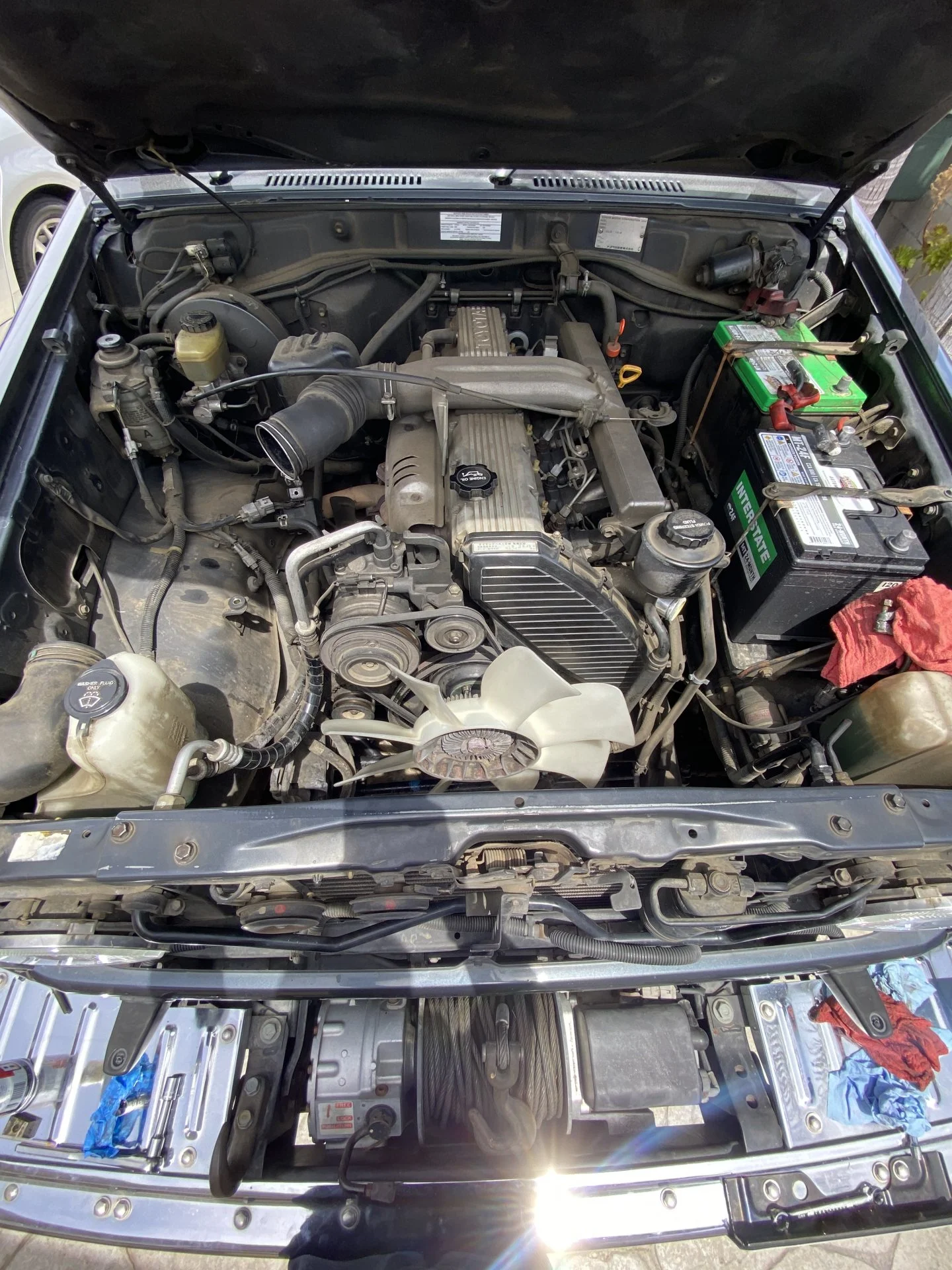

So I noticed that my coolant overflow tank was boiling after i went up an extremely steep hill, temp gauge was slightly below the red, do you think this can be due to a cracked head gasket, other causes or is this normal? Also pretty sure my radiator has a tiny leak since i noticed dried up coolant in between radiator and shroud and splashed onto timing belt cover, not sure if this can also be a cause. Thanks!

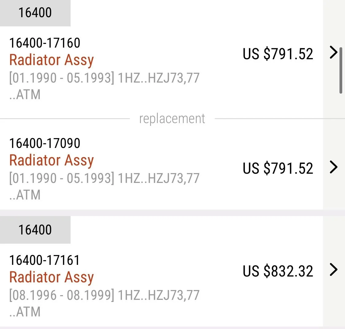

Hoping its nothing more than just the radiator system, I will get onto it asap, do any of you know the exact OEM part number for the 1HZ radiator, I got 2 different ones on megazip.net so I’m not 100% sure.
16400-17080 is the OEM PN for M/T 7x series with 1HX engines.
Available in US market from your local Toyota dealer.
Very nice T.Rad unit.
I had this number written down but wasn’t 100% sure because I got these as well from megazip.net
Yes it will do fine and it is the correct part number of you have a manual transmission. Correct and direct fit. You might need 16711-17011 though depending on the shroud you have in there now.
Shrouds are mated to radiators, design-wise.
Based on what’s happening, I’d highly recommend a cooling system overhaul at the same time— water pump, fan clutch, thermostat, all hoses. Don’t half-ass this.
My 1HZ is an automatic trans is the thing /:
Bummer. Radiator not available in US.
So, do the following: get Toyota radiator, buy an aftermarket trans cooler and install for trans cooler lines to transmission.
Slush box radiator is almost $1K from overseas.
