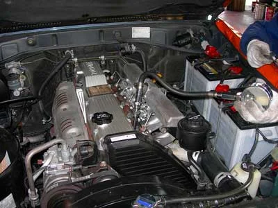

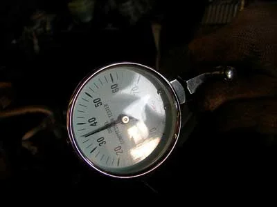

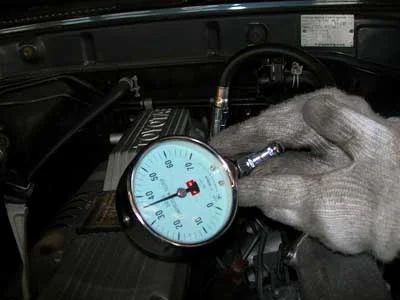

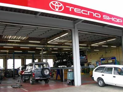

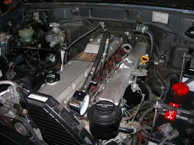

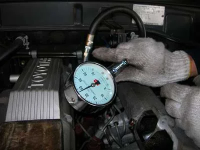

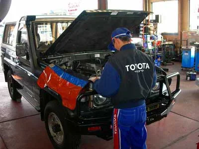

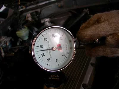

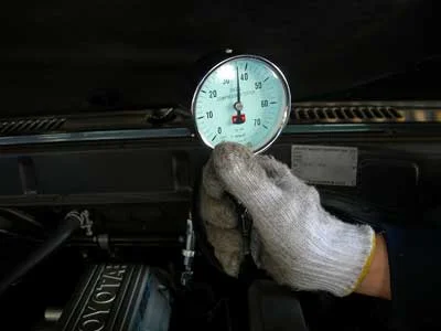

Kohei had the compression retested Friday at a Toyota shop in Japan. Here are the results - they're excellent:
1. 37kg/cm2
2. 36kg/cm2
3. 37kig/cm2
4. 36kg/cm2
5. 37kg/cm2
6. 37kg/cm2
Check the photos:
