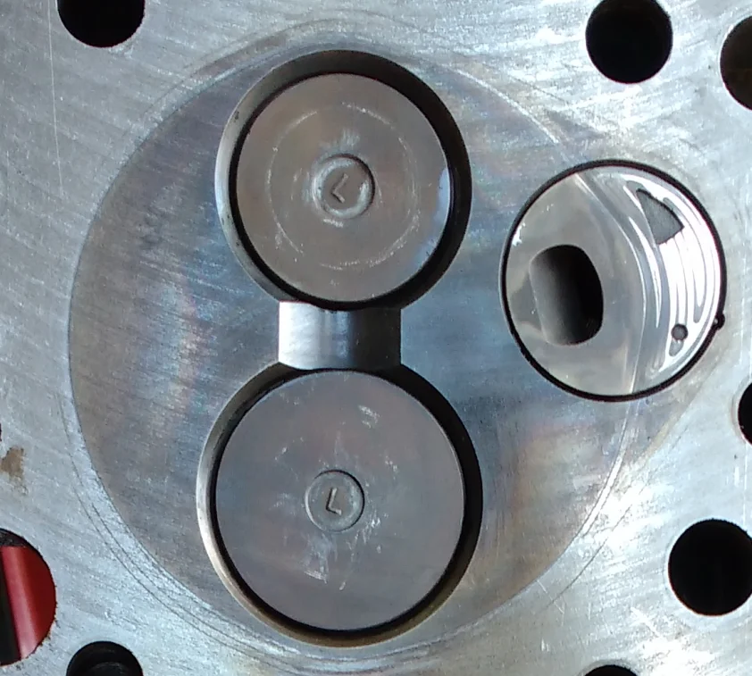

Here's a picture of a 1KZTE head that shows an 'L' intake valve:

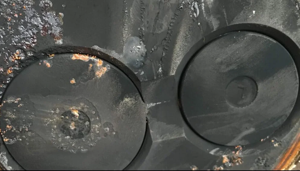

Here's a 1HZ engine with an 'L' exhaust valve:

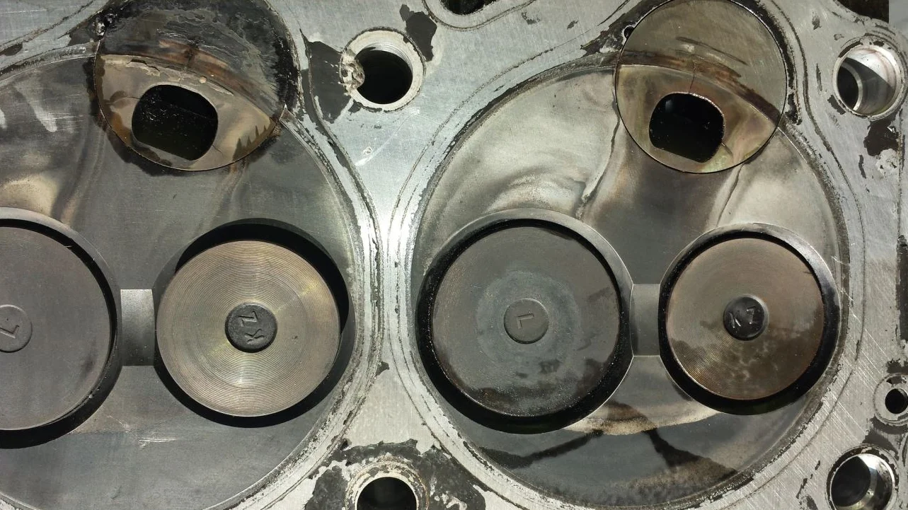

Here's a regular 2LTE (mine):

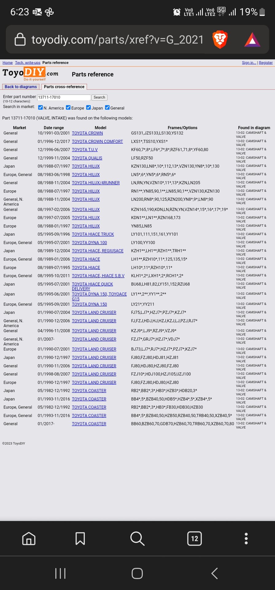

How are you cross referencing part numbers?

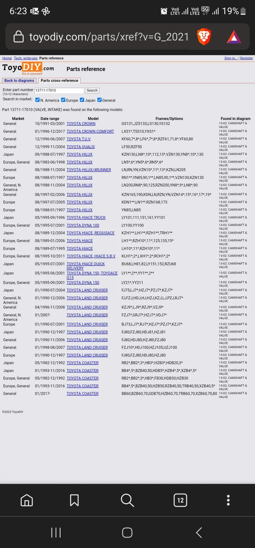

Toyodiy let's you cross reference part numbers pretty well
13711-17010 is currently used in 1VD-FTV in 79 series
I was just using Megazip, but ToyoDIY is better I think (I forgot about it). That's bloody unbelievable if that valve is used to the 1VD-FTV even.
I've found this with other parts too, like my 1990 LJ78 rear brake rotors (and associated parts) which were used in the Sequoia/4Runner/GX470 here in mid 2000s. I really like this about Toyota.

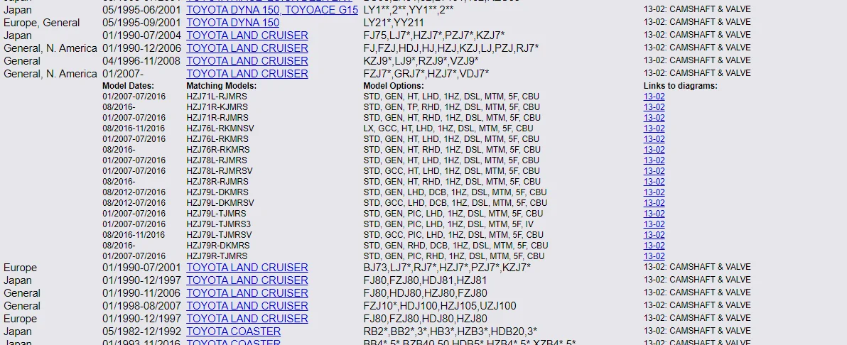

Yeah, I think Beno is right. You have to expand each vehicle series to see which engine the part is from. Like this. HZJ not VDJ.

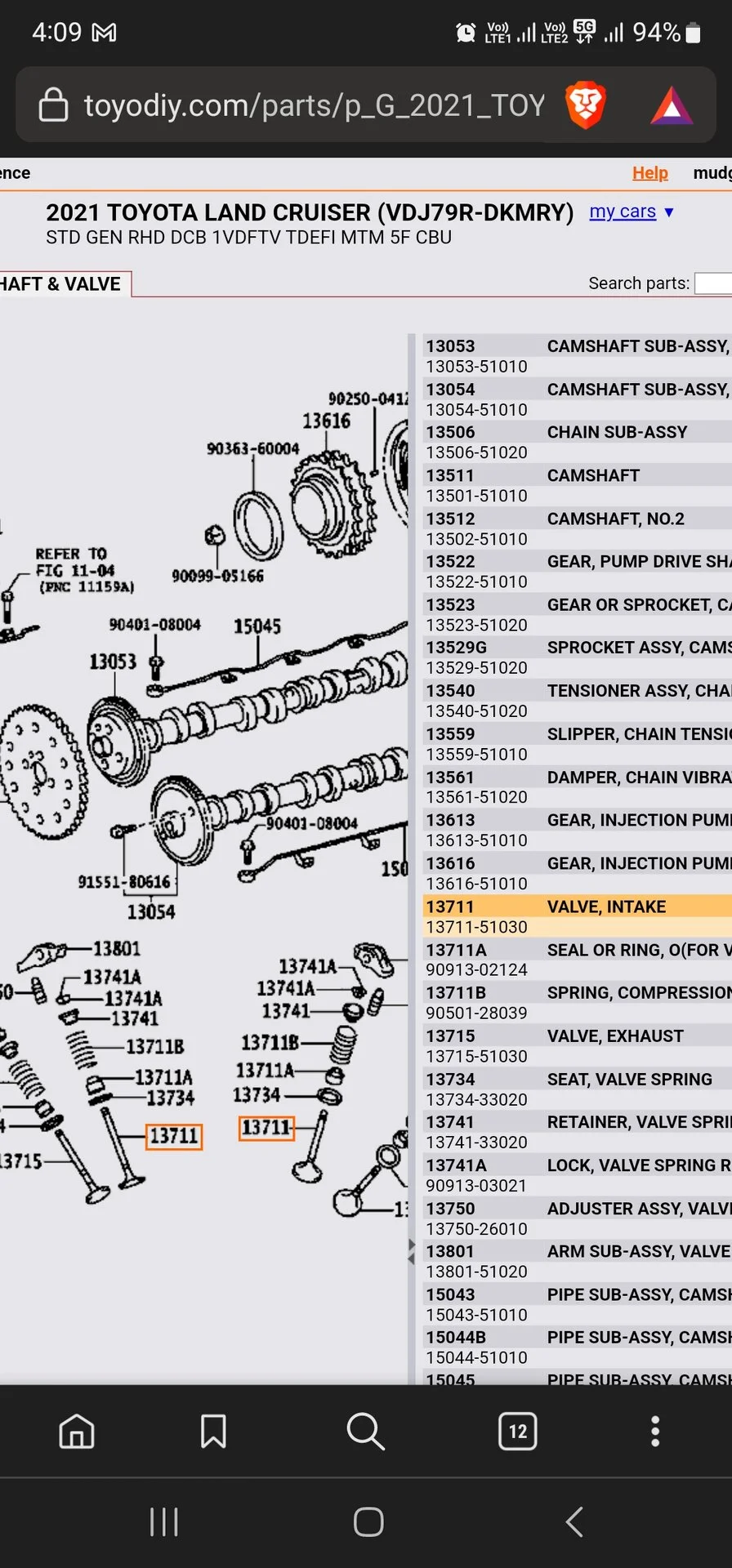

I had 79series page open when I plugged in that part number. It showed a hit
It showed the part diagram too, but it looks like the first five digits are the same, but the last five are not
