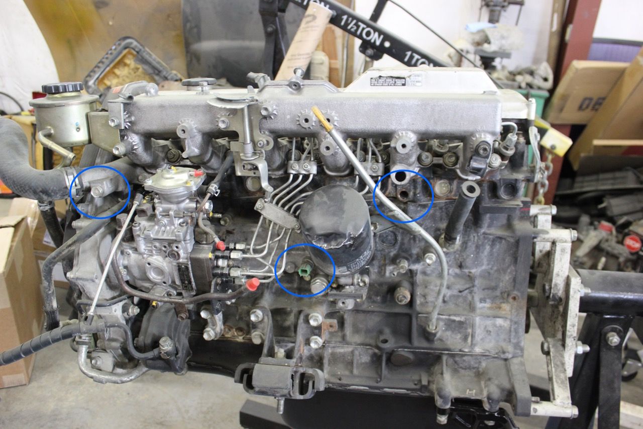

I found this pic of a 1HZ in another thread:
1hz temperature sensor location
From what I read over there the temp sensor in the single port outlet in this pic is for the aircon, the one below oil filter for the glow system and the one behind the dipstick is for the temp gauge. So there may still be another use for the dual port outlet??

I have a question. can i just use the 2 sensor on the right and plug my two cables to? I have a 1HZ water outlet in spare with the temp sensor hole but it doesnt have the coolant hose underneath like the 1HDT. and the 1HDT didnt come with the coolant sensor hole/thread.
